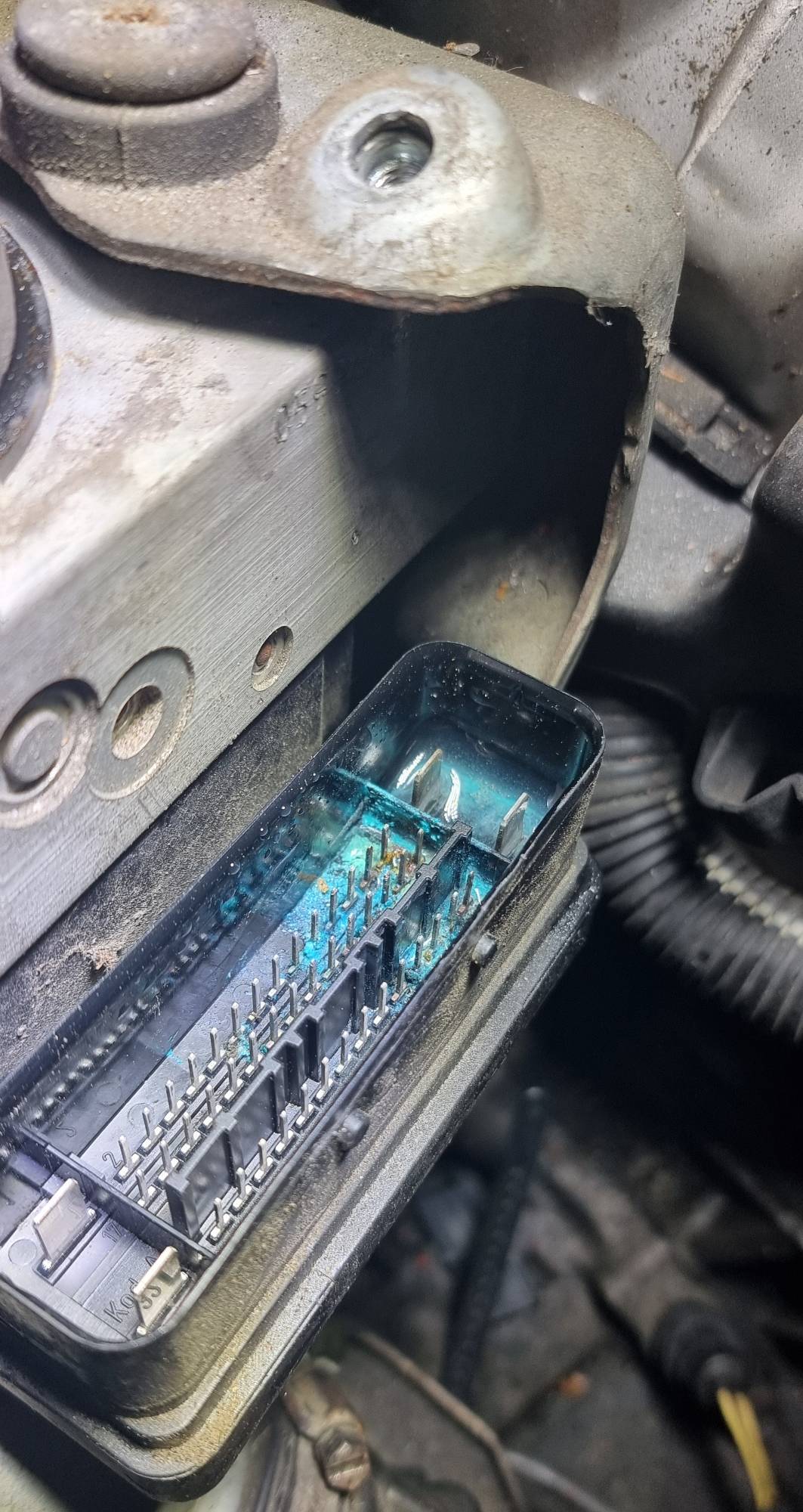

Finally I checked the BCM. All connectors in this car did look good, so I didnt really expect something bad on the BCM.
Well, thats the thing with cars without a clear history... some dipsh*t did very likely pressure wash the inside, flooding the BCM connector (its only splash resistant from the underside!). With below freezing, something finally broke in there. One of the pins on the BCM unit corroded and broke of. panic.

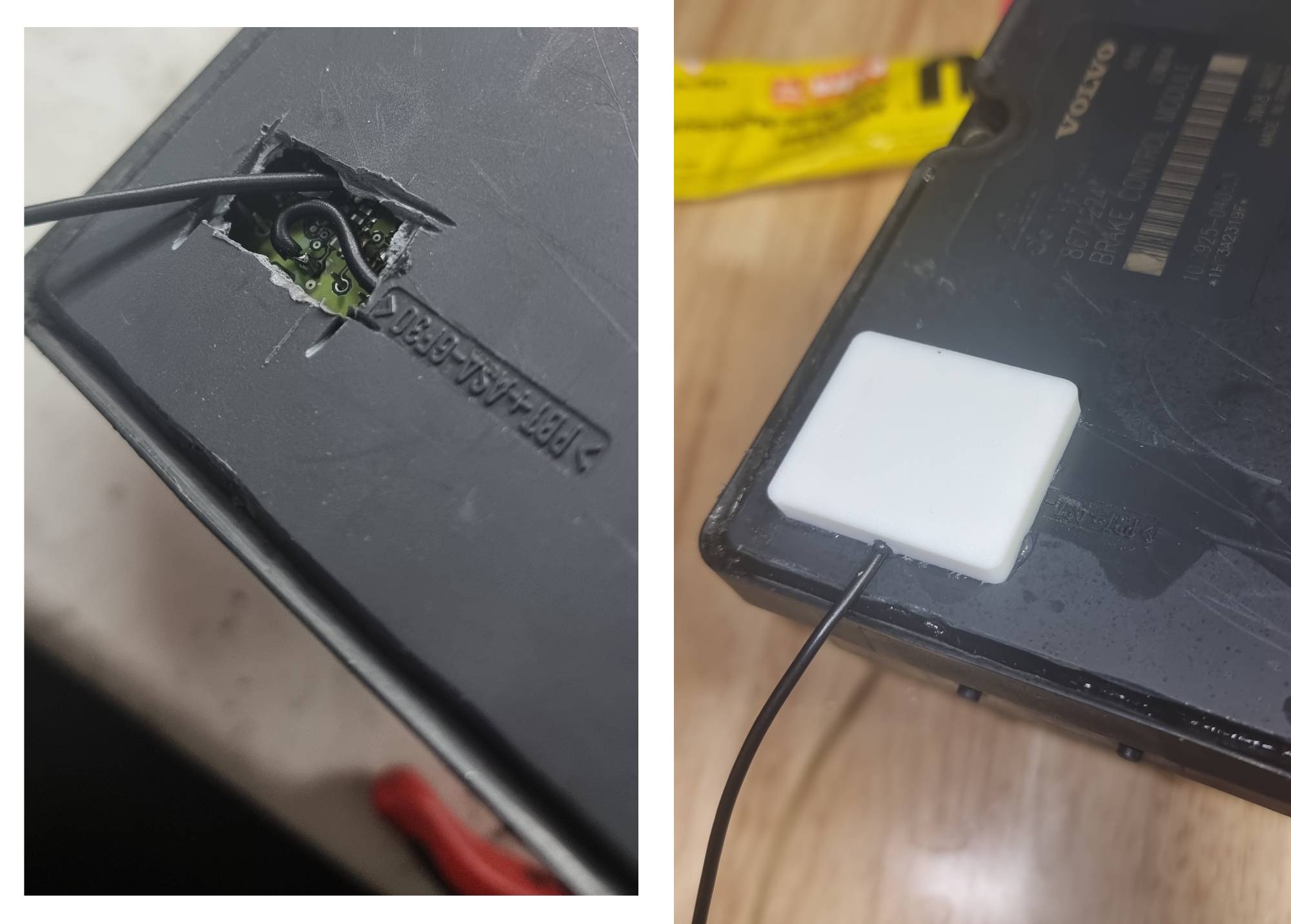

From this thread viewtopic.php?f=9&p=475693 and seeing the inside of the BCM, i wondered if i could simply route a single wire to the outside of the module. So i did that.
I cut it open above the broken pin with a dremel and soldered a new wire to it.
On top a 3d printed cableguide flooded with glue to keep it watertight.
So yeah, finally all the errors are gone and the car is ready for inspection.
