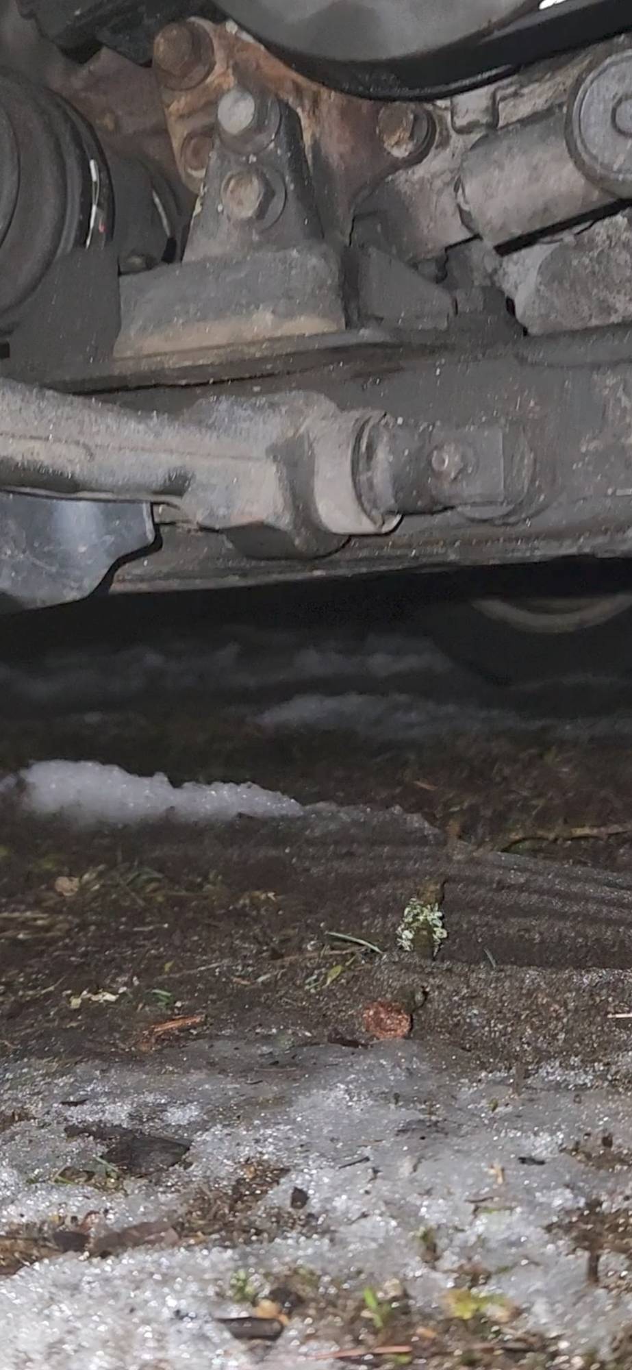

96 850 turbo...mine seems to have the 4 bolt configuration for the control arms...i am only seeing that setup for s70's online... and i am only seeing 2 bolt configuration for the 850's...do i just buy the ones listed for the s70?

We didn't get diesels this side of the Atlantic unless possibly private imports. So if you have owned the car from new then it is an anomaly if it has a 4 bolt control arm. Can you post a picture for us?
If you have not owned the car from new, it may have had an accident and someone fitted a later front subframe from a V/S/C 70 P80.
If that is the case then a regular 4 bolt part should be fine.

I think you have a swapped subframe. You need to match bolt pattern of course.

Yup. 4-bolt. Are the bushings for the subframe aluminum? Someone has probably swapped in a C70 convertible SF.

4 bolt.mrbrightside2009 wrote: 25 Jan 2024, 05:54 Back on this again...so I am going to post a pic of this arm...definitely looks like the 4 bolt configuration if someone can confirm this. I snapped a quick pic last night did not really look under there too well.
8628497 and 8628498

Agree with the others, subframe swapped. C70 or an AWD platform. Raising the motor up a bit helps with access to the bolts; pack your patience, it isn't a ten minute job.
