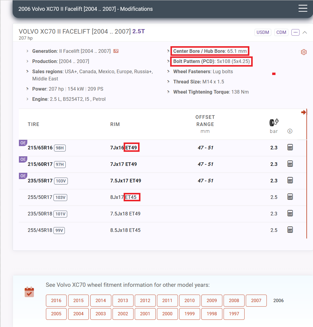

There are too many ways to look for a wheel but hopefully the following will help narrow it for you.
EDIT : In General
P1 & P3 Center Bore 63.4 mm
P2 Center Bore 65.1 mm
P2 XC90 Center Bore 67.1 mm (to 2014)
The first link and pic is for your P2. The specs in red are what's important when searching for on a wheel. The second link has a typical 17" wheel that will work and it list other P2 cars that you can interchange with. As long as you keep the offset at around ET45 to ET49 you should absolutely have no clearance issues.
The specs are stamps on the back of the rim. Make sure your current is within those specs. If it's different and you have no issues you maybe able to use something similar to that also.
https://www.wheel-size.com/size/volvo/x ... 7-25t--207
https://volvo-wheels.com/product/volvo- ... -thor-rim/

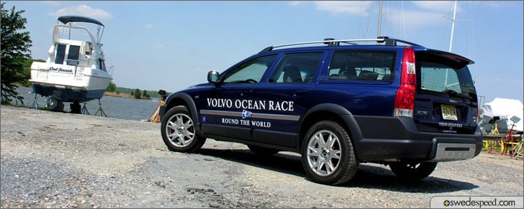

Are these the stock wheels? I like 'em.
volvo ocean-race-edition-xc70--06.jpg (73.9 KiB) Viewed 1534 times

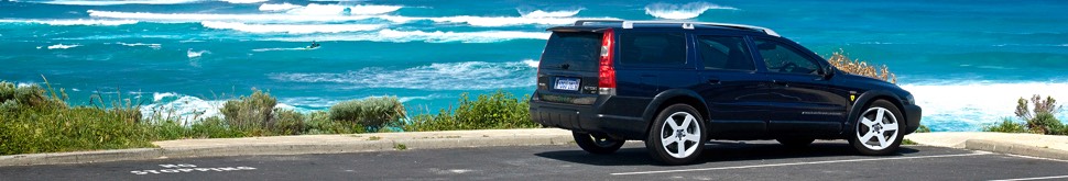

These are sharp. Taller I think. Ipd sells them as Pegasus replica 19", and OE Titan 17" for double.
ipd XC70.jpg (76.71 KiB) Viewed 1534 times
https://www.ipdusa.com/products/5125/Pe ... IPD-115072
https://www.ipdusa.com/products/23277/V ... vo-3529650
