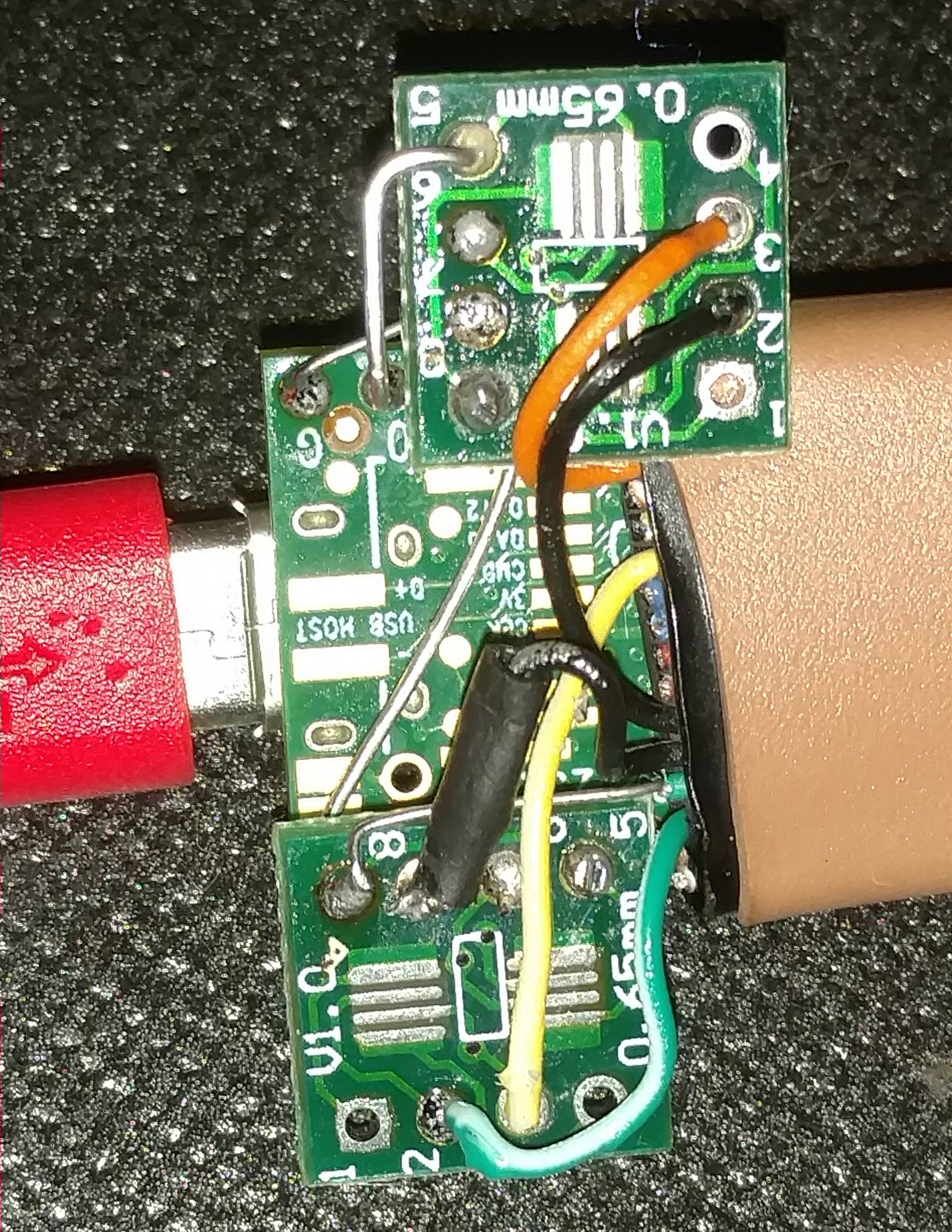

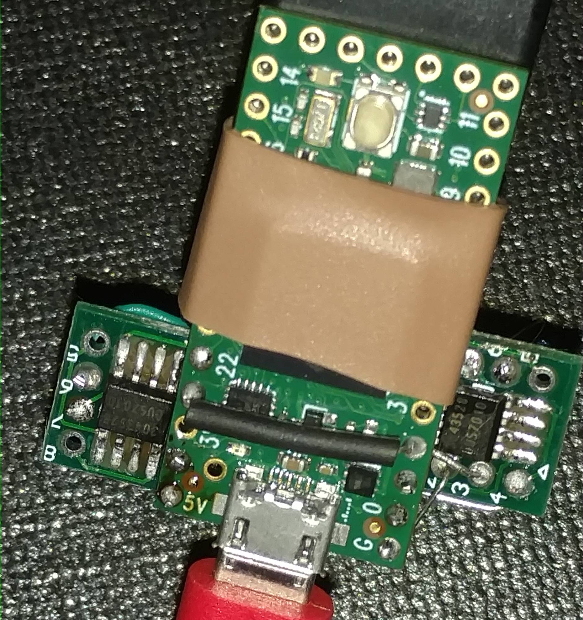

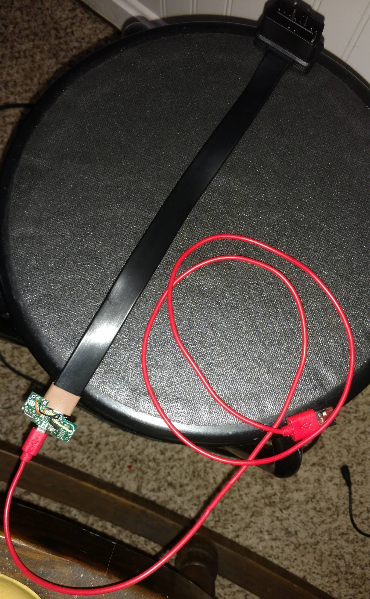

My goal is to DIY add a remote fob. My ID48 transponder is good - never had a problem with it. I have a new ILCO fob with 8 and 16 digit numbers.
I have read all 331 pages of this thread.
Cracked my 2005 S40 first attempt, only 5 minutes! I actually ordered boards from PCBway, but I had all the other parts and I just couldn't wait! Thanks VTL, Sirloin, RickHaleParker, cmolson and everyone. This was a fun project. I used Christian's "faster-attempt" branch. I may try "one-pass" out of curiosity someday.
I got a JRL cable, and VDASH recognizes it. Got my cracked pin uploaded to them. Now it says adding remotes, keys, transponders, everything all needs an IMMO CODE TOO. Is this true? Now they want me to buy a VDD bluetooth gadget to get this IMMO code, to get this remote added. Right here is where the buck stops.
I feel like I am back to square one. I'm not paying for VIDA, I am going to disconnect the siren from the module and replace the nimh battery in it with a capacitor (to keep the warning off of the dash) and we will use the metal key like we've done for 100 years or so.
