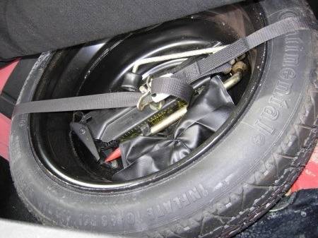

RedBrickCollector wrote: 03 Feb 2024, 03:44 Now that the suspension clunks are gone I think I need to address my spare tire and jack. I can't figure out how they stay secure. I can't tell if I'm missing something or if I just need to pad the whole area.
Page 124 of my owners manual. They are readily available in pdf form.
Don't know if this link will be location restricted.
https://www.manualslib.com/manual/533742/Volvo-850.html
Volvo Cars USA has a link as well.
Here is a for-instance pic from another forum.
spare tire.jpg (29.15 KiB) Viewed 819 times
Foam donut under has to be there, you may have to fiddle with the jack to get the lug wrench properly captured. I keep a couple of clean rags under the jack before I tighten the clip.

Post us a picture and we can possibly tell you if you are missing something in the spare wheel well. I see foggydogg has added a picture now so that should help.

I'm missing enough that I question why I have the spare in the car. I have the spare, warning triange. the jack, and the strap. No tools, no foam etc, just the donut and the seatbelt bracket. Would be good to know what I need to track down. Based on that section of the manual I seem to be missing the thing that secures the tire and the jack together and to the strap, and then the tools. Thanks

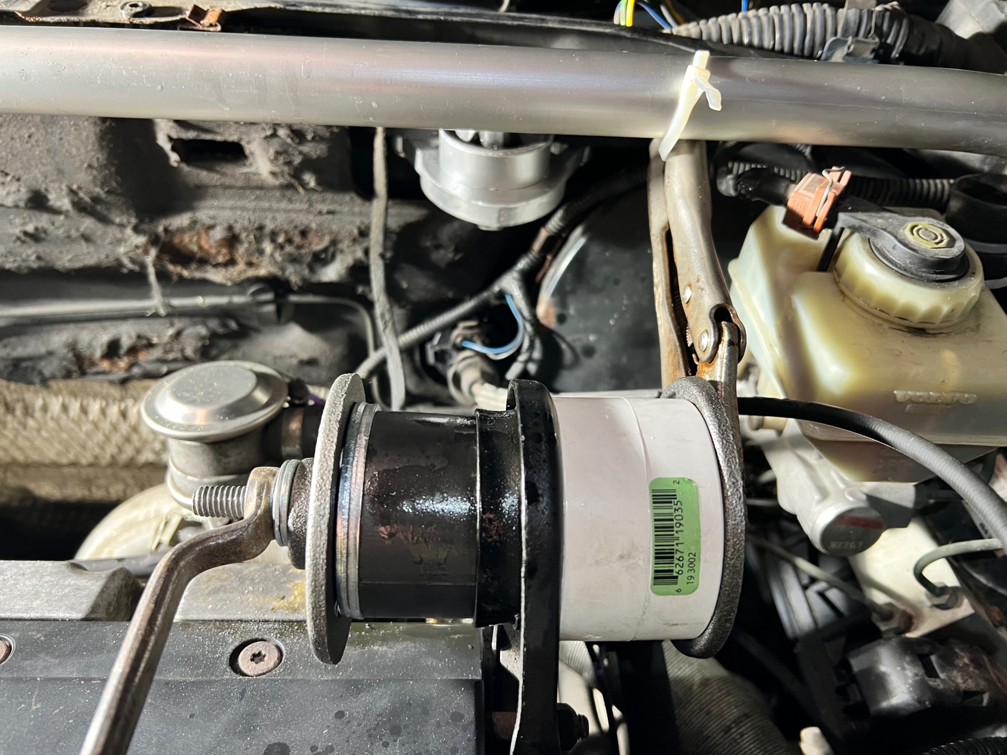

Got several things taken care of today:
1. Oil change - Mobil1 full synthetic 10W-30
2. Firewall engine torque mount
3. Upper engine torque mount
The upper engine torque mount is a real pain. I combined several different methods, and have to say the 2”pvc pipe coupling is the real hero. That really helped me keep things straight until the mount was seated.
