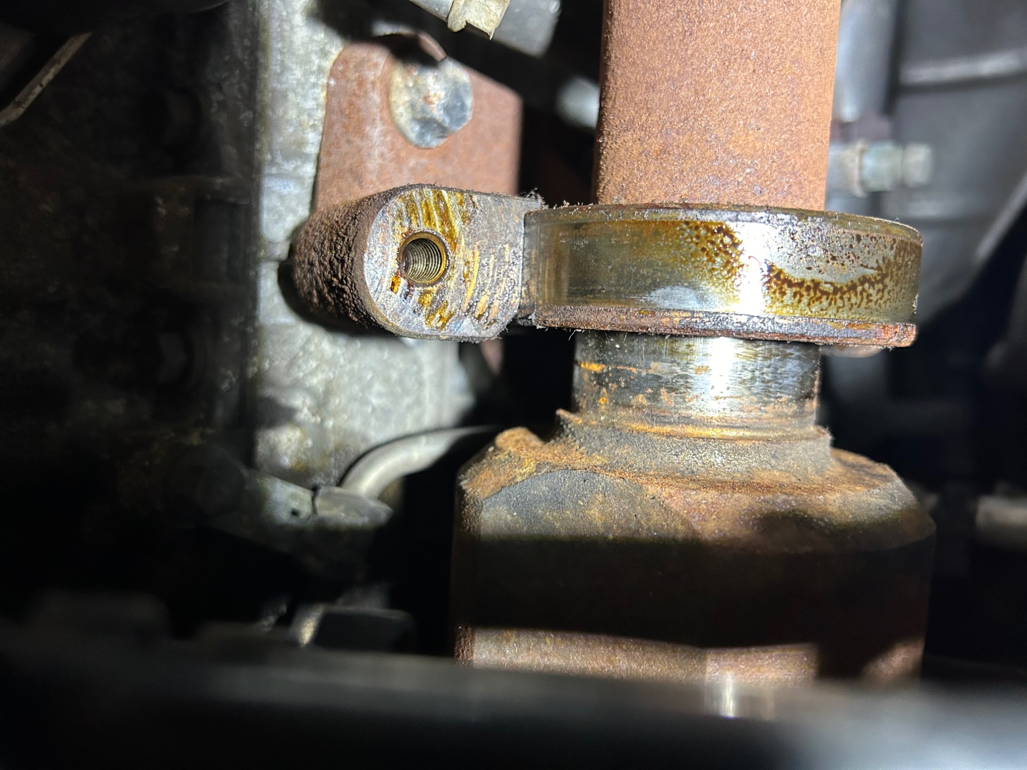

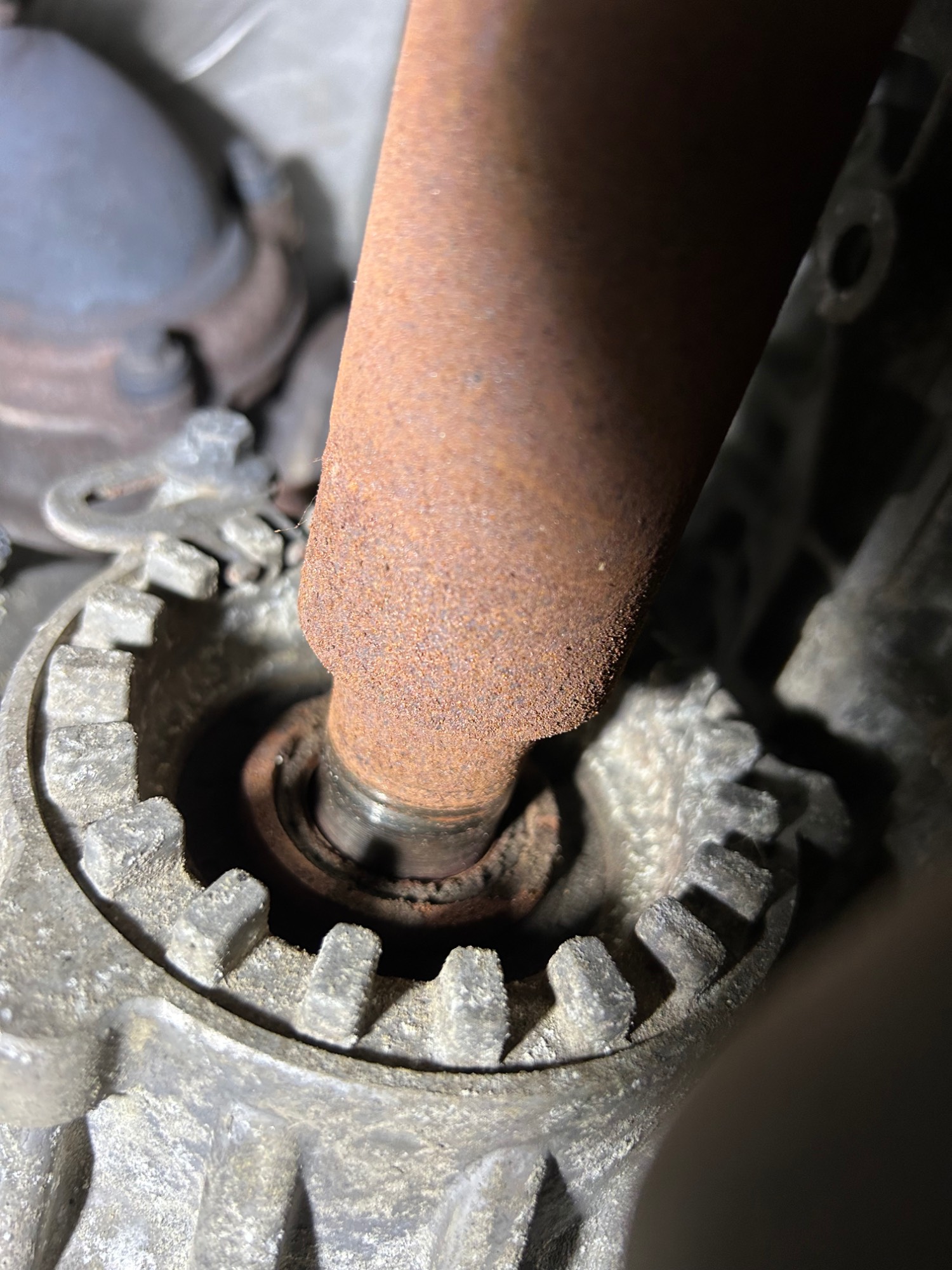

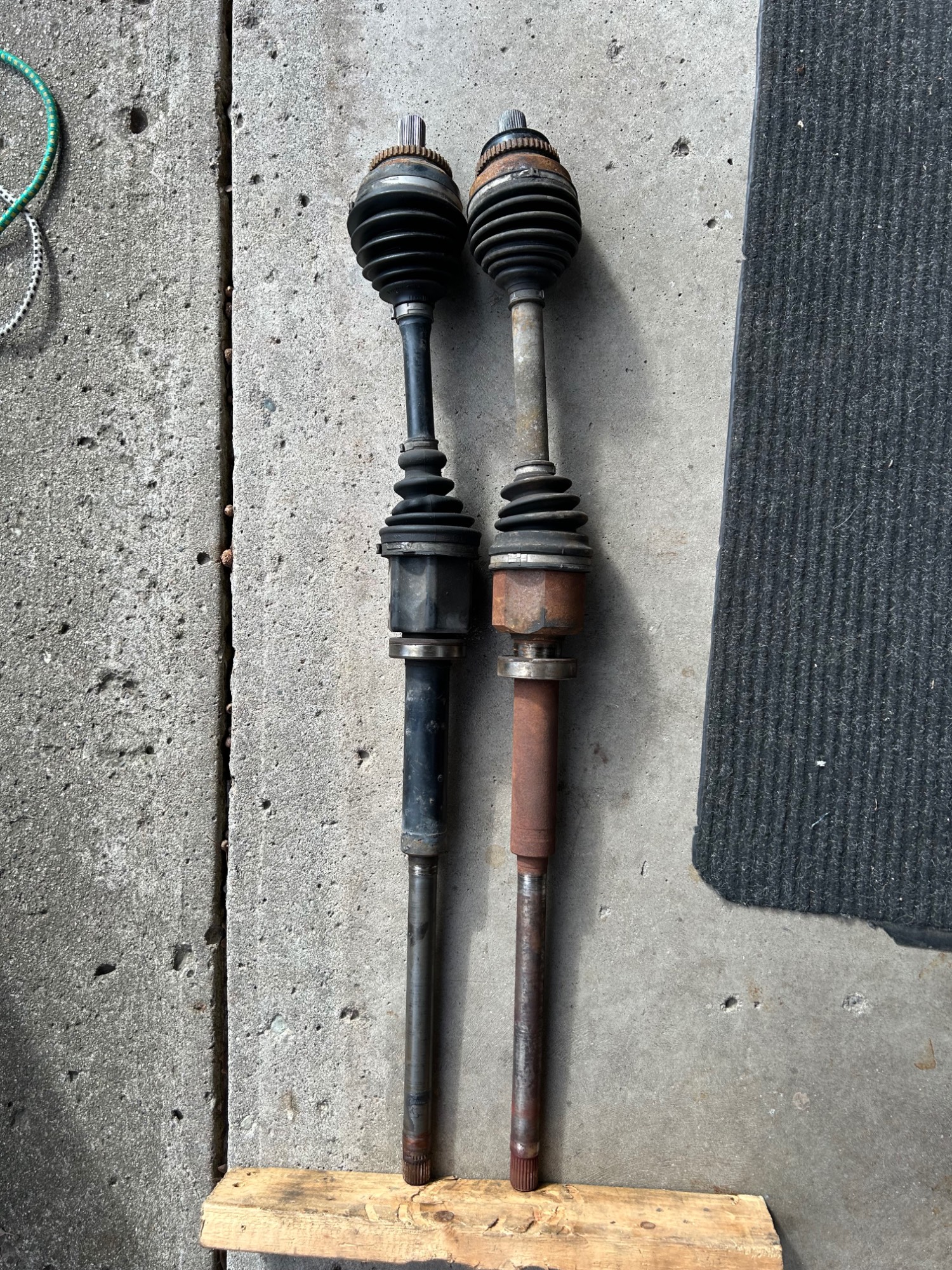

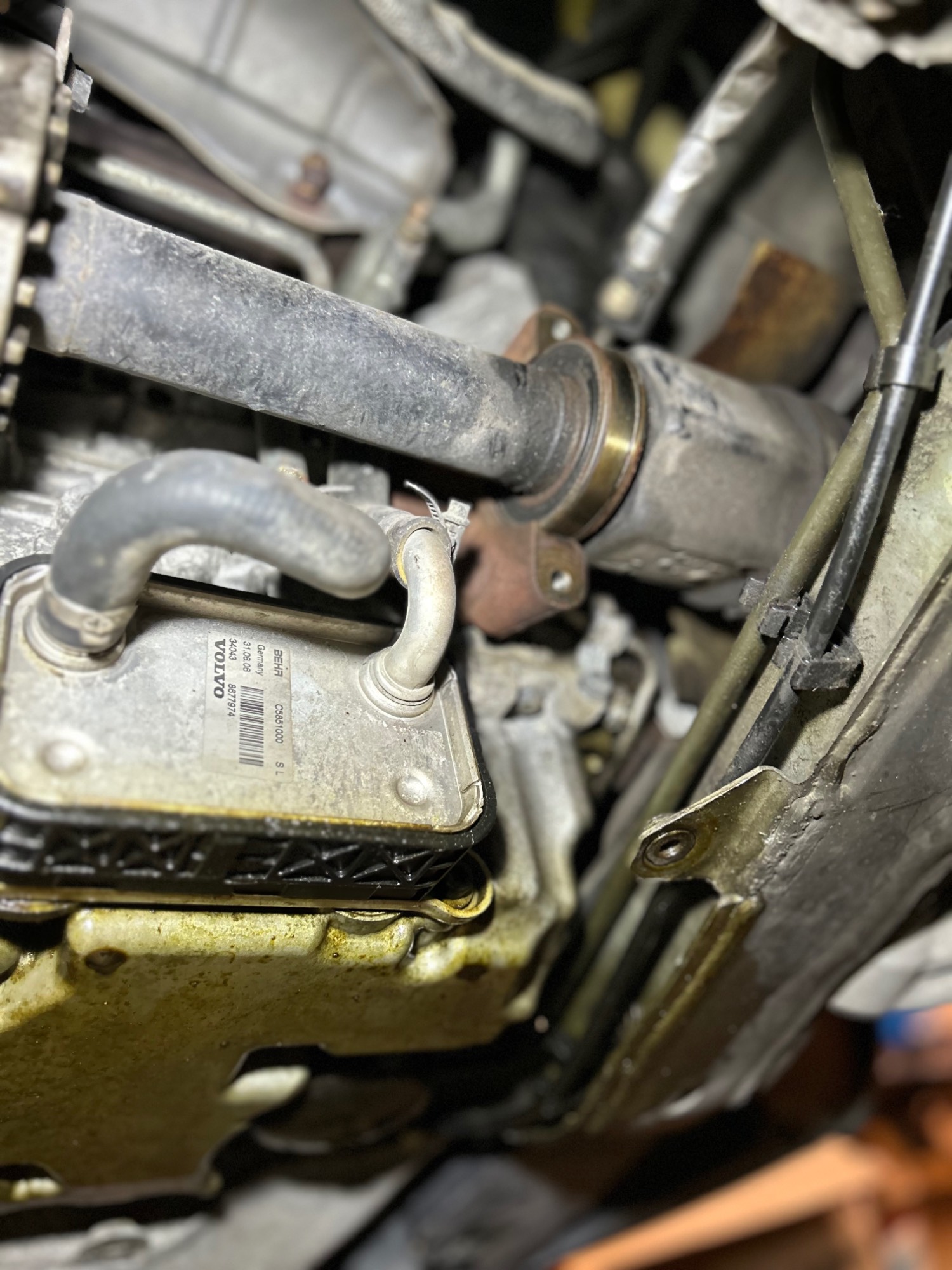

Once I removed the splash guard it was an easy diagnosis and simple fix - passenger's CV dislodged due to slippage of the half shaft through the carrier bearing. Easy fix because the other 07 is, unfortunately, laid up right now with engine problems.
Notice the uniform rust layer on this aftermarket axle, and the shiny surface where the carrier bearing started out. The shaft must have vibrated outward over time while the carrier bearing was held in place, until the CV splines finally slipped out of the transmission. And the other end at the transmission, shiny surface indicates how far the axle has backed out of the trans: This is what the carrier bearing is supposed to look like, from the other XC70: And the two axles side by side, you can see the distance to the carrier bearing is wrong: The splines looked OK on the end of the bad axle so I swapped in the axle from the laid up XC70, and everything seems fine so far.

Interestingly, Volvo does not employ a circlip on the inner side of the carrier bearing.
Maybe there is no need to.
I wonder if a worn-out suspension + deep potholes, allow the axle to pull outward excessively...

The standard carrier bearing is hard to drift onto the axle and equally hard to remove. You could 'stake' the bearing face and hammer the bearing back to it's correct position, and also stake with a pointed centerpunch around the outer surface by the bearing to prevent it moving again. There are also glues for bearings that you could use to prevent this happening again and then re-use the axle.
