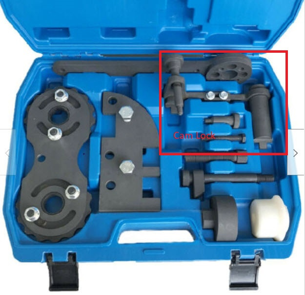

With the camshaft lock tool. It goes in the slots on the back of the cams. The slots are offset so there is no way to get it wrong. That will align the cams to the head.
2015 S60 T5 - 4 cylinder

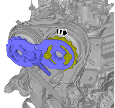

craiger wrote: 04 Dec 2023, 15:52 Follow-up question: I see how to align the cams and the crank, but you also mentioned a pre-load on the cams. What is this?
Did you have any luck? I’m currently working on a 2016 XC90 I replaced burnt valves in. I have the cams locked in the rear but the tool for the gears seems to be off per the factory pictures.
Did you have any luck with your 90? I’m reassembling one right now and trying to find info on the cam gears. The pics previously posted make it seem like only the intake gear is unlocked? Do both get unlocked? Did you take any pictures?Notavolvofan wrote: 12 Dec 2023, 11:39craiger wrote: 04 Dec 2023, 15:52 Follow-up question: I see how to align the cams and the crank, but you also mentioned a pre-load on the cams. What is this?
