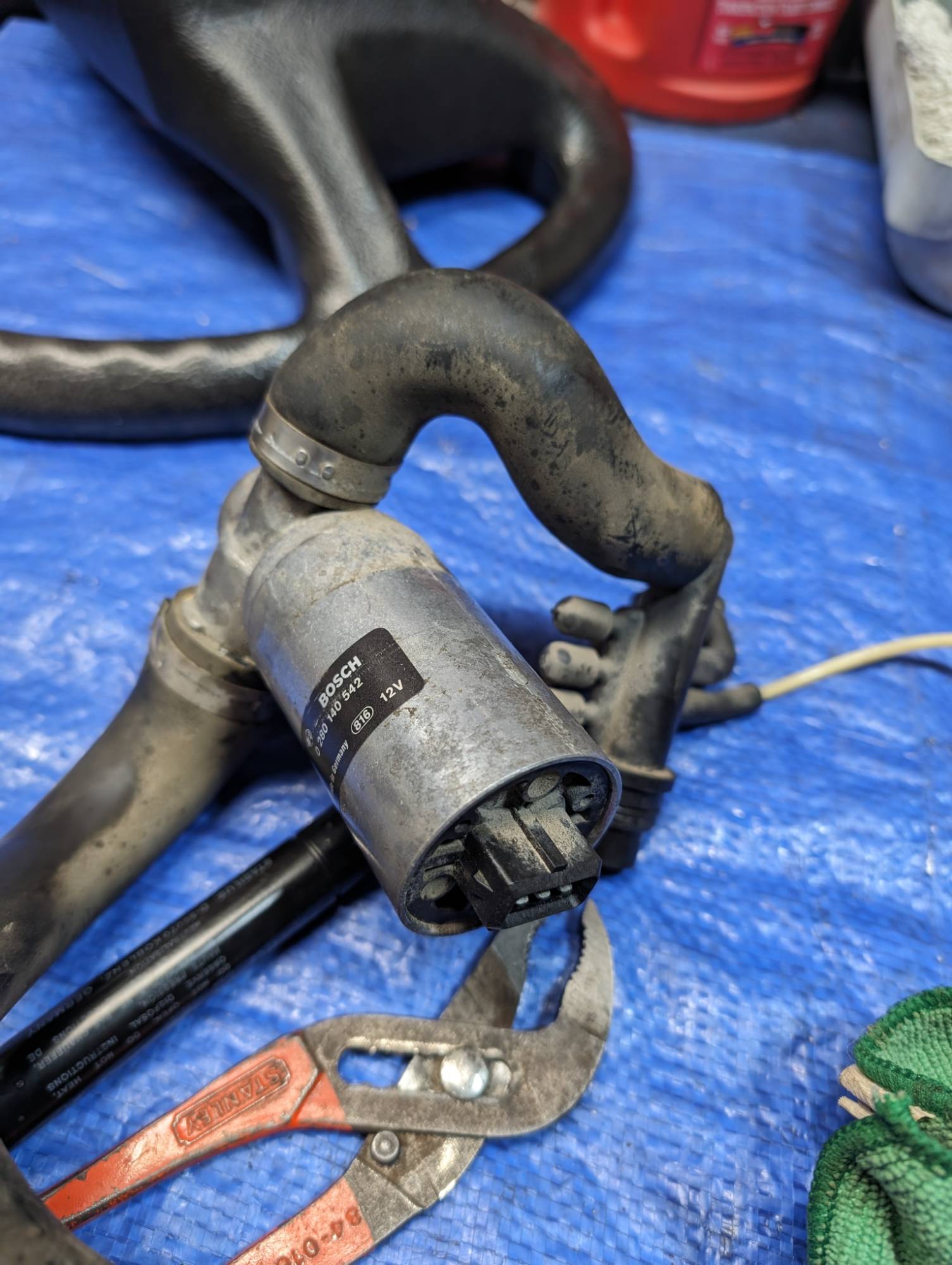

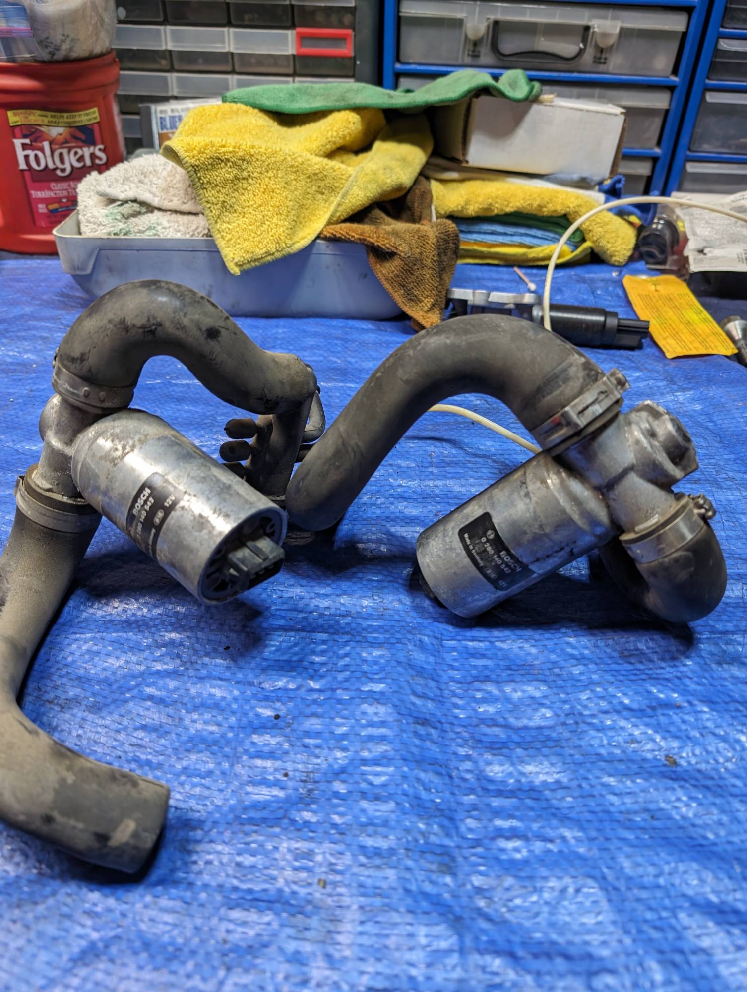

Well lifted the hood tonight AFTER having been to the junkyard at -6C and wind chill.
Nope, no IAC valve on my engine. I think as suggested and I thought it is not part of ETM engines (99-) in spite of the Volvo sites AND my copy of Vida implying my car is fitted with the IAC Valve.
So now I have 2 x IAC valves. I literally pulled one from a 98 S70 when I noticed a large shadow behind me. It was an impatient driver in a huge Volvo loader with the forks down to lift the car I was working on. I had hoped to grab another couple of parts but not to be!!
I pulled the IAC valves as well as the intake vacuum 'tree' and all the clips associated with it. Interestingly, neither car (97 850 NA, 98 S0 NA) have an original Volvo item. Both have Bosch labelled units. That surprises me as I have had no experience of these failing.
Well, guess once they are cleaned they can go onto the shelf for the -98 car I work on for others.
Now just have to clean them!
