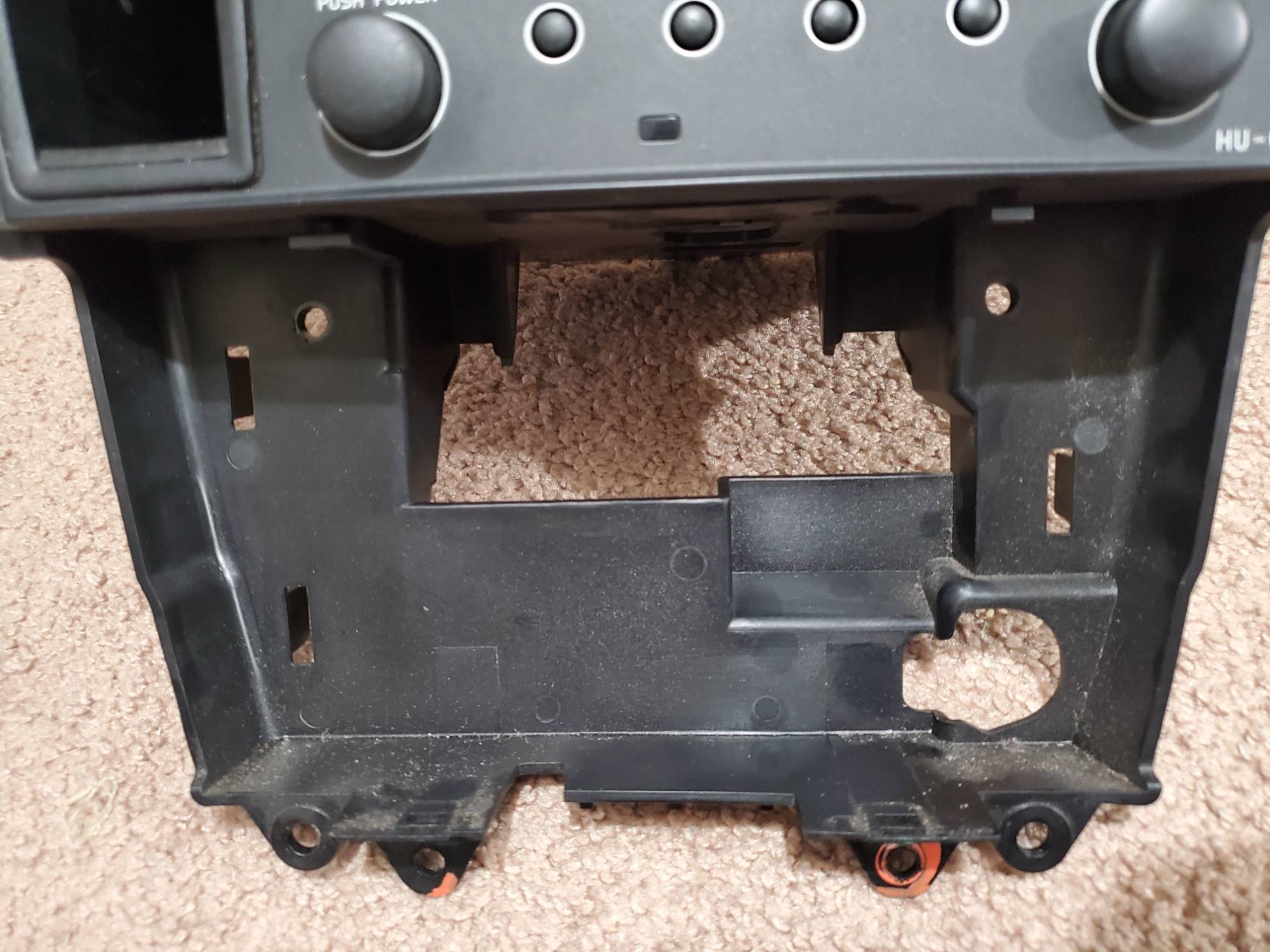

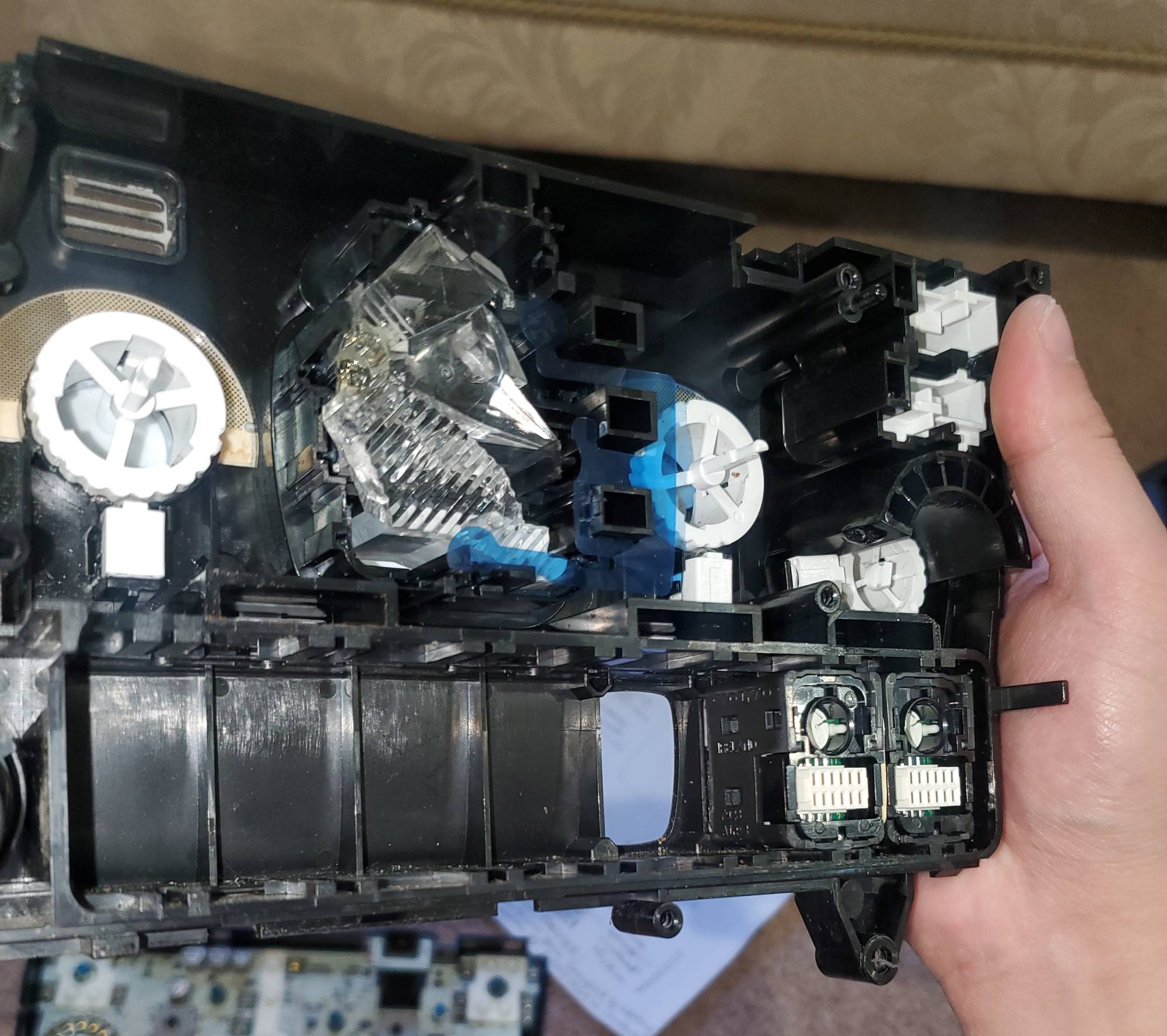

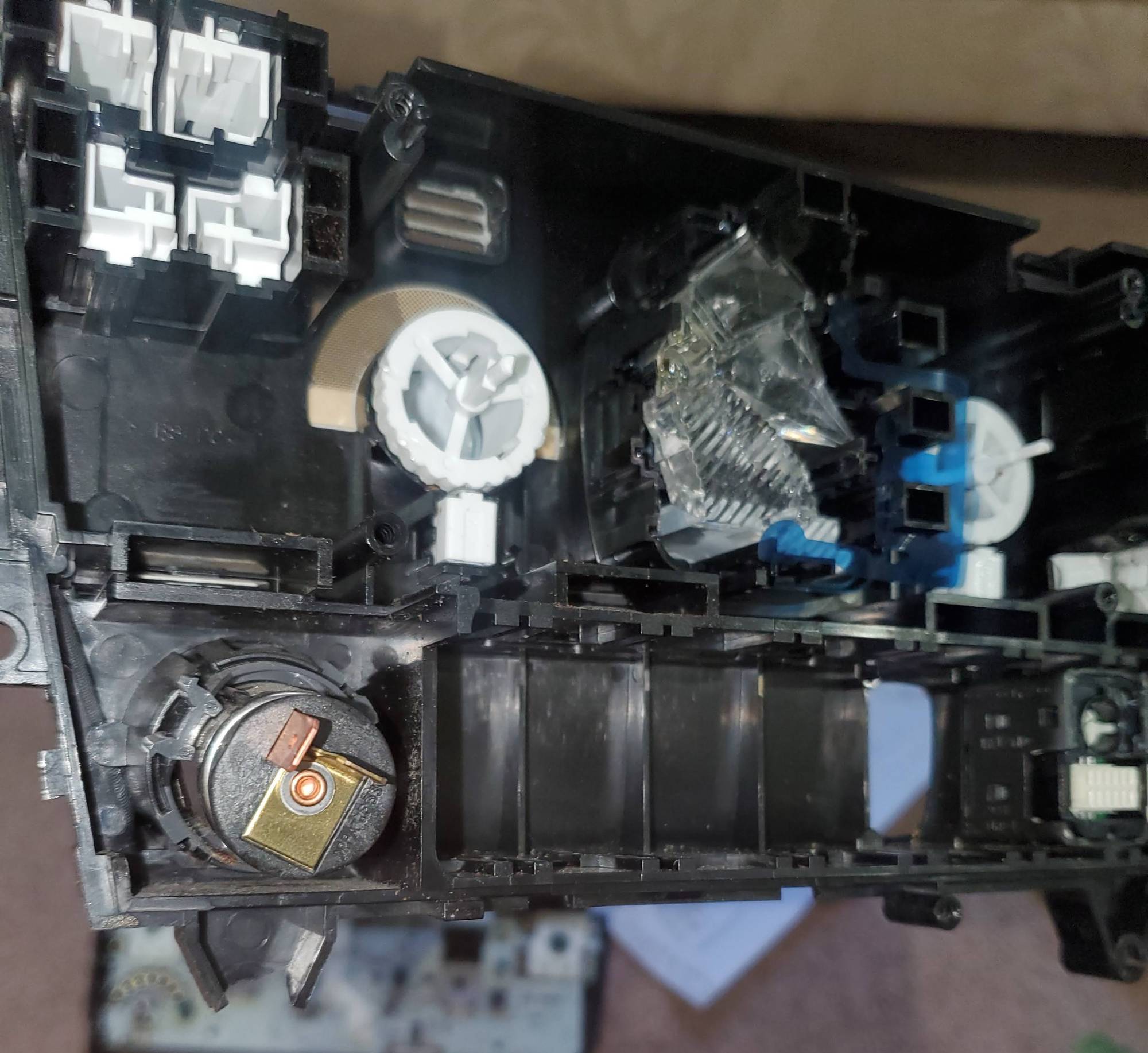

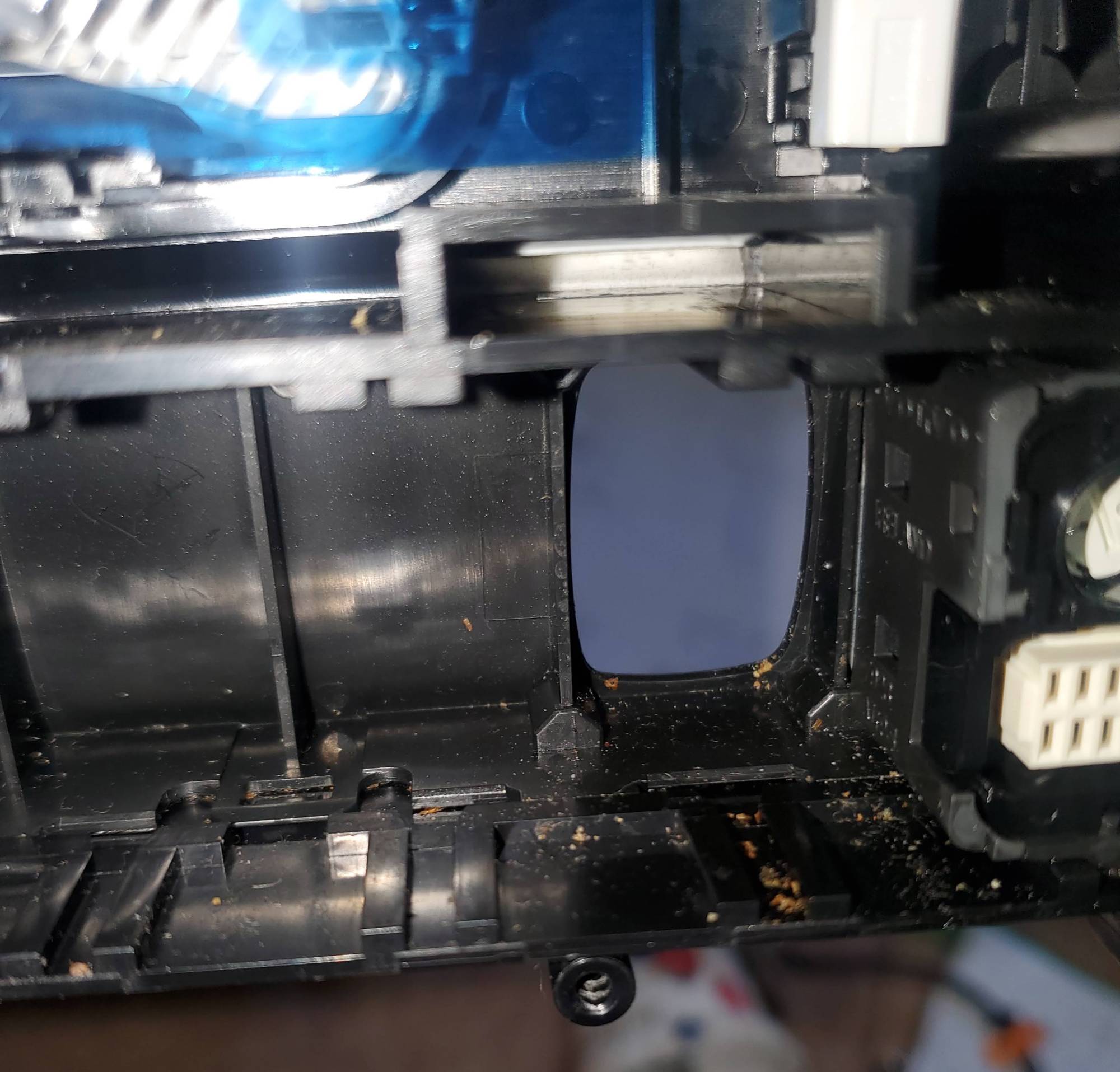

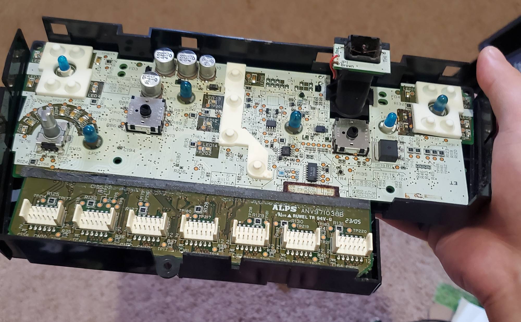

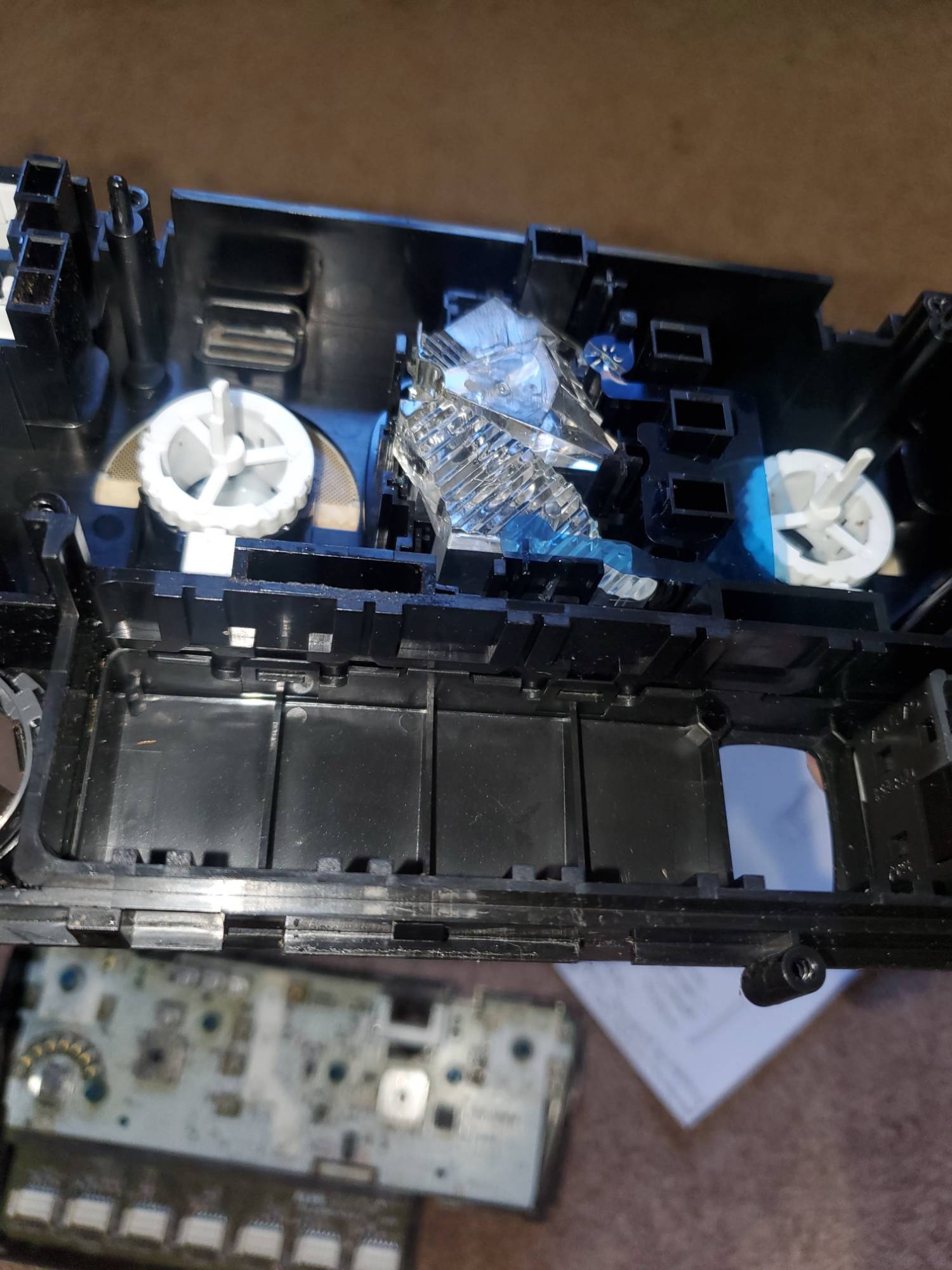

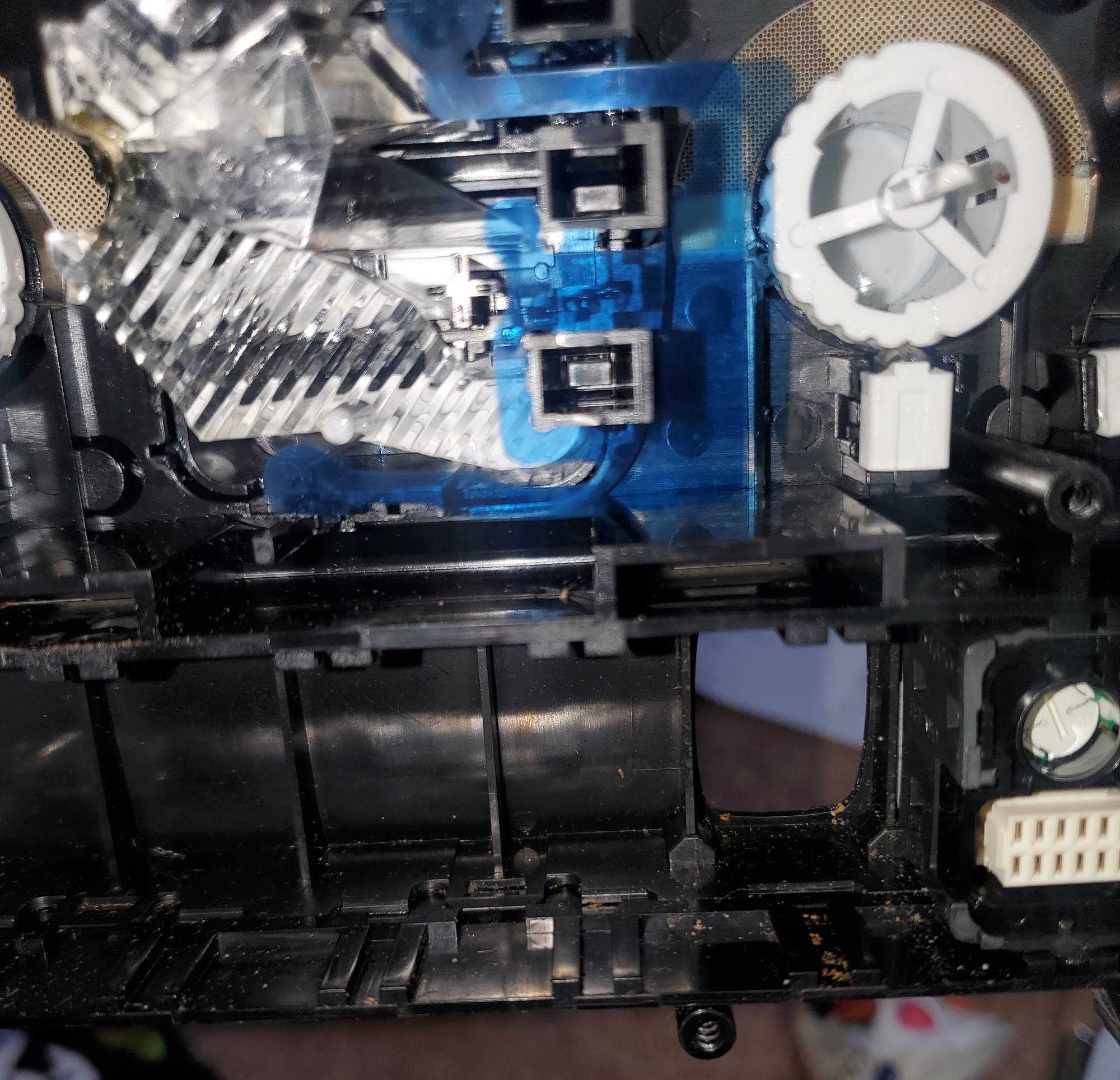

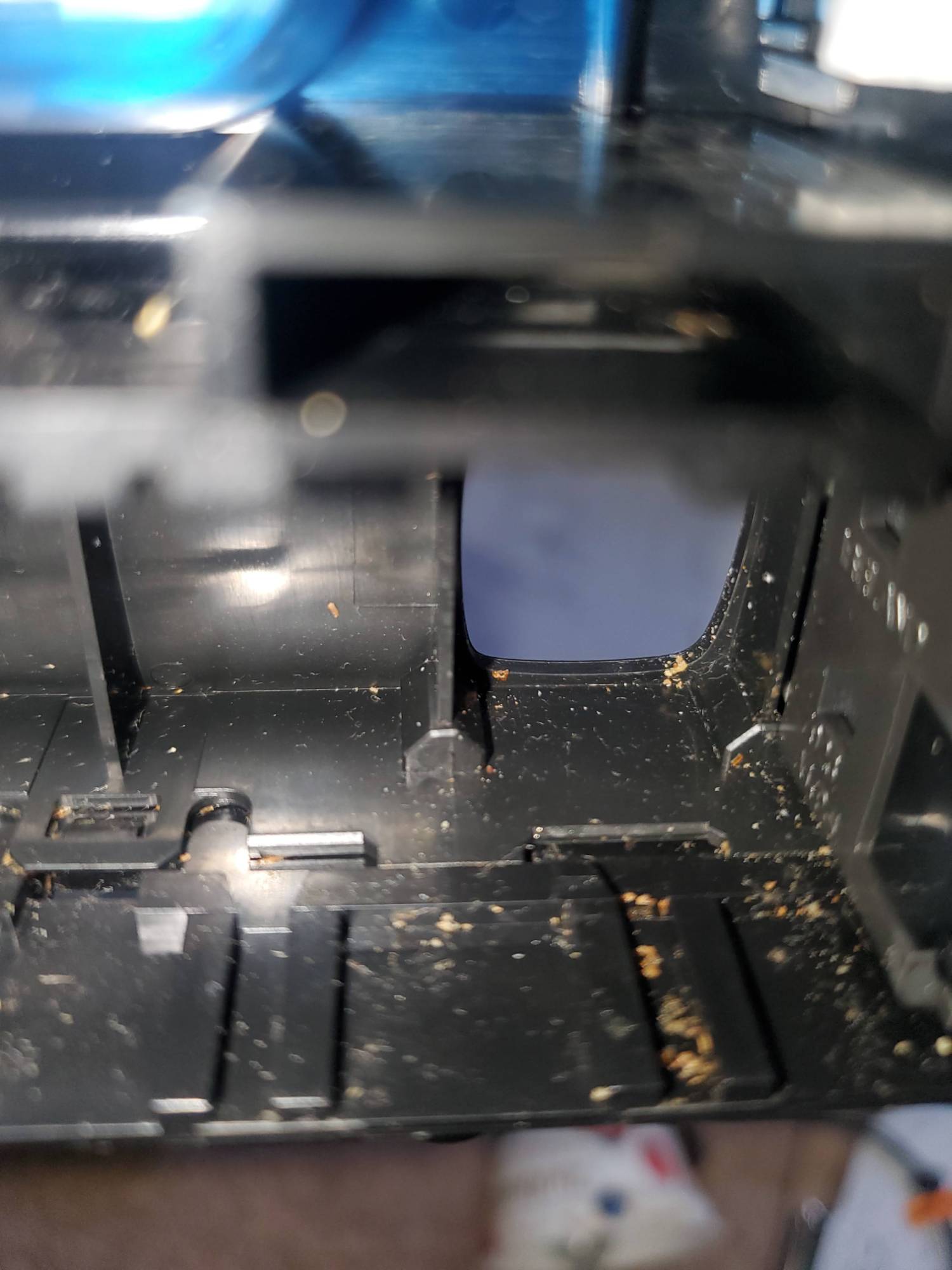

What you'll see inside the CCM:

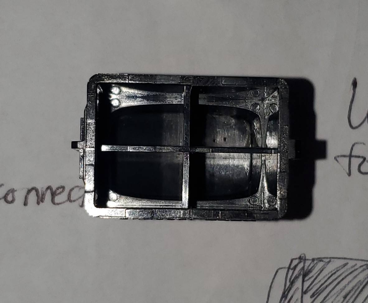

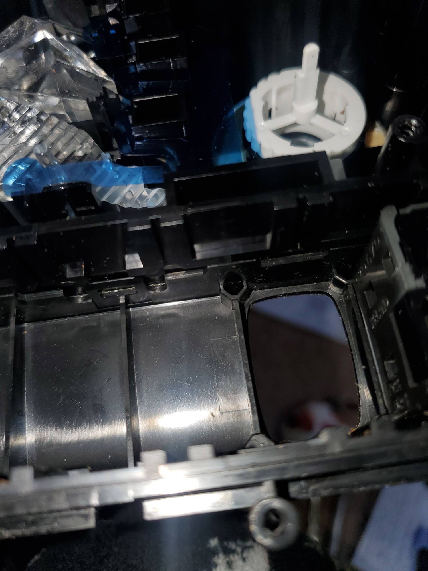

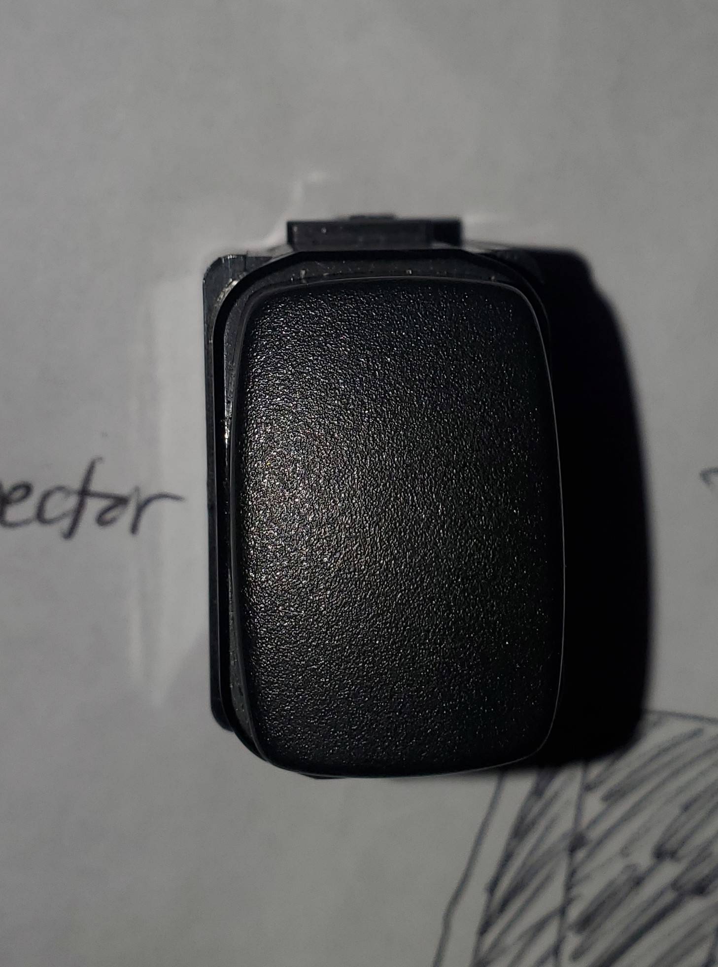

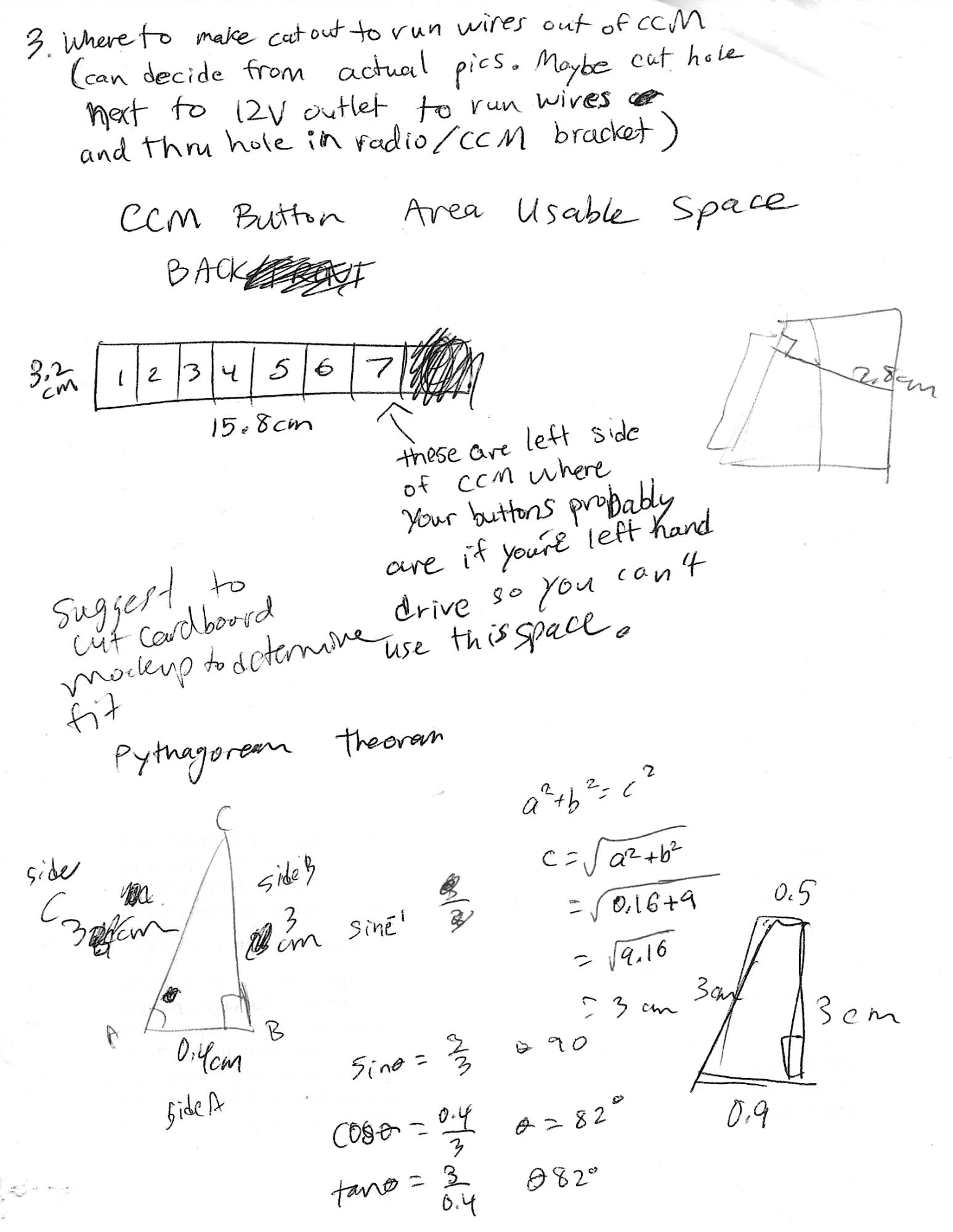

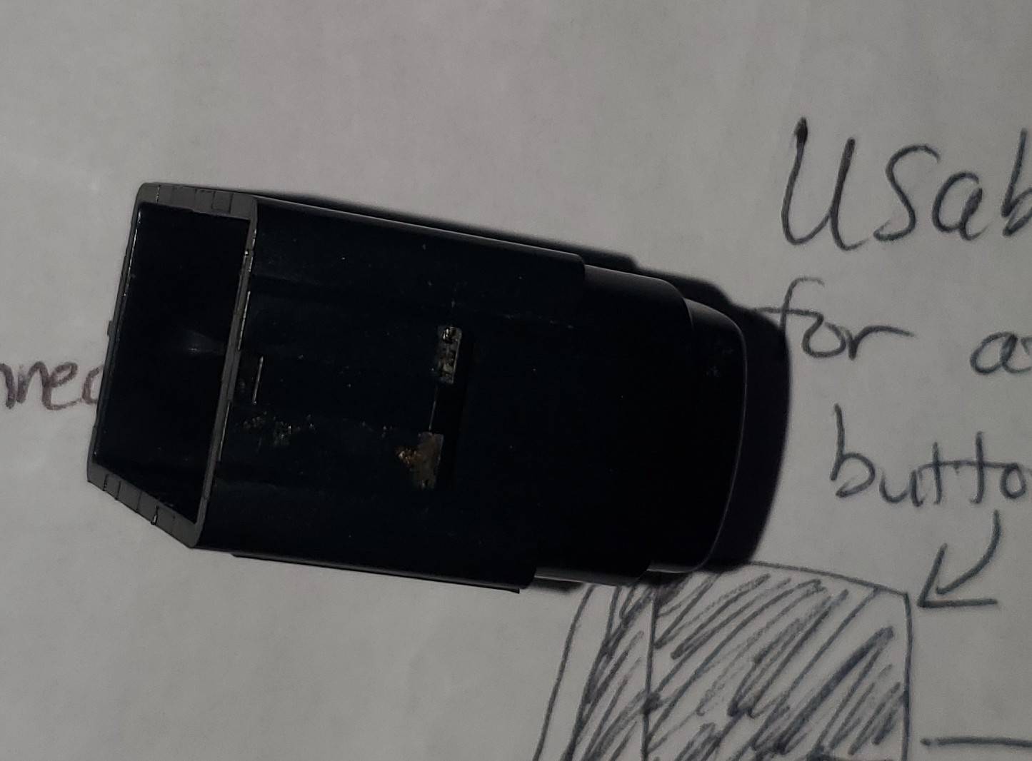

When you have the CCM disassembled, you'll see the space where the center console switches reside and a few empty, unused spaces. There are actually connectors present for every possible switch position (7 in total), along with the circuit board behind it, limiting usable space for your aftermarket switch.

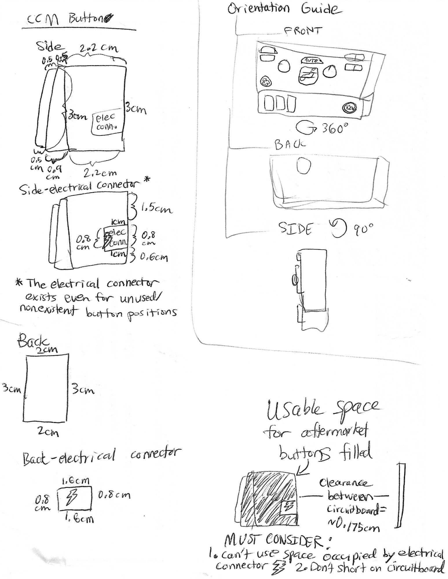

Measurements of useful space to fit your aftermarket button
I measured the usable space to the best of my ability and took pictures of what it looks like inside the climate control module. I measured the blank switch placeholder from my car to determine dimensions/space. Hopefully it helps you figure out if your aftermarket button / knob will fit.
Here are pics and my diagram of the center console switches area (please don't mind the soda residue) https://photos.app.goo.gl/qhVMMGd957PttMRVA
(Photos and PDF of my diagram are also attached to this post for backup purpose)
  • Note that buttons are at a slight angle
    The faceplate and center console switches are slightly slanted for styling purposes, so aftermarket switches screwed onto the faceplate will sit at a slight angle. The angle of faceplate with respect to the bottom of the CCM is 82 degrees according to my dubious geometry. You might decide to estimate the diagonal length needed to fit your switch (e.g. any protruding circuitboard) using some geometry.
Idea about testing if your aftermarket button fits
You may want to cut a piece of cardboard to size of your switch and stick it in the empty button space, and reassemble the CCM to make sure your aftermarket switch fits and no conductive surfaces are touching the CCM circuitboard.
ccm buttons.pdf
Diagram pdf
(743.59 KiB) Downloaded 167 times
Diagram pg1 jpg
Diagram pg1 jpg
ccm buttons-1.jpg (204.23 KiB) Viewed 2570 times
Diagram pg2 jpg
Diagram pg2 jpg
ccm buttons-2.jpg (181.55 KiB) Viewed 2570 times

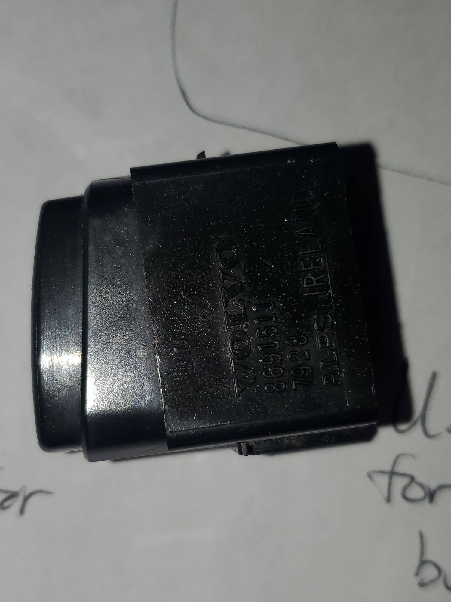

2) If you search online, you can learn to modify Volvo push-buttons to change their functionality.
That is you can take a spare DSTC button for example, modify it and you now have an AUX lighting button :)
The AUX lighting button does not appear to need configuration change (i.e. add the button + lights and you're done).

I tried adding this button on my V70 MY06 today and can confirm that the Aux. Light signal works without any software changes (for once!).
You simply follow the Volvo Aux. Light kit instructions (VCC-264259-1.pdf) and don't forget to "cold boot" (i.e. battery disconnect).
I tried it without the cold boot process and my CCM was reporting in VIDA that the new added switch was defective!
Also, it wasn't clear to me (but makes sense) that the function is only active (ground on the connector's brown wire, meant for a high-current relay) when you go to high-beams.
