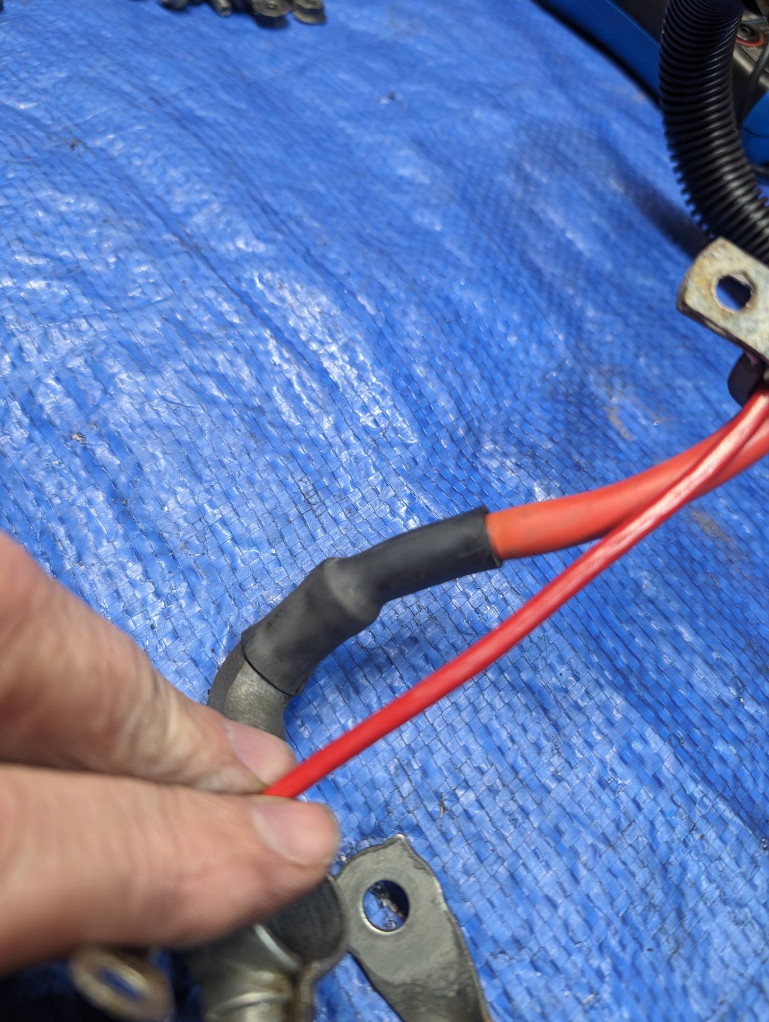

I had planned to pull the +ve battery cable for experiments from a 98 S70 yesterday, but the guy with the loader wanted me out of the way to get the car to crush it, so I didn't get the cable from it. I pulled on instead from a 97 850 NA. I noticed there is a smaller attached red lead that ran along with the main cable inside the harness and I believe may have run on beyond the starter. I don't see that on the later cars, and due to lack of time I just cut it, as getting anything out of that main harness cover is a bear, especially at -6C after being there for over an hour!
I'm now curious what that cable was for? Does it run to the alternator perhaps or is it an non-standard add in?

This is the extra wire that was attached through the main harness with the battery +ve cable. As it was taped to the main +ve cable was this an original feature on an 850?

I dont think my 96 850 has the extra wire, but I'd have to double check to be sure. I'm at work right now.
