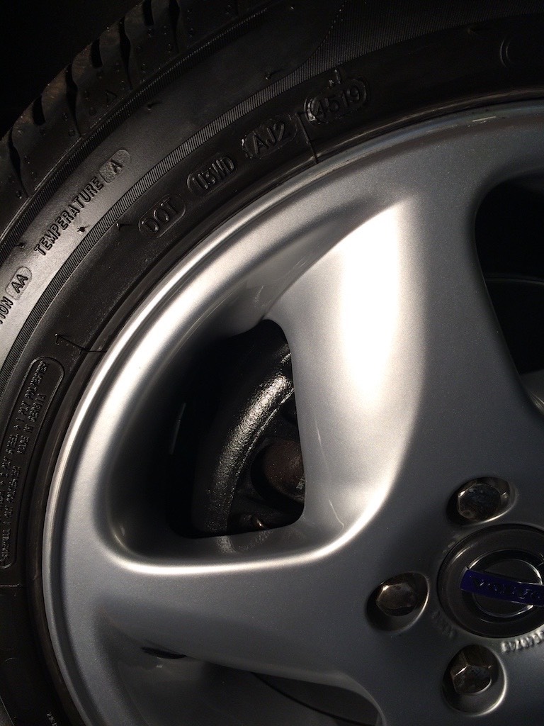

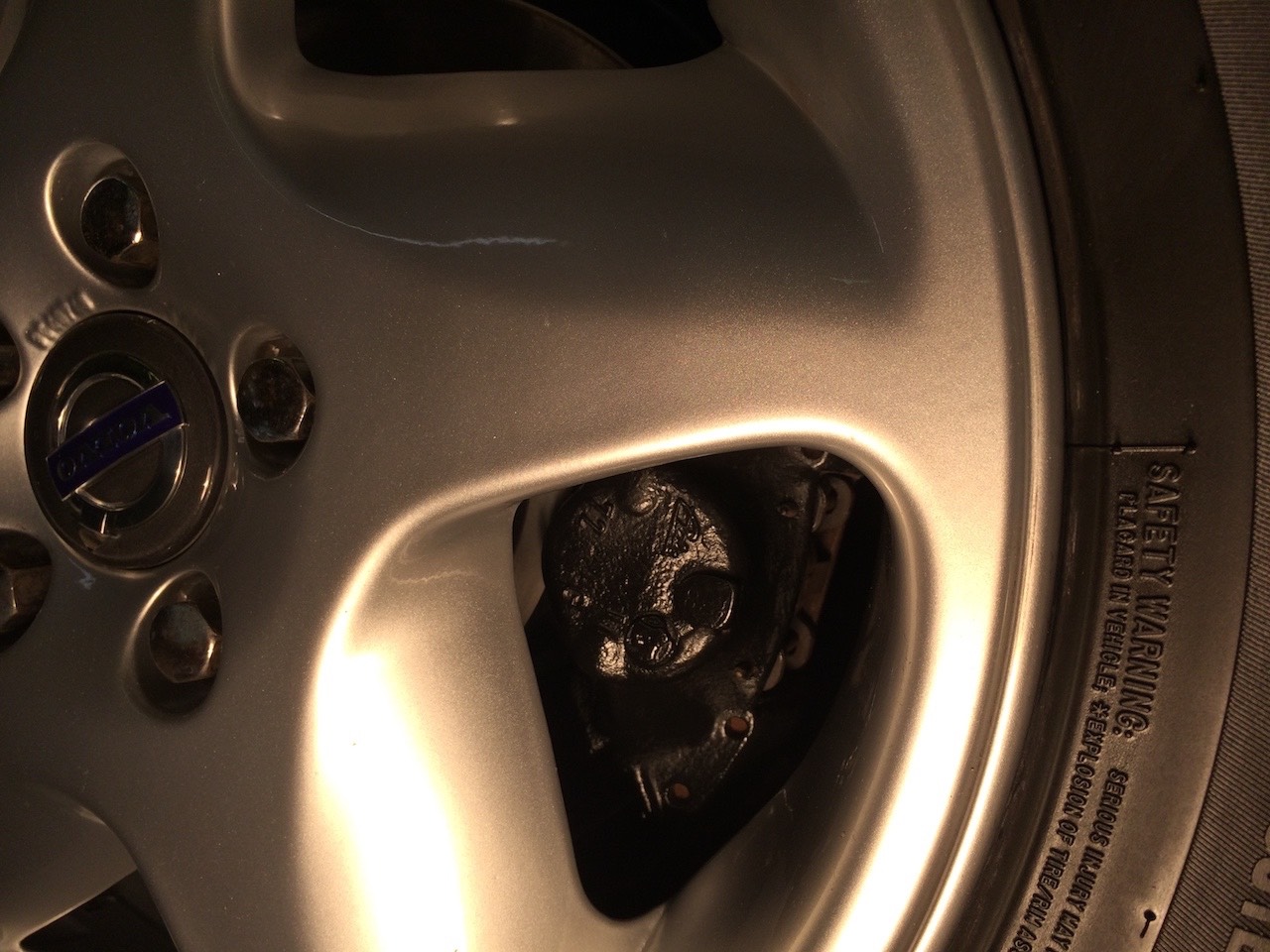

Rear brake disc after sitting in the garage for 5 months
Front brake disc after sitting in the garage for 5 months
