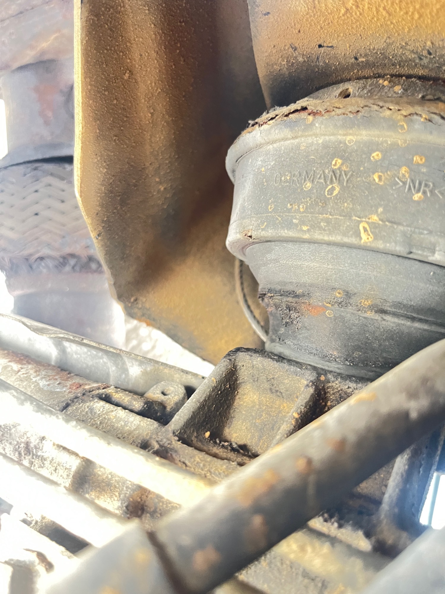

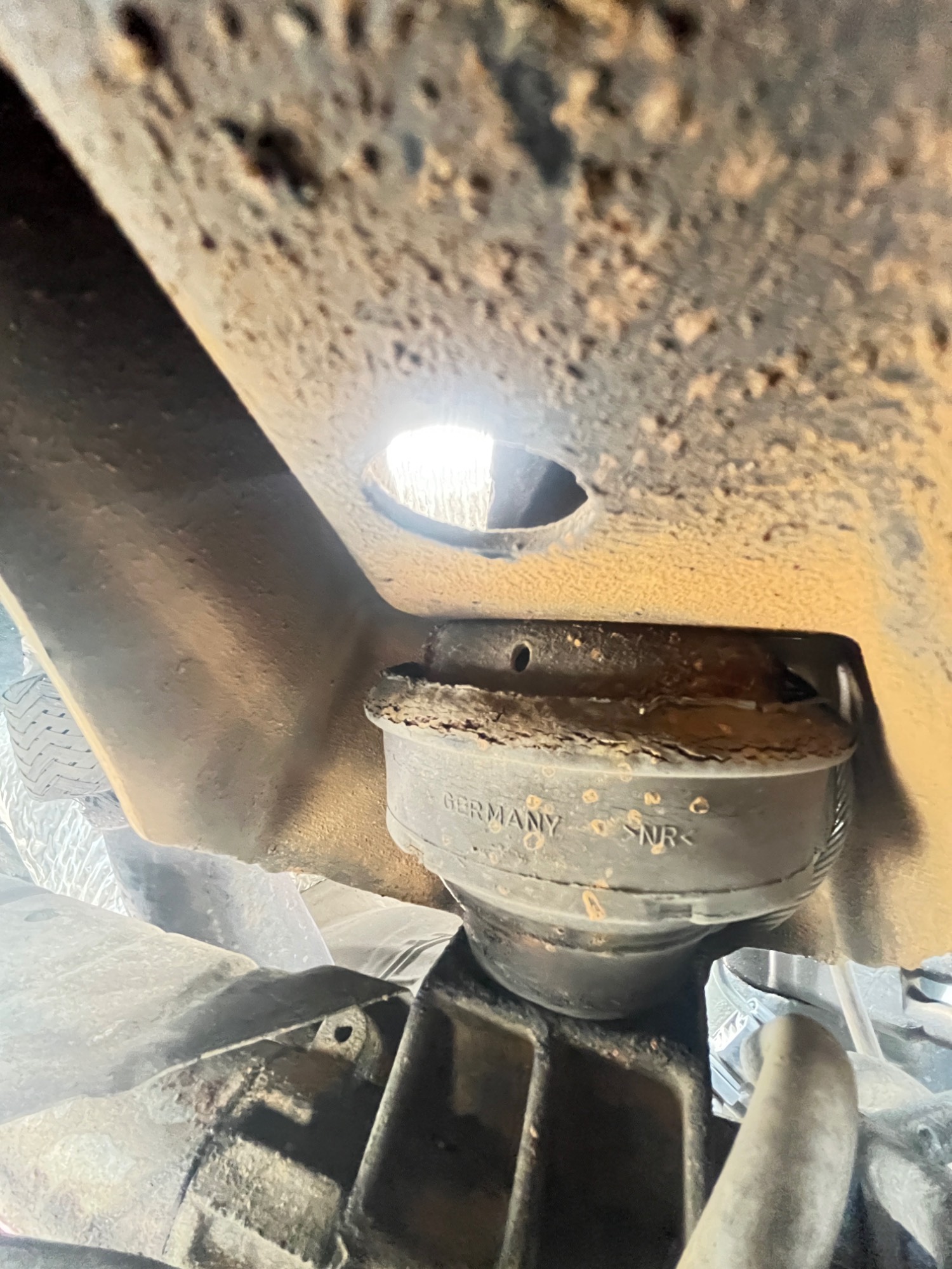

New photos for you Neil of the rear bushing:
Feels SUPER crusty at the top. I’m guessing a new one will help get the engine raised a little and back into place?

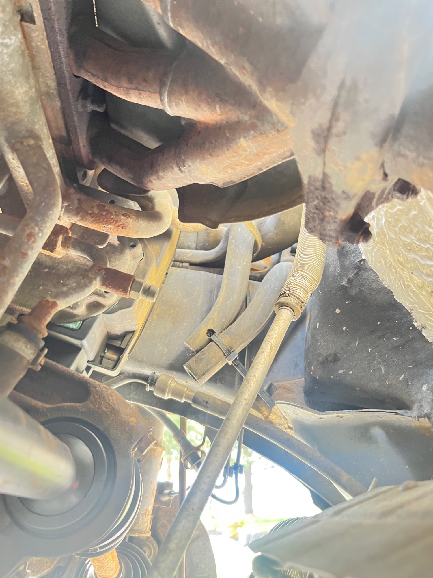

Also discovered that a previous owner, at some point, disconnected some hoses and took emissions into their own hands:
Looks like something is supposed to be plugged into that nipple there, but oh well.
