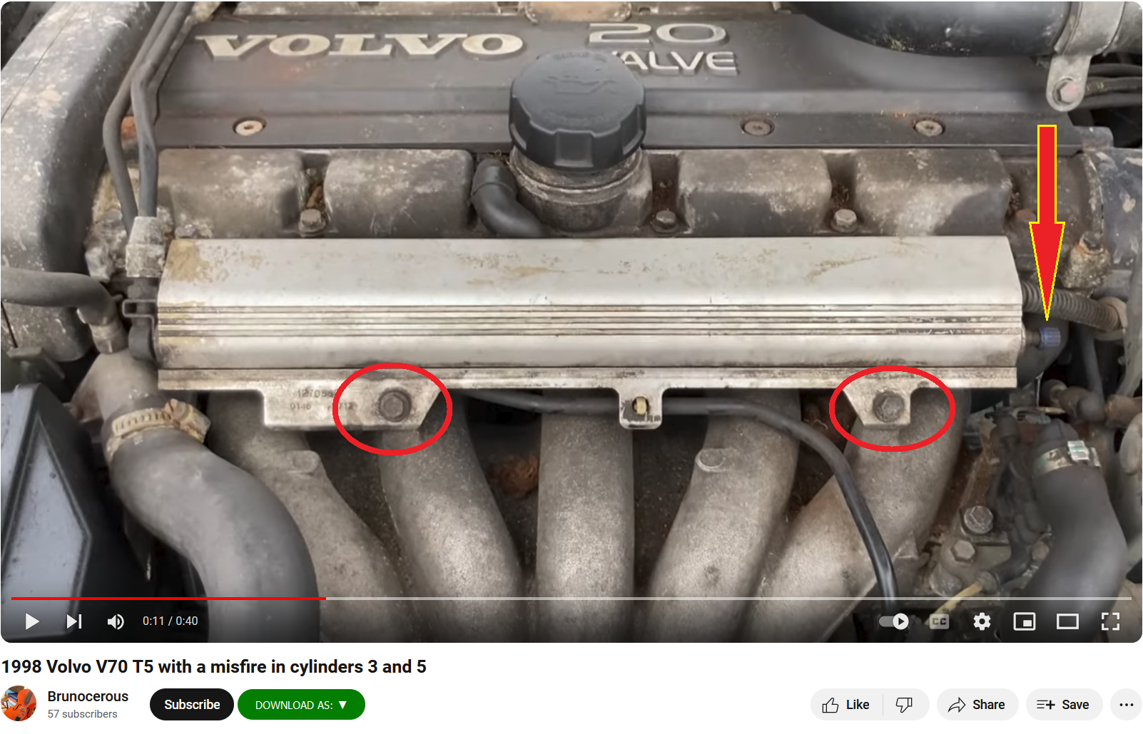

Could be fuel, spark or timing. You want to be sure not to crank too many times in case you are flooding the cylinder and then the CAT. Turn the key to Position 2 and push the Schrader valve to see if there is fuel squirting out.
Next check the cap & rotor. If it seems to look okay then remove the 2 screws to expose the injectors. Unplug the connectors and with the key in the Position 2 test to see if you have Voltage at the leads. Polarity doesn't matter when checking. If you have voltage then check spark to the plugs.
Timing would be the last to check.
