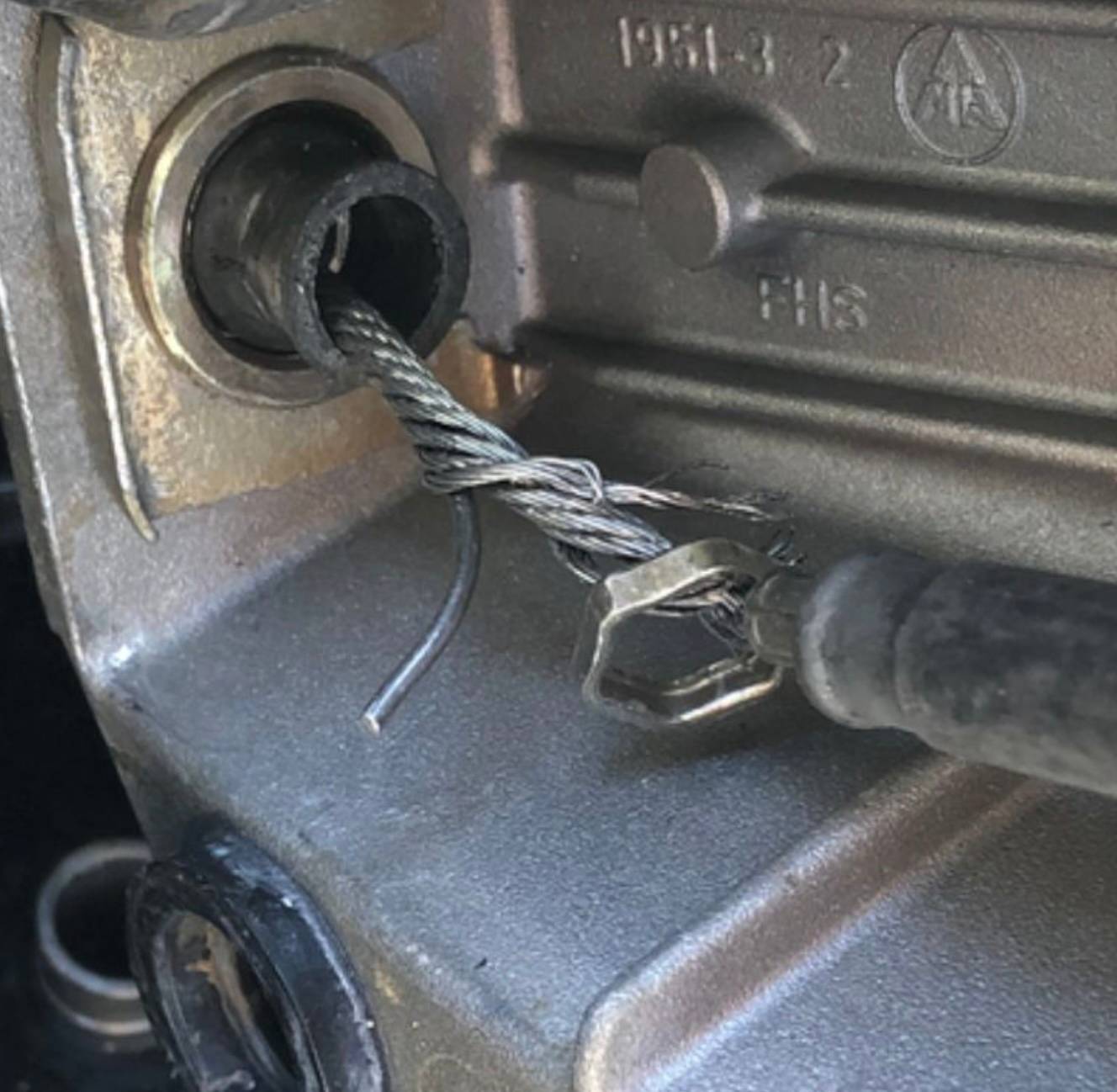

Today I took thinks apart and found this.
It finally frayed enough so that the remaining strands just bend instead of moving the cable and actuating the gearbox. The shifter just bounced around and was clearly not switching gears anymore.
This is the cable that connects under the shifter.
There was no visible damage to the cable in Dec when I replaced the shifter assembly.
My current theory on how this happened is that when I did the job in the car, I might have put an extra twist in the cable which introduced some strain which caused fatigue over the last 4 months.
It's obvious that this whole assembly was pre-assembled and then fed from the interior, through the firewall and then attached to the transmission during initial assembly. It's on convenient to work on in the car, but I did it and it seemed to work fine right up until last night.
Does any have any other theories why this would just fail in 4 months after replacing the shifter? It was just a direct replacement and there seemed to be no adjustment necessary or even possible.

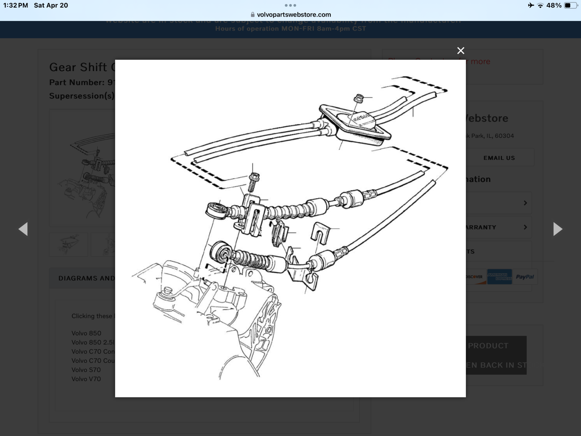

I think any 850 manual cables will also fit a 1999 based on the part number. .
Latest part number is 9176272 which superseded 6843404.

I think it got a kink in it somehow, that will break it fast

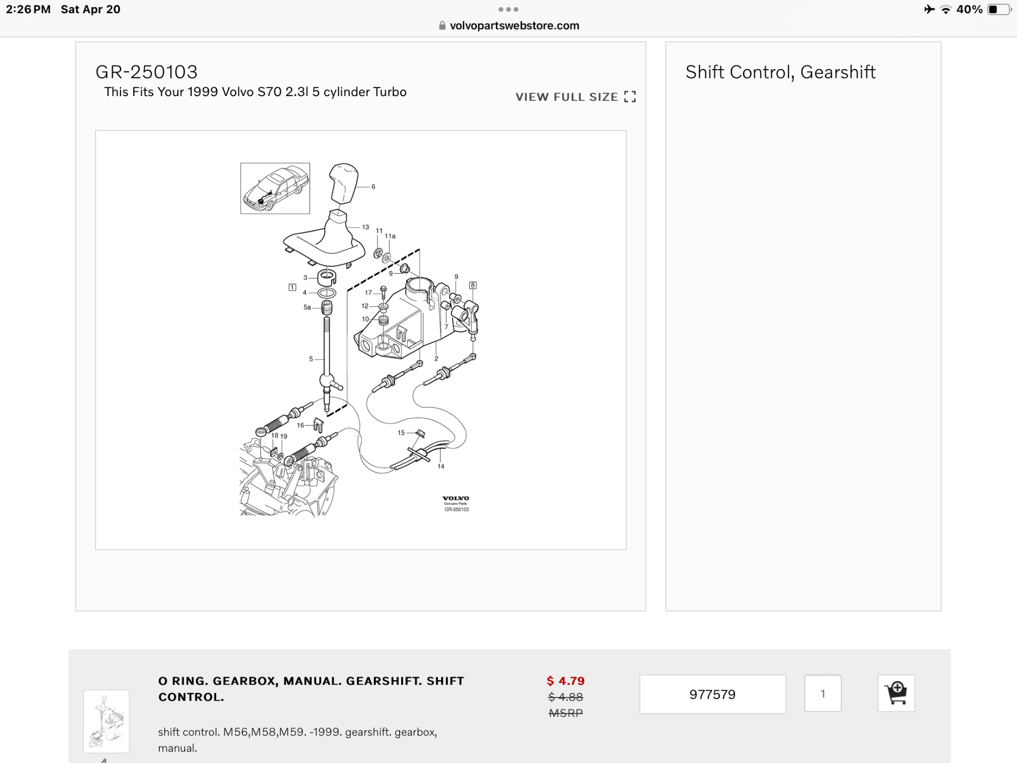

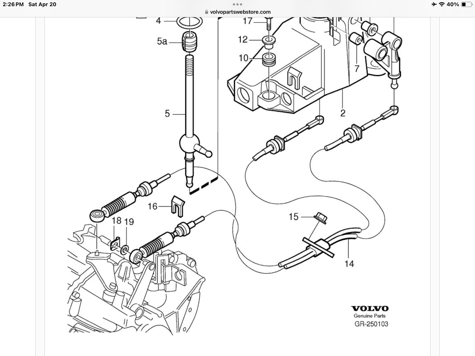

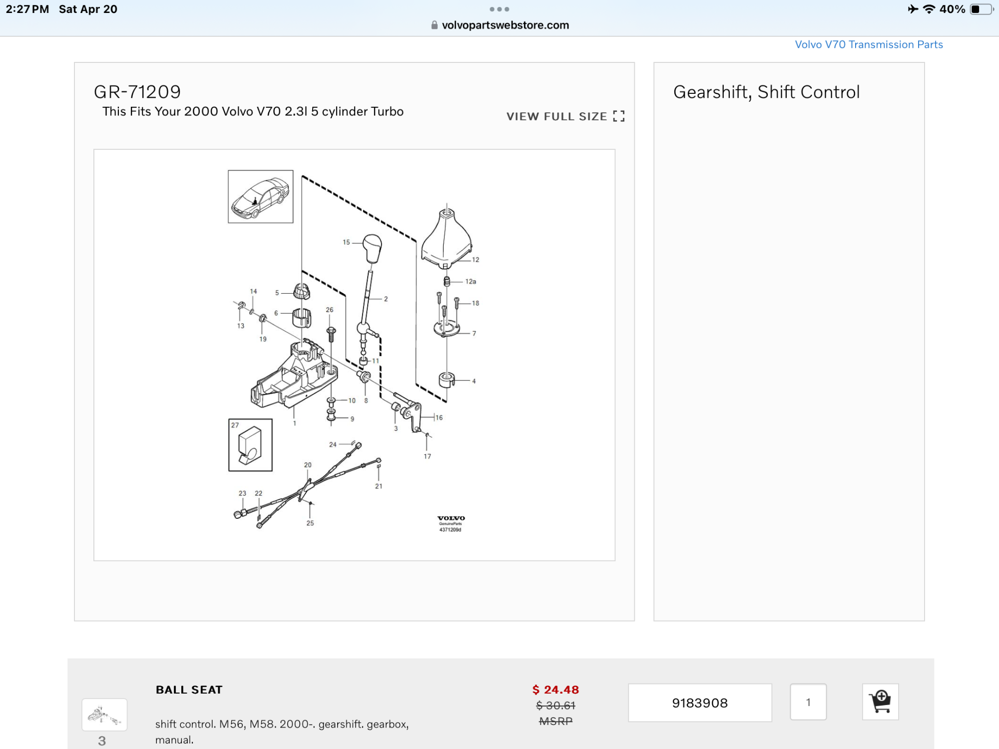

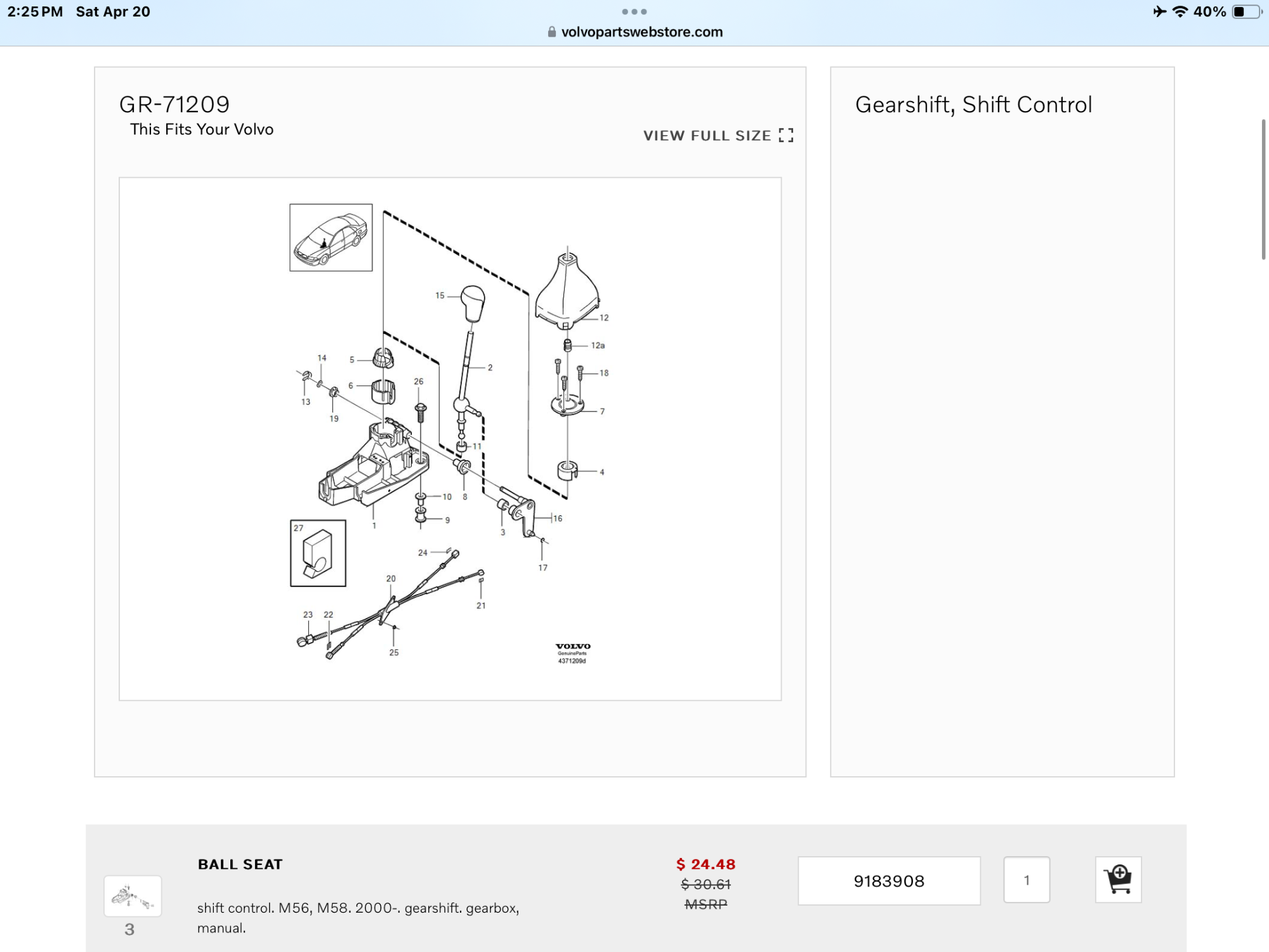

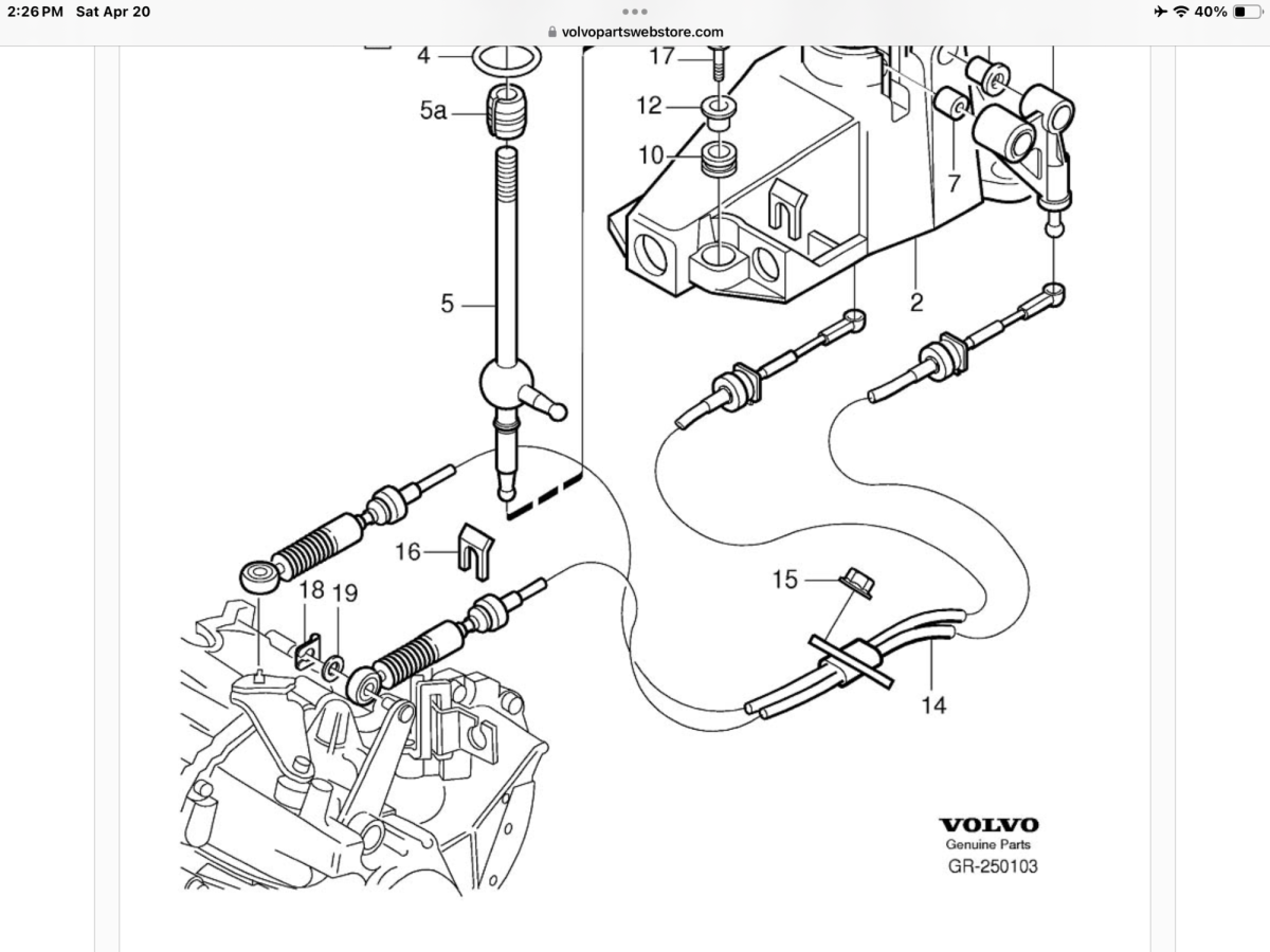

For anyone else reading this, it turns out that model year 2000 used a totally different shifter assembly and therefore used different cables as far as I can tell.
part numbers (9176272,6843404) for 1999 s70 as well as many of the later 850s
part numbers 8689482/9463500 for 2000

Here are the -1999 and -2000 controls
