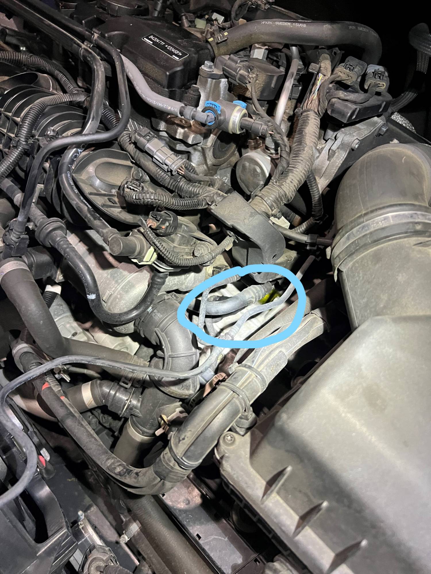

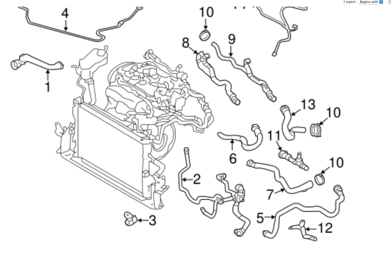

Please help identify this hose leaking coolant. I believe it is part number 31368661 but was hoping someone could help confirm. I've been looking at the parts diagram for a while now and cannot make heads or tails of it. It may have an attached 90 degree plastic connector (somewhat visible in second photo) which may be part of the assembly. I've seen part no. 31319215 online, which has a connector, but that one doesn't seem to make a hard 90-degree turn.
I searched the forum before asking -- while new to this forum I have been on others for years -- just haven't had any major problems with my 2015 XC 70. Thanks in advance!

If you look here, https://www.volvocarsoempartsdirect.com ... -and-lines part# 31368661 maps to #7 in the diagram.
... which kinda looks like the right hose, but doesn't match your photo exactly... but the original hose part # has been superseded by 31368661. So it's pretty confusing and I can see why you posted this question.
If no one here offers any further advice, I'd buy the hose and when it comes in you'll know. Or if you get it at the dealer parts counter you'll be able to just compare it when you pop the hood in the parking lot. It's not very expensive at least.

Thank you very much! My local dealer parts counter is rather unhelpful so I really appreciate you taking the time to look at that.
