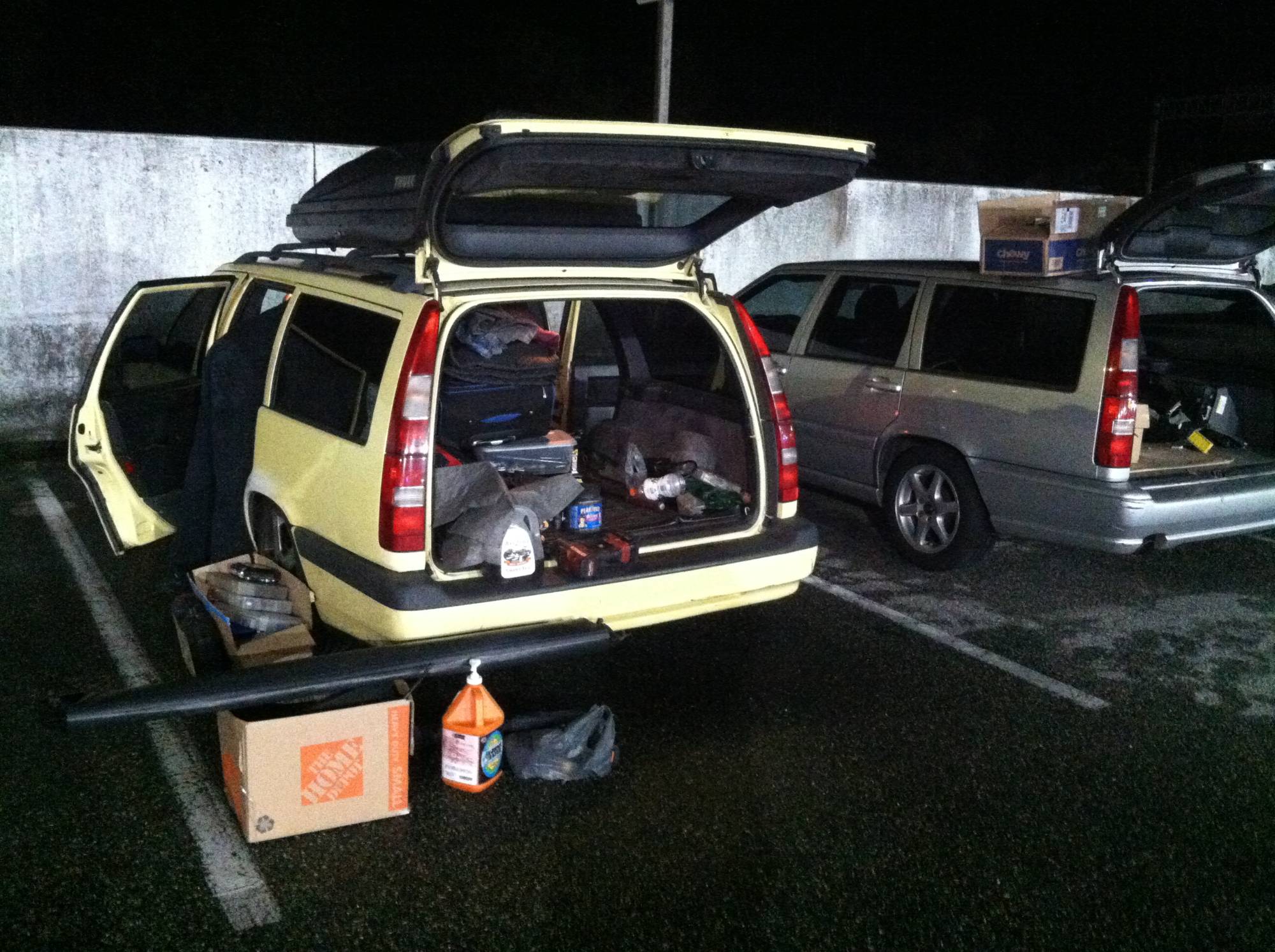

...time for a third Volvo turbo wagons then ?Clemens wrote: 24 Apr 2024, 03:54 because sometimes you have to get dirty, i decided to do the serpentine belt ans tensioner on my 94 T5, niticed that the timing belt was oily, found out that my front cam seals seem to be wet (and hope they are the source for the oil running down the front of the motor). Had to order stuff. And while waiting i finally started pulling the oil cooler lines on my 96R. Now I have two non-funct Volvo Turbo wagons. I am waiting for RTV to arrive so I can hopefully put the R back together without too much fuss.

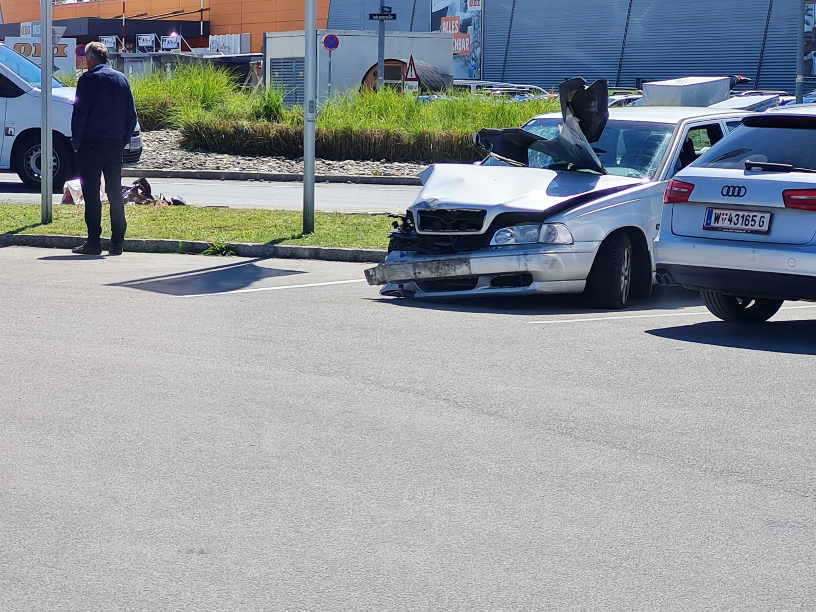

This made me very sad today. Fortunately not mine, but that stupid Landrover ripped that poor S70 up beyond repair. Right fender and control arm literally ripped out of the car. It was a very well kept care of vehicle. I'd seen it around town occasionally.

That’s a sad mess of an S70

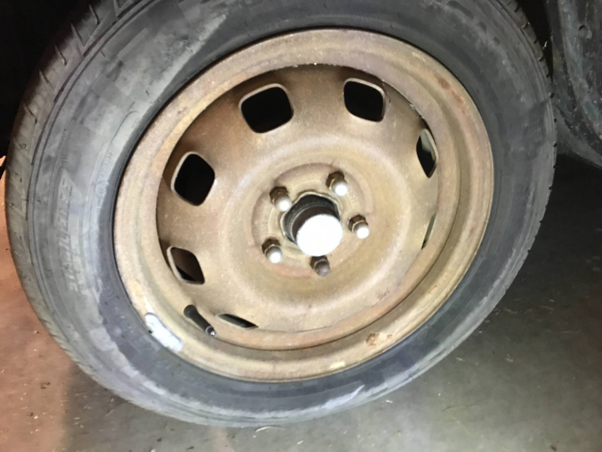

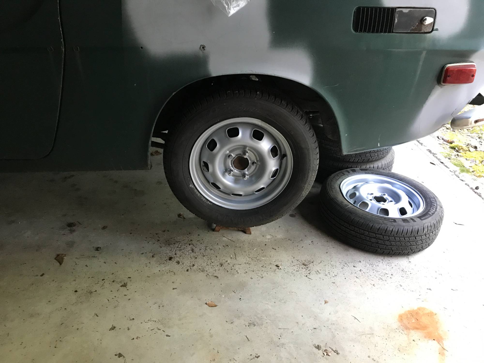

Finally freed up the funds to visit Powder Coat
