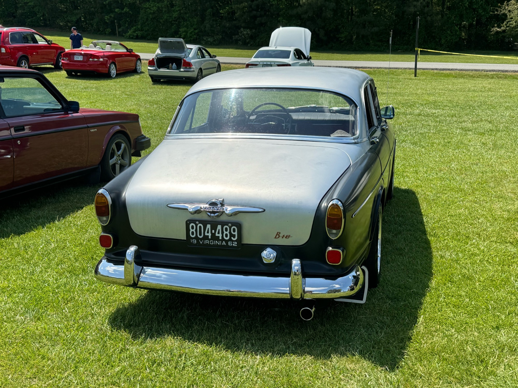

I installed the M41 three weeks ago and installed a new dash amongst a bunch of small things. The trans is shifting great and the J Type OD is kicking in and out smooth. I took old Leo to the Richmond VA Swedes (RVASwedes) car show today and he got awarded the Fan Favorite award and tied for best interior, but a recount will happen. Lol
