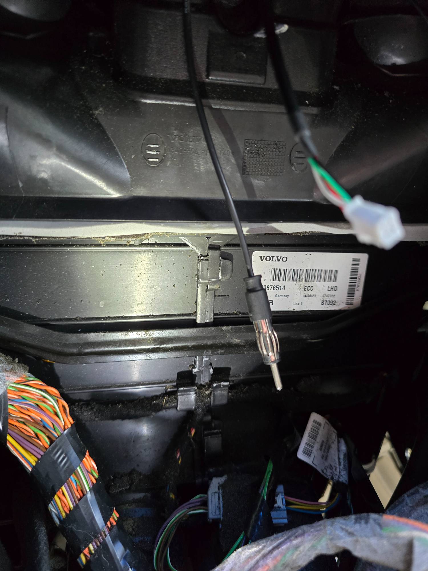

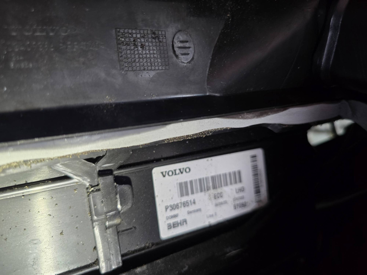

The saga continues. I've been try to troubleshoot my xc90 climate system. The driver side alway has less airflow and is 10 degrees warmer than the passenger side. I've verified the blend doors are working correctly. I also discovered a gap in the hvac housing behind the radio that was causing significant air loss due to crumbling foam gaskets. I shoved a bunch of weather stripping in there which helped greatly with airflow. I still cannot figure out the difference in temperature.
