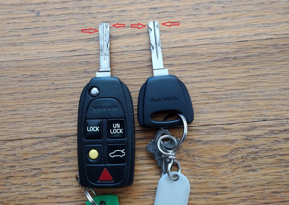

So, I learned something new...after parking the car at the airport for 2 weeks with the
ground cable disconnected, I could NOT open the trunk using the basic key...
BTW, I have a spare battery sitting on the garage floor and I can tell you that the battery
still has 12.5V after 2-4 weeks sitting there unattached to any device. I cannot say the
same with a battery in a car (attached) bc of parasitic drain.
I usually d/c the ground cable at the airport, simply bc I don't want to deal with dead battery
on my return from the trip.
Of course the options are:
1. With a donor battery, jump the underhood terminals so you can get 12V.
2. Use a coat hanger with a hook to pull the emergency release (from the rear seat area).
I think the law says any vehicle made after 2001 or so must have emergency trunk release.
3. Use the full-service key.
This idea is funny bc even the basic key can open the trunk as long as battery is good. If the
shop mechanic wants to access the trunk using the basic key, turn the key in igntion to position I.
Hit the "lock-unlock" button x 2 on the master switch area.
Walk to the back of the car and squeeze the rubber pad to open the trunk (assuming the wire loom
that feeds the trunk latch is not damaged)!
So this idea (different keys) is only true for the glove box contents.
If you look at the photo, you can see that the difference is at the tips of the keys...
