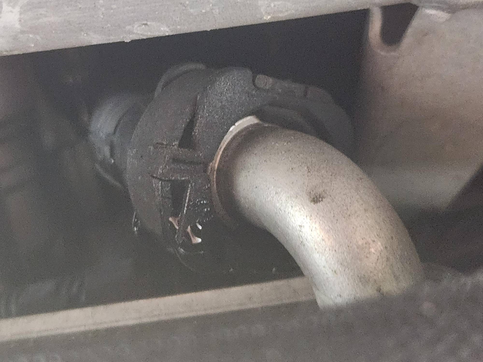

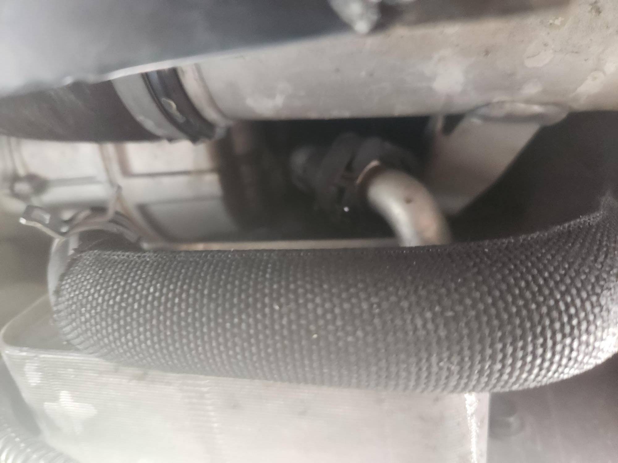

The oil cooler attaches to the oil pan and has two lines that connect to the front. If you were at the front of the car and facing the engine, there is a curved/bent connection on the upper right corner. What is the name of that line that attaches to that port and what does it connect to?
I attached the best picture that I could, but I have a very bad coolant leak coming from that line.

That looks like the transmission oil cooler line. Not sure if the line is bad or it is just an o-ring leaking and it can be replaced.
https://www.volvocarstorontoparts.ca/a/ ... 83898.html
I guessed which engine was in your car. But you can go in and change it. I don't see a replaceable seal here. Canadian $$ prices.
