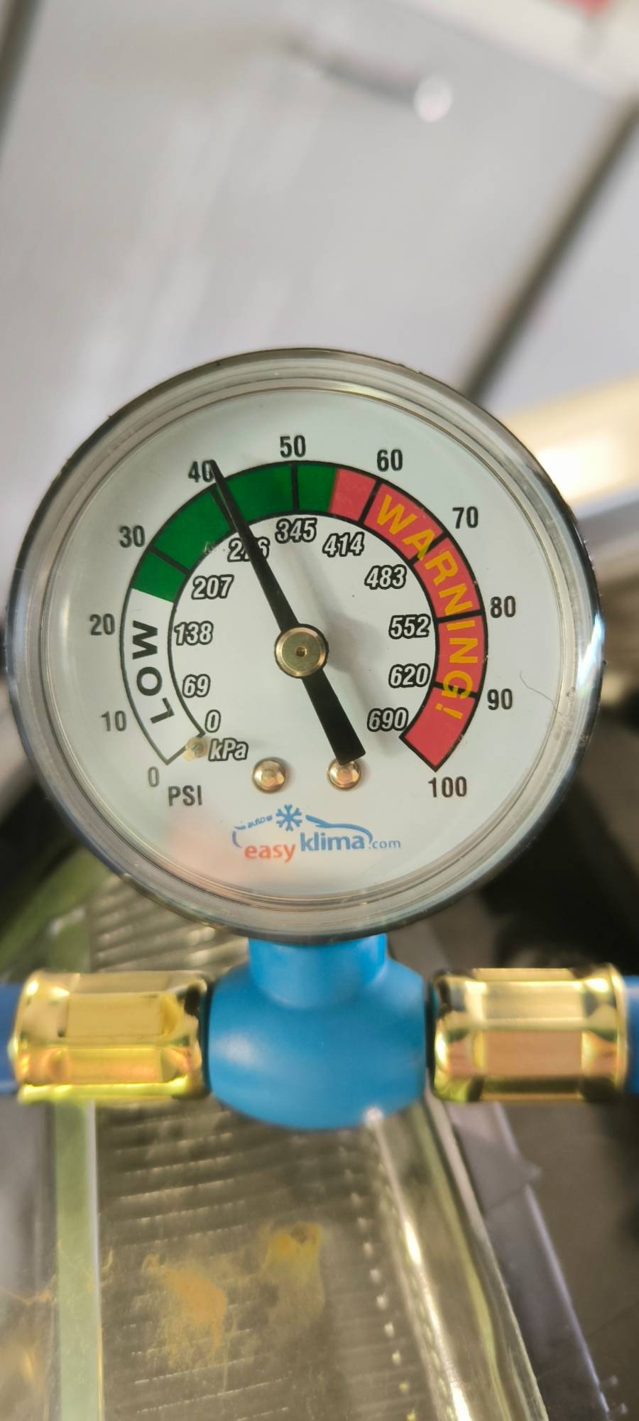

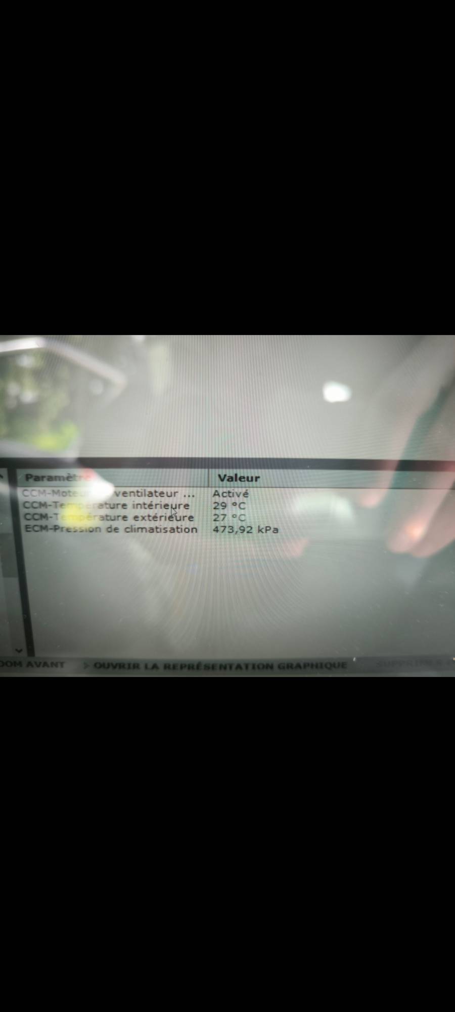

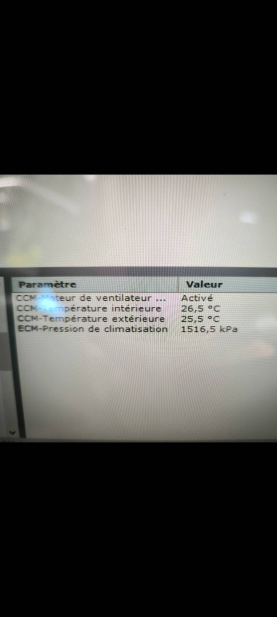

Here are m'y pressure values;
AT the charge port, compresser On:
AT idle, compresser off:
AT idle, compresser on:
Do you think i have too much gas?
What should be the values AT 25°C (77°F)?
Thanks a lot i'm pretty sure my issue is linked to gas pressure but cannot find a certain value for it...
