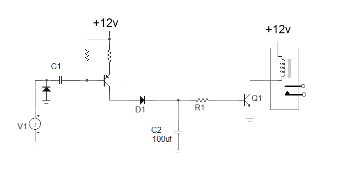

Hello again,
Well the entire circuit came out even simpler than I thought at first. I had "two relays" stuck in my head because I thought of just using two relays at first, but then using one transistor with just one relay works also.
This can be considered a preliminary circuit which would need to be examined carefully, and of course some of the values to be determined yet.
The main issues are driving the relay of course, and making sure the relay will turn off with loss of ECU signal, and making sure not to tax the ECU output pin. BTW the ECU signal is shown as "V1" in the schematic.
This was a quick off the top of my head drawing so some modifications may still be needed. Functionally it should be the same however as long as the values are chosen correctly. This also provides at least some idea what is involved using more discrete parts.
Disclaimer:
You do have to realize that if you build this circuit and install it in your car it may void the warrantee.
Disclaimer:
- FuelPumpRelayAlternate_20240617_062835.png (12.81 KiB) Viewed 703 times

The theory behind my suggestion is to say
take the broken fuel pump relay to make a simple harness with a universal relay, and another discrete universal component that would take the ECU signal and control the relay that way.
Would you know if the ECU ends a signal in Pos II to prime the engine? Mainly I want to determine if the priming delay and the crash safety cutoff are the same circuit, in which case some sort of timer/delay component would suffice, something that would cut power after 4 seconds for instance. Off the top of my head it would be along the same lines as interior light delayed shutoff circuits.
