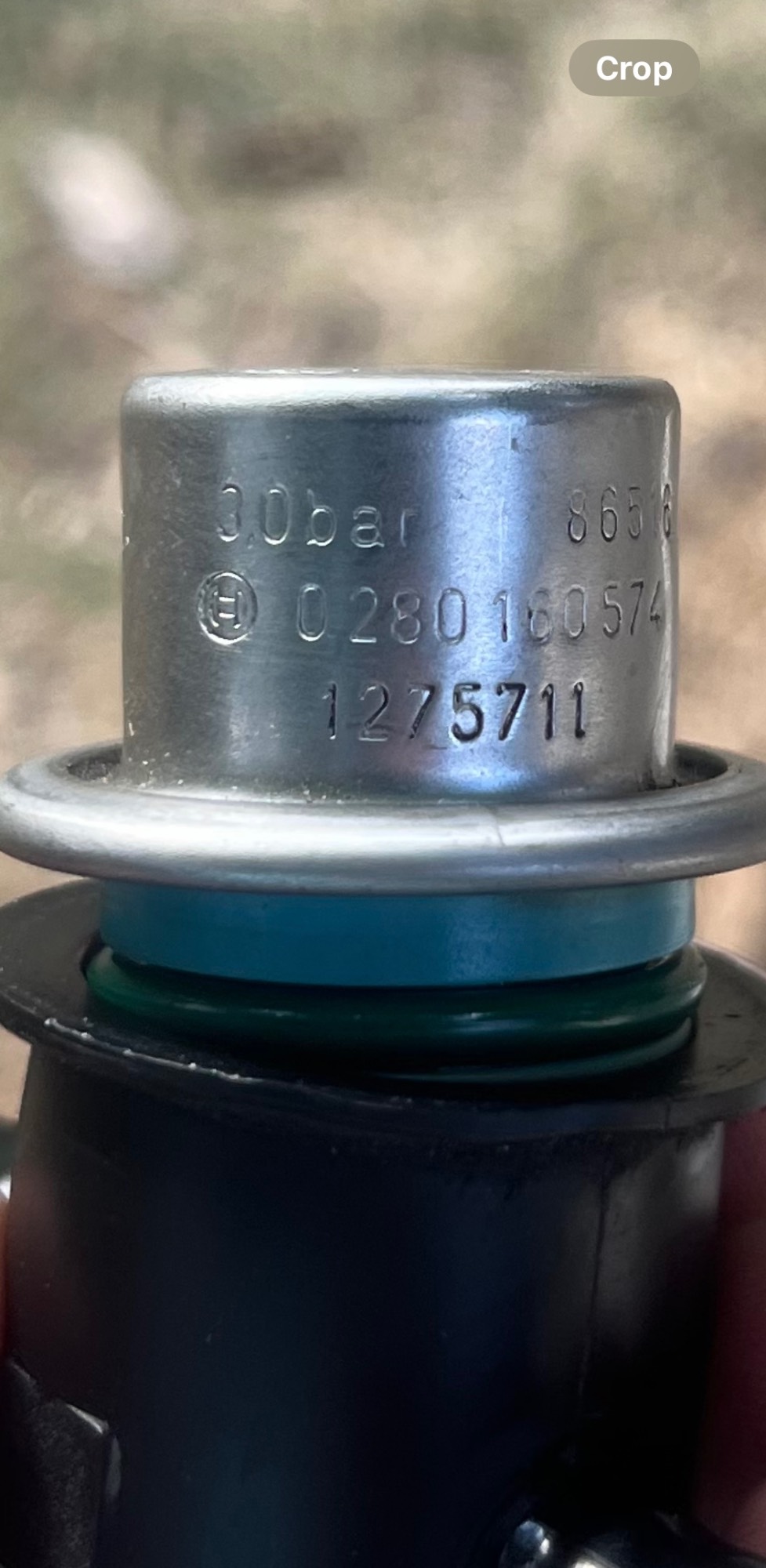

Post by coop »
Did you find a solution to this?
I’m trying to replace Volvo part 1275711 3.0 bar Bosch fuel pressure regulator. I went to the junkyard and snagged another housing and unit.
Looks like I’ve found some stock in Europe and waiting on shipping quotes but doing some
But Bosch 0280160557 looks like a 3.0 bar unit and can be had for $20 so I’m looking twords that. I think I mistakenly read the t5s where at 3.8 bar and found one on a Mercedes at that pressure. So while at the junkyard pulled a few of those. They seem to fit in the volvo housing fine but I ordered new one at 3.8 bar which I’m now assuming is wrong and needed the unit off a Volkswagen
https://www.autohausaz.com/pn/0280160557
