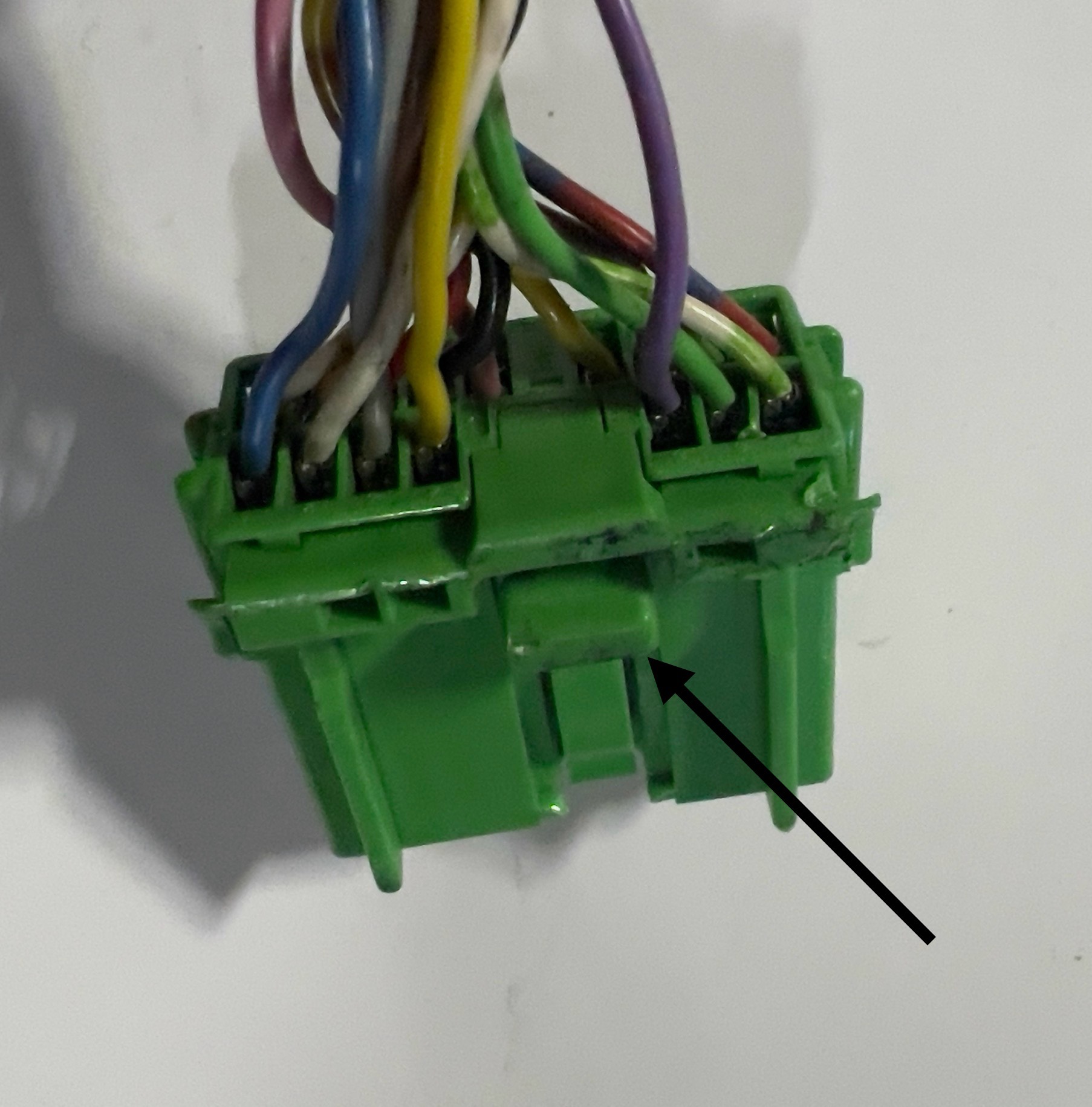

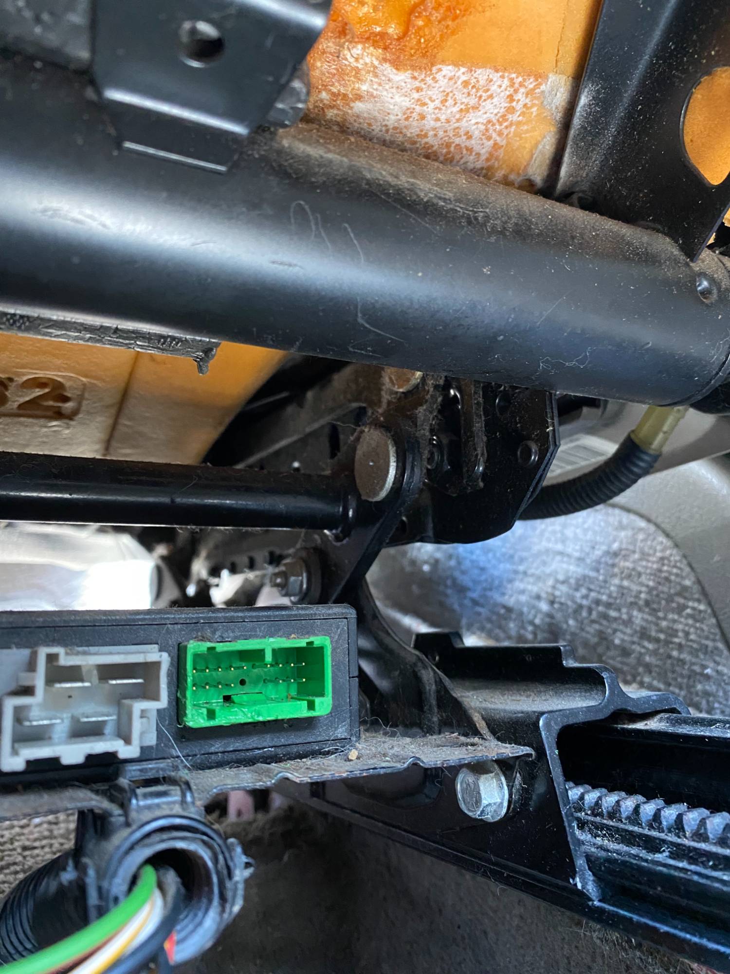

Robert has DIY videos for door panel removal, how to press on the latch to get the door to open. My door panel is loose, but
the front seat needs to come out. I have removed the four bolts holding it down, and have two of three connectors freed up now.
The last one (green) is stubborn. I tried prying on the sides with small Whia screwdrivers, but the attached photo makes me think
I should try to insert it on the top to press down on the tab holding the plug in. Will report back later if it worked.

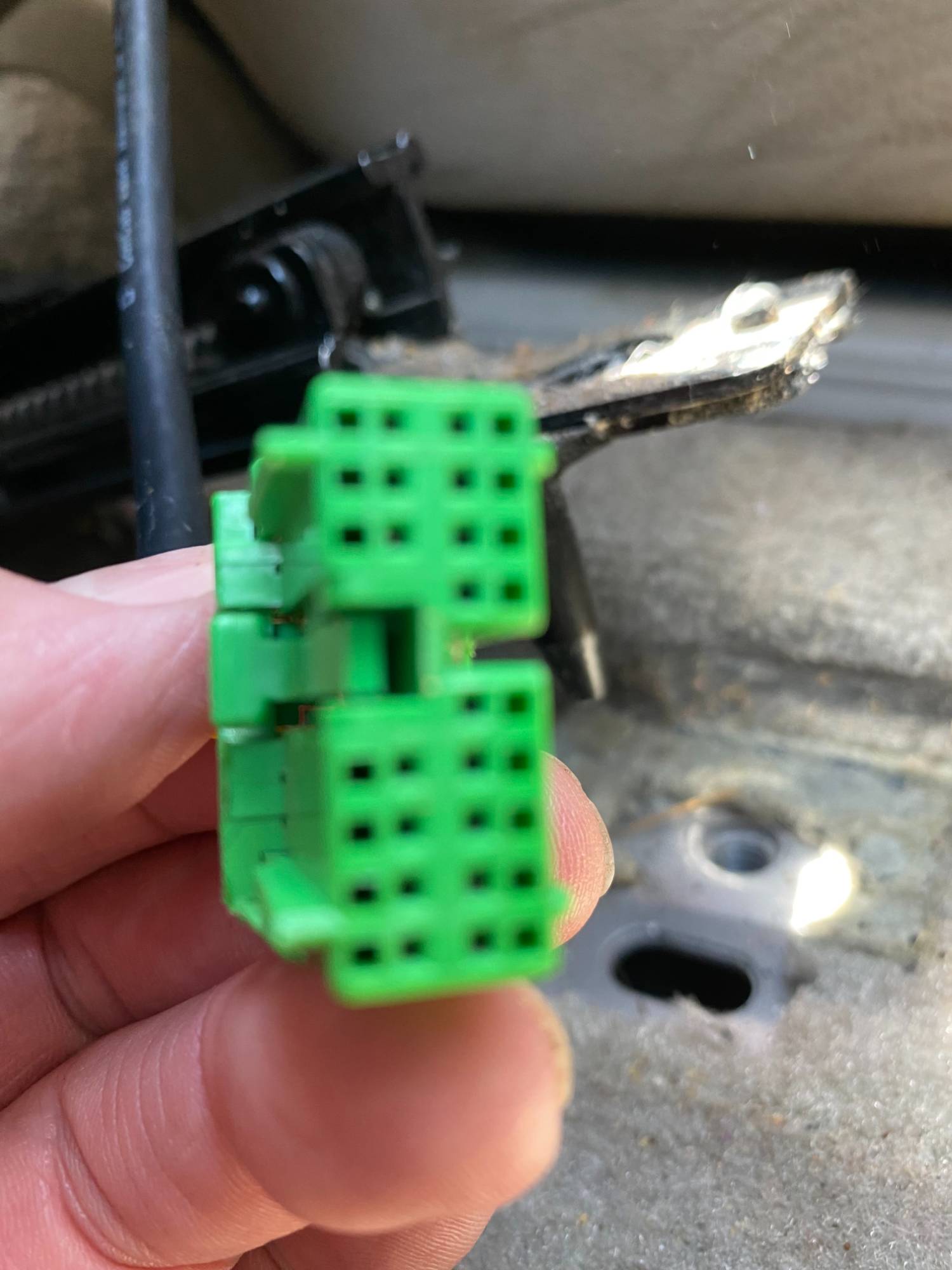

Can you take a picture at all of the other side of the connector? I can't recall if it disconnects on the other side.

It was just a piece of plastic peeling off. I still haven't figured out how to get this connector freed up.

There's a plastic tab on the bottom in the center. I wedge something between the connector and the metal box to get it to lift up so I can access the tab with a pair of pliers or my fingers if I can.

Here’s a photo of the connector. There is a tab on the bottom that needs to be pressed ‘up’ to release. NOT intuitive by looking at it.

Yay! The green connector came out when I pushed up the connector housing with another screwdriver, and then pushed on the tab in the center. It came right out.
