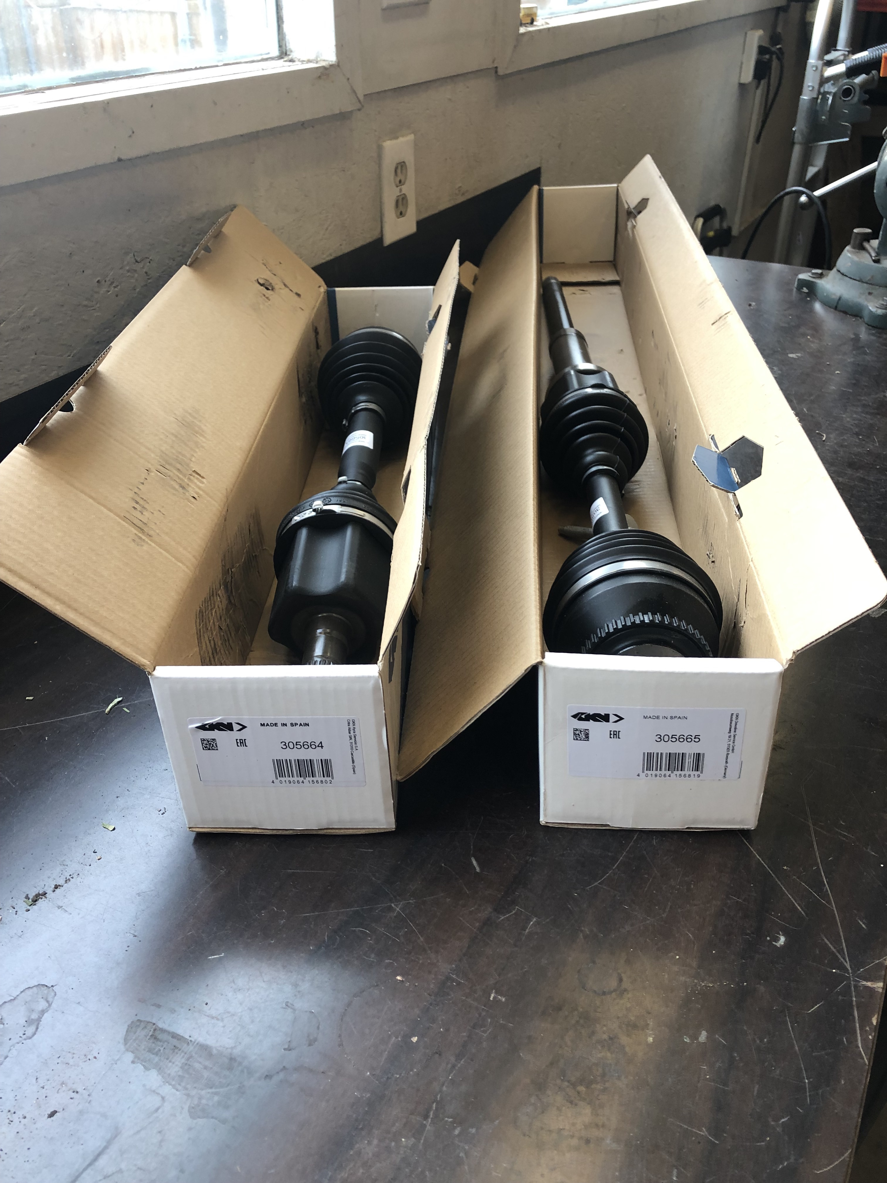

The new parts and the eager recipient!

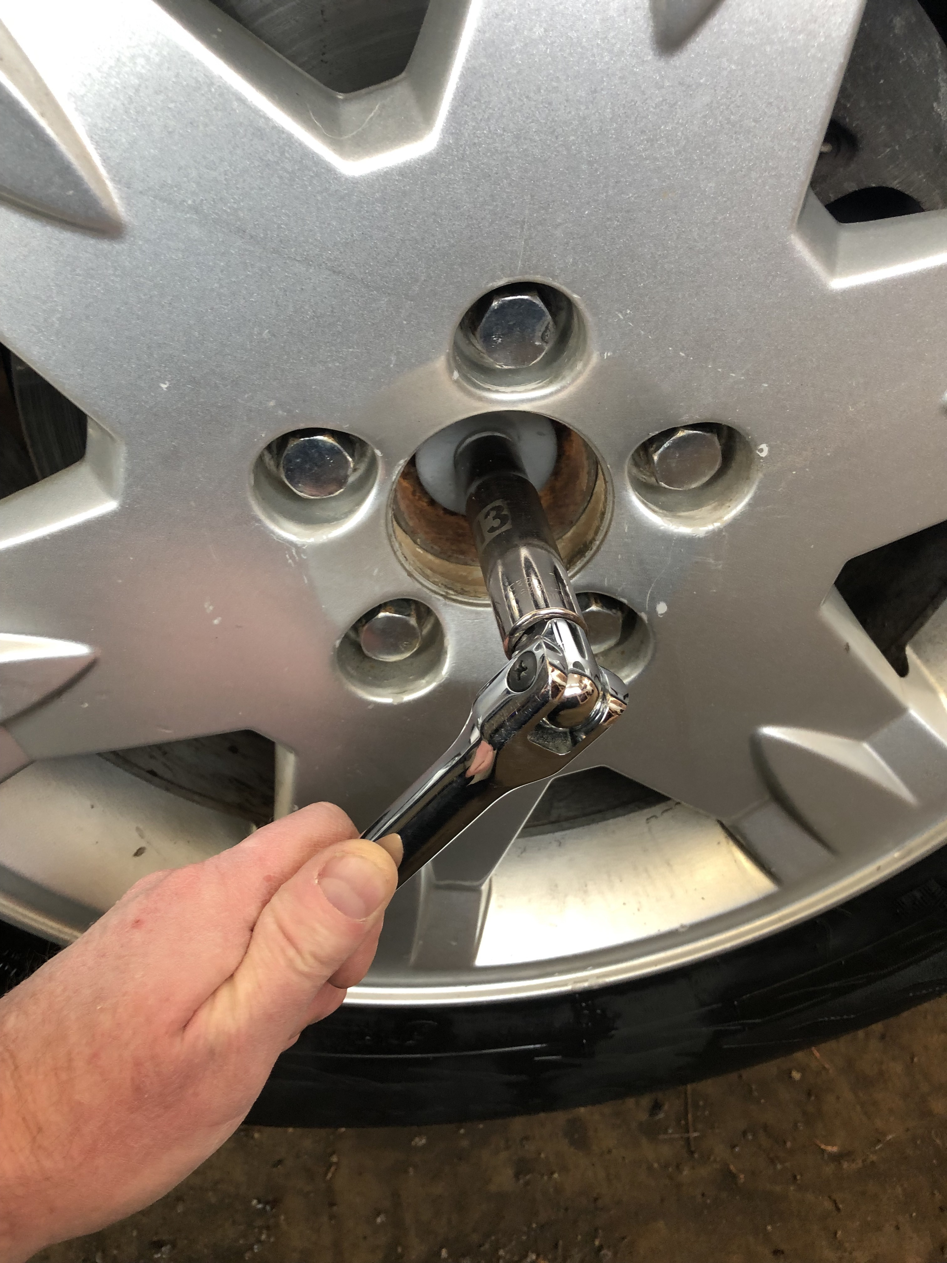

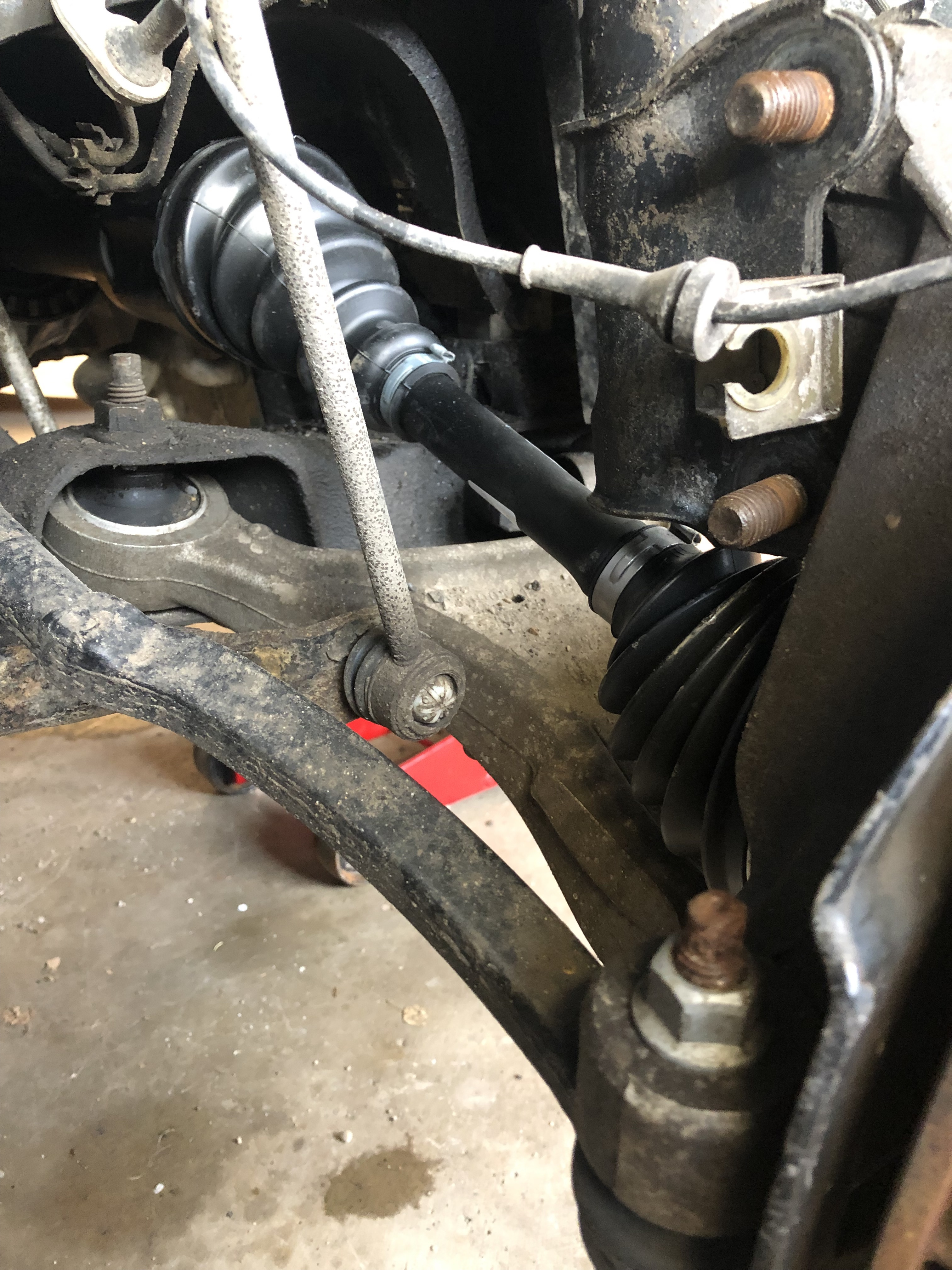

- Loosen lug bolts (19 mm) and axle bolts (13 mm), Then jack car up with the wheels at least 4 inches off the ground. Install at least 2 axle stand under the car. Remove wheels and put them under front of car for added safety.

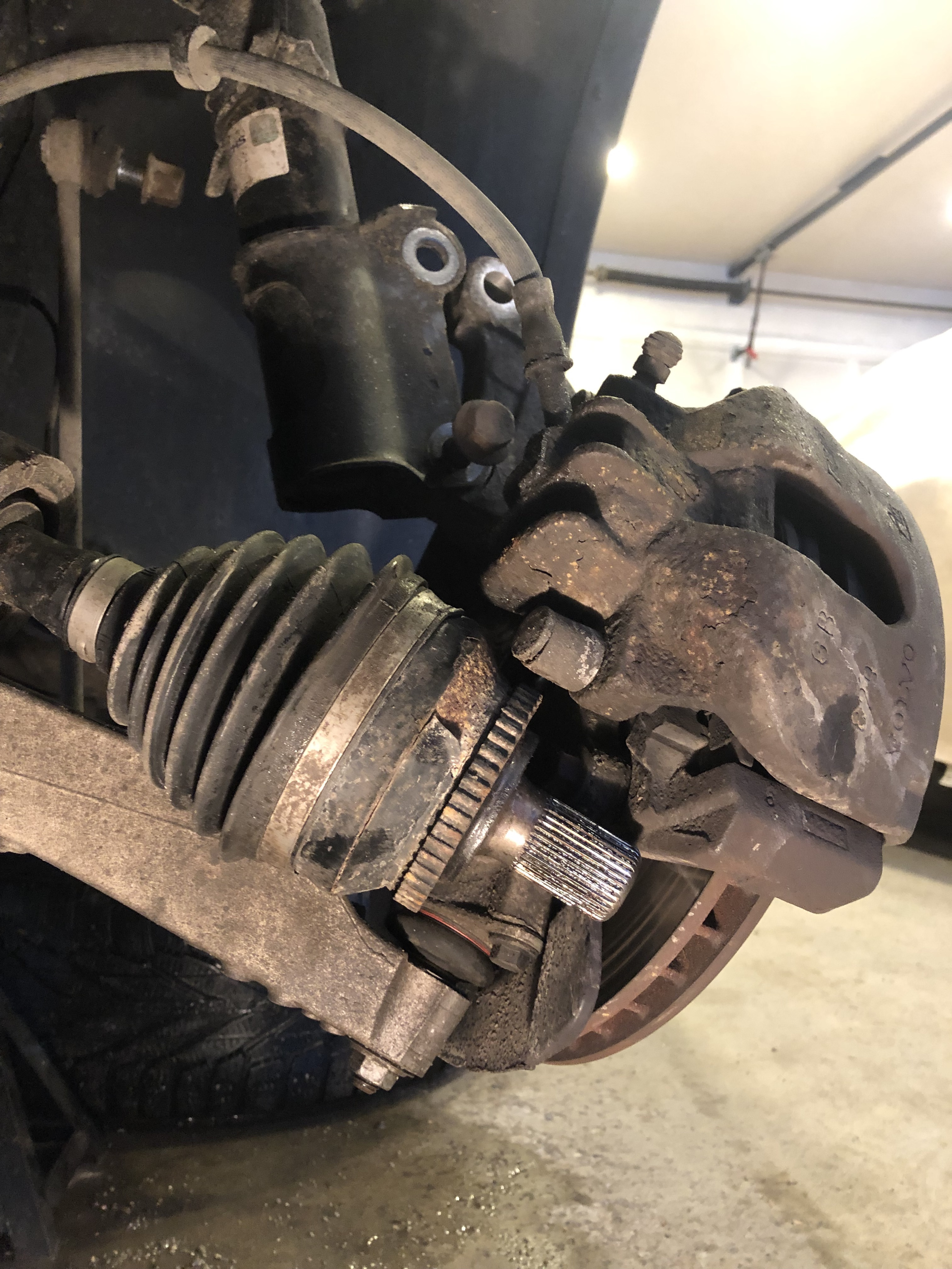

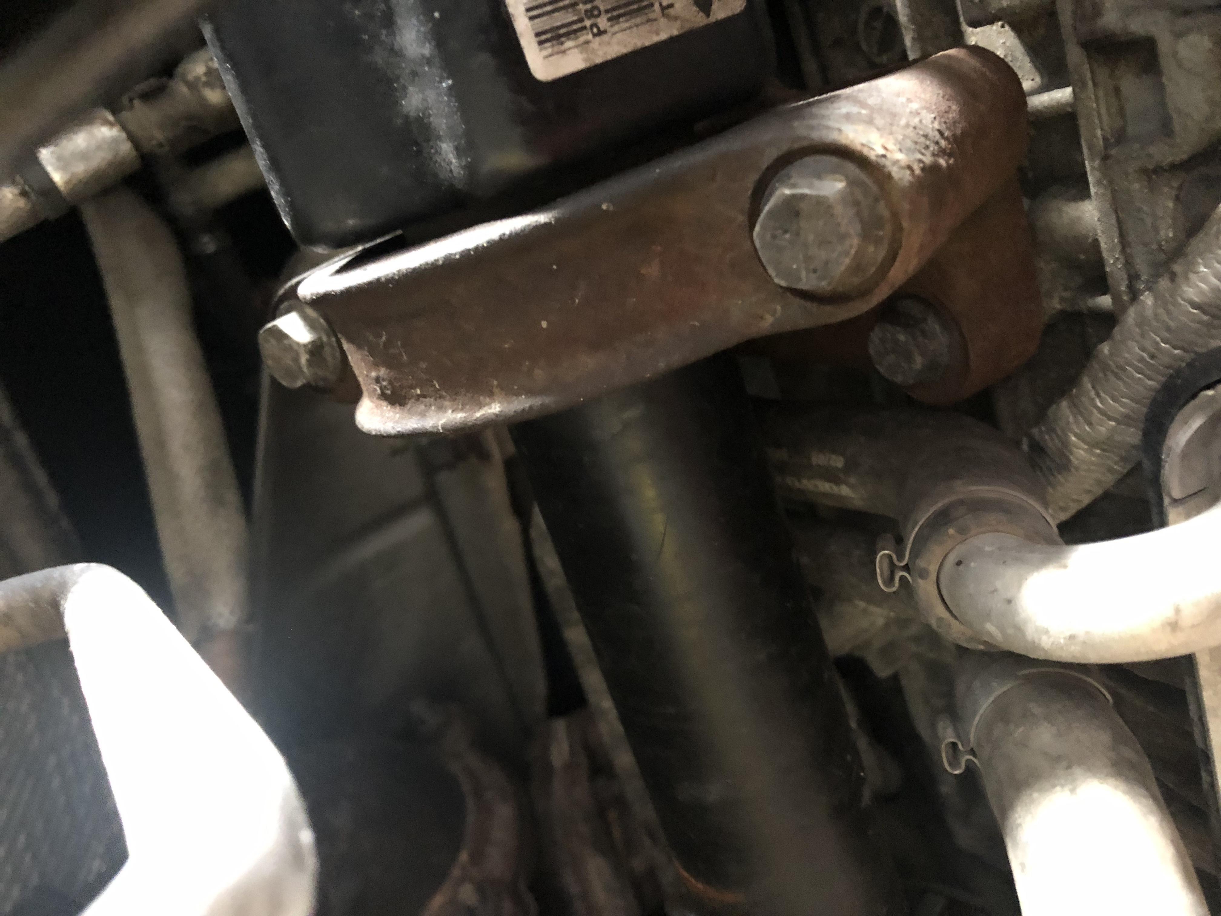

- Remove the strut to steering knuckle bolts (21 mm bolt, 18 mm nut) and the stabilizer link nut to strut attachment ( 18mm) on both sides. It's also a good idea to remove the ABS sensor in the knuckle (10 mm) and the ABS wire retainer on the strut, these 2 steps are not necessary but will help prevent inadvertent damage from removal and installation of the Axles.
- Remove two 12 mm bolts holding the axle carrier bearing retainer, then pop the retainer off if it doesn't come off on its own.
- Put the key in ignition so you can turn the wheel spindle as required to remove the old axles, push the axle stub through the steering knuckle, compressing the CV joint as you require. Passenger side: carefully remove the axle without damaging the seal in the bevel gear by pulling the axle straight out slowly.
- Install the new axle in the passenger side in the reverse sequence you removed the old one, reattach everything and retorque everything you removed. Congratulate yourself, you're half done..................sort of!

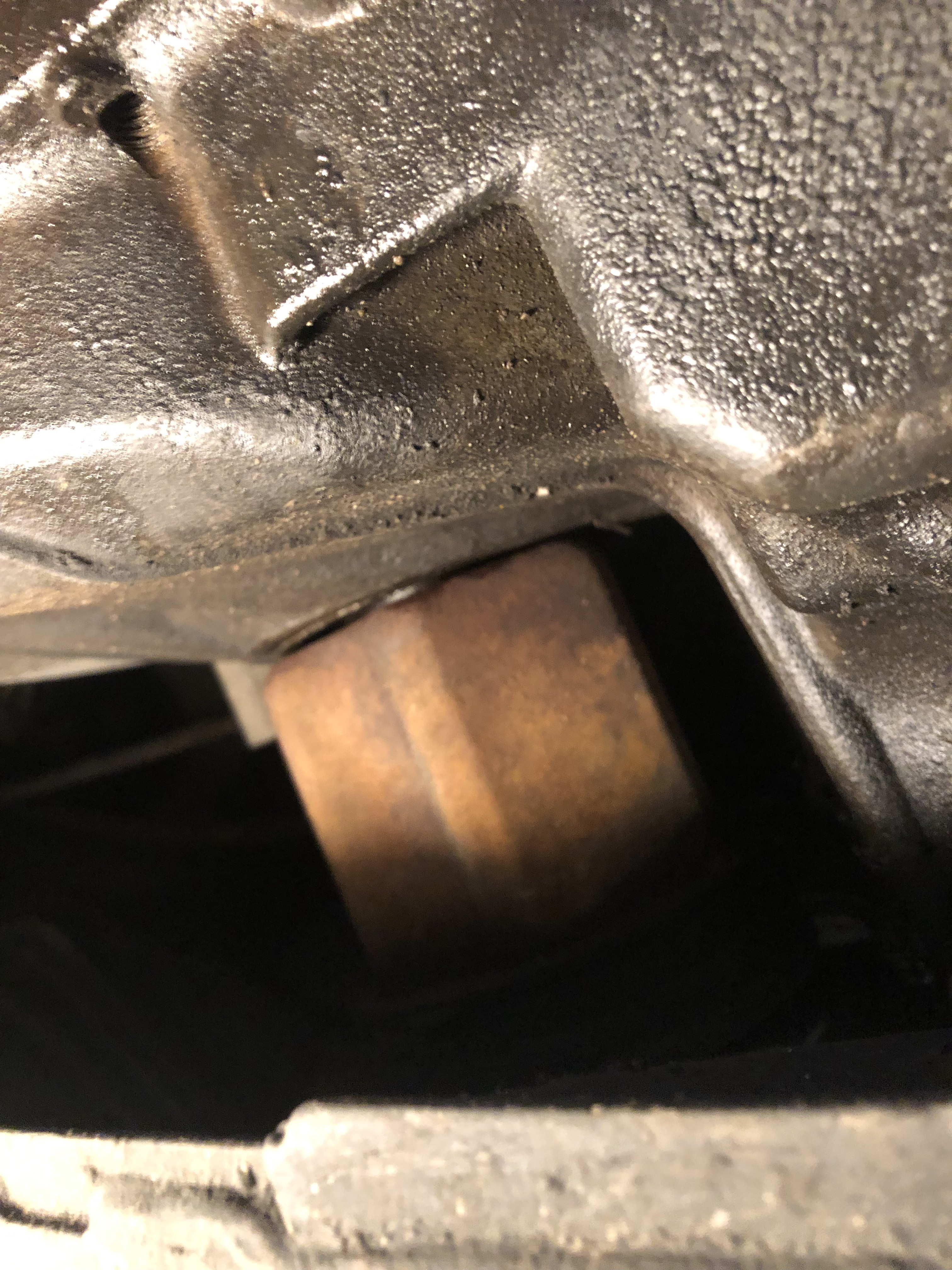

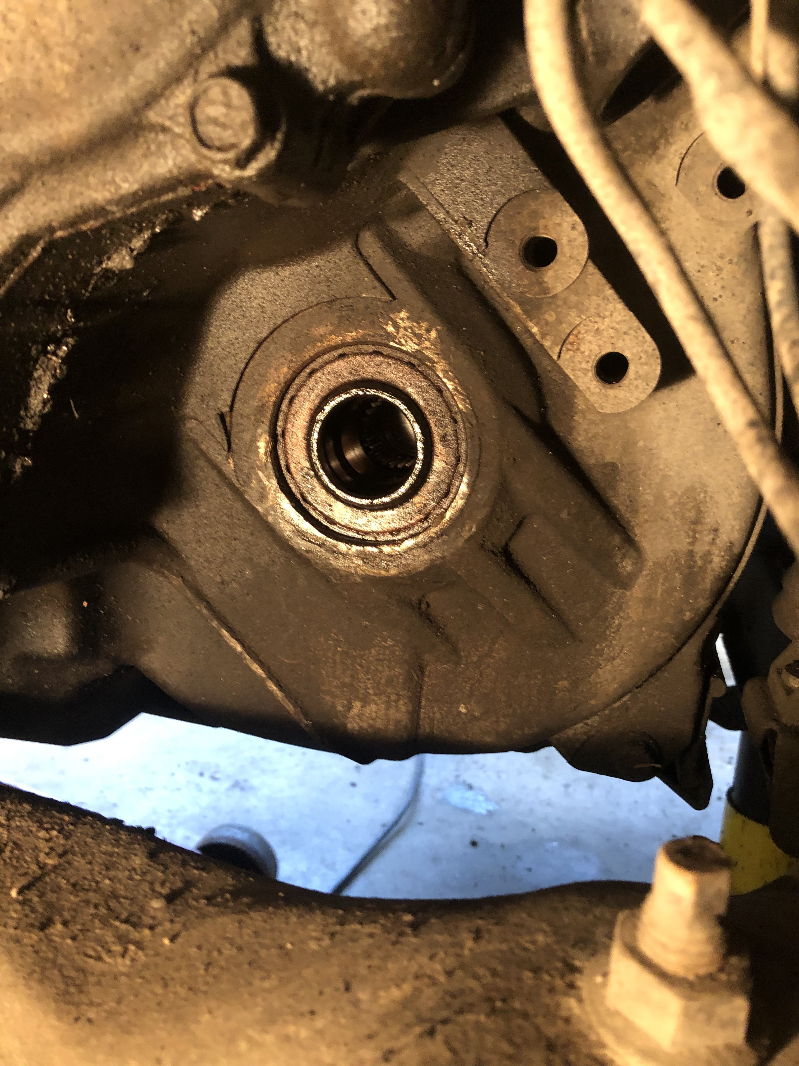

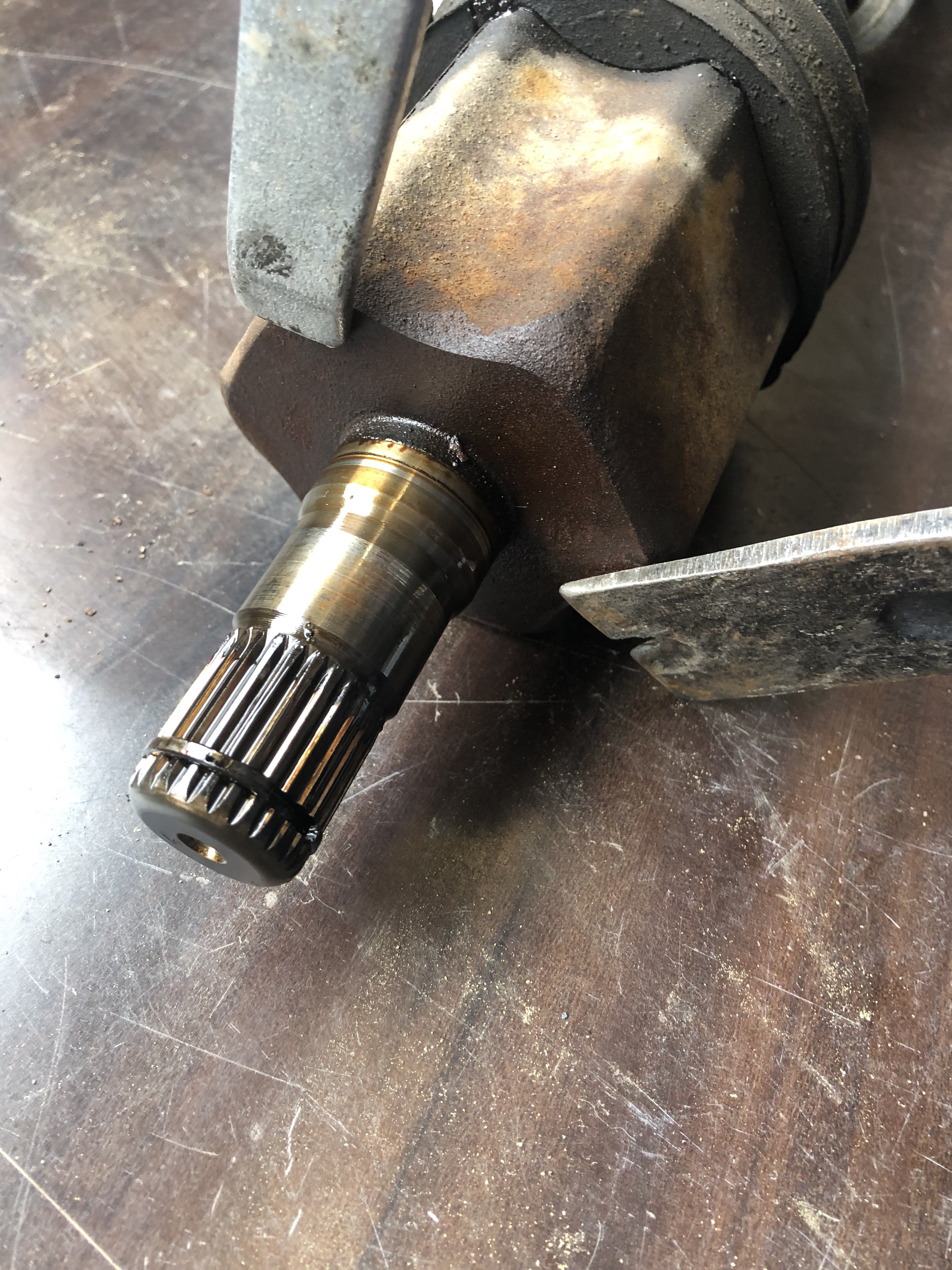

This is where some people have troubles, the inner spline fits into a dry hole in the transmission and includes a circlip retainer that gets rusty and binds in the spline bore. There is no way to get oil or WD 40 in there to aid in removal.
Mine is well coated in oil as I've replaced the original which was very rusty, make sure your replacement is well oiled when you install it in case you have to remove it again in the future.

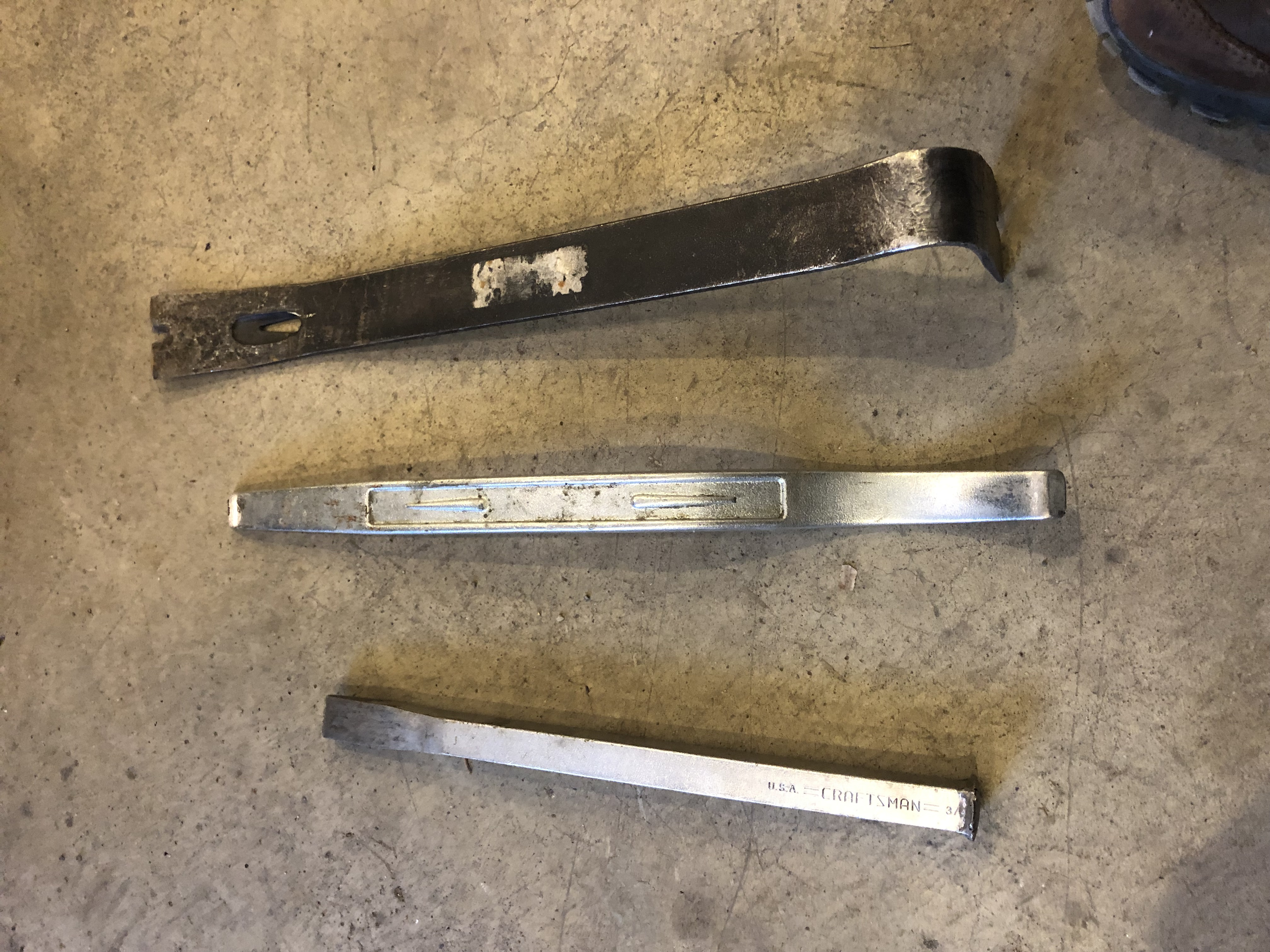

- Push the driver's side axle stub through the steering knuckle. Now crawl under the car with your prying tools, this is what I have used with good success.

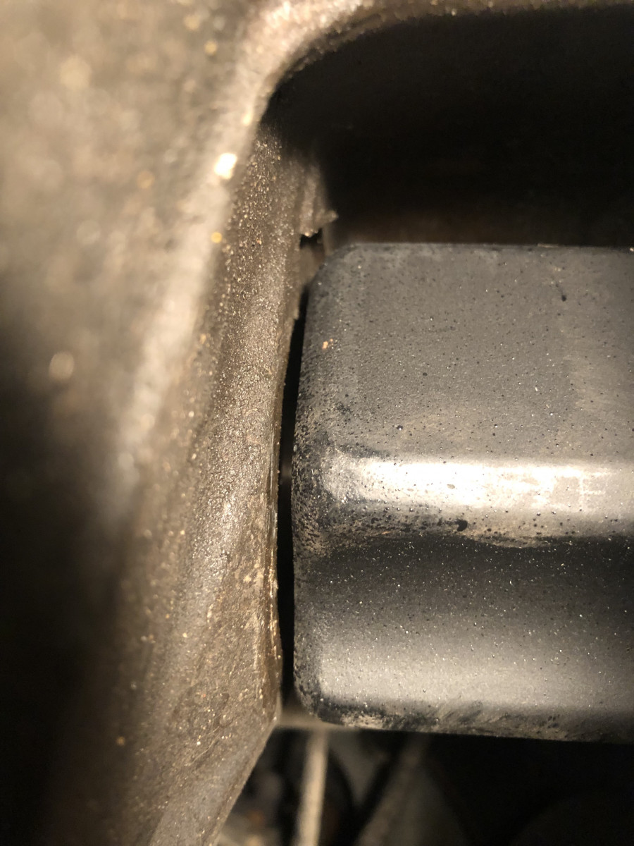

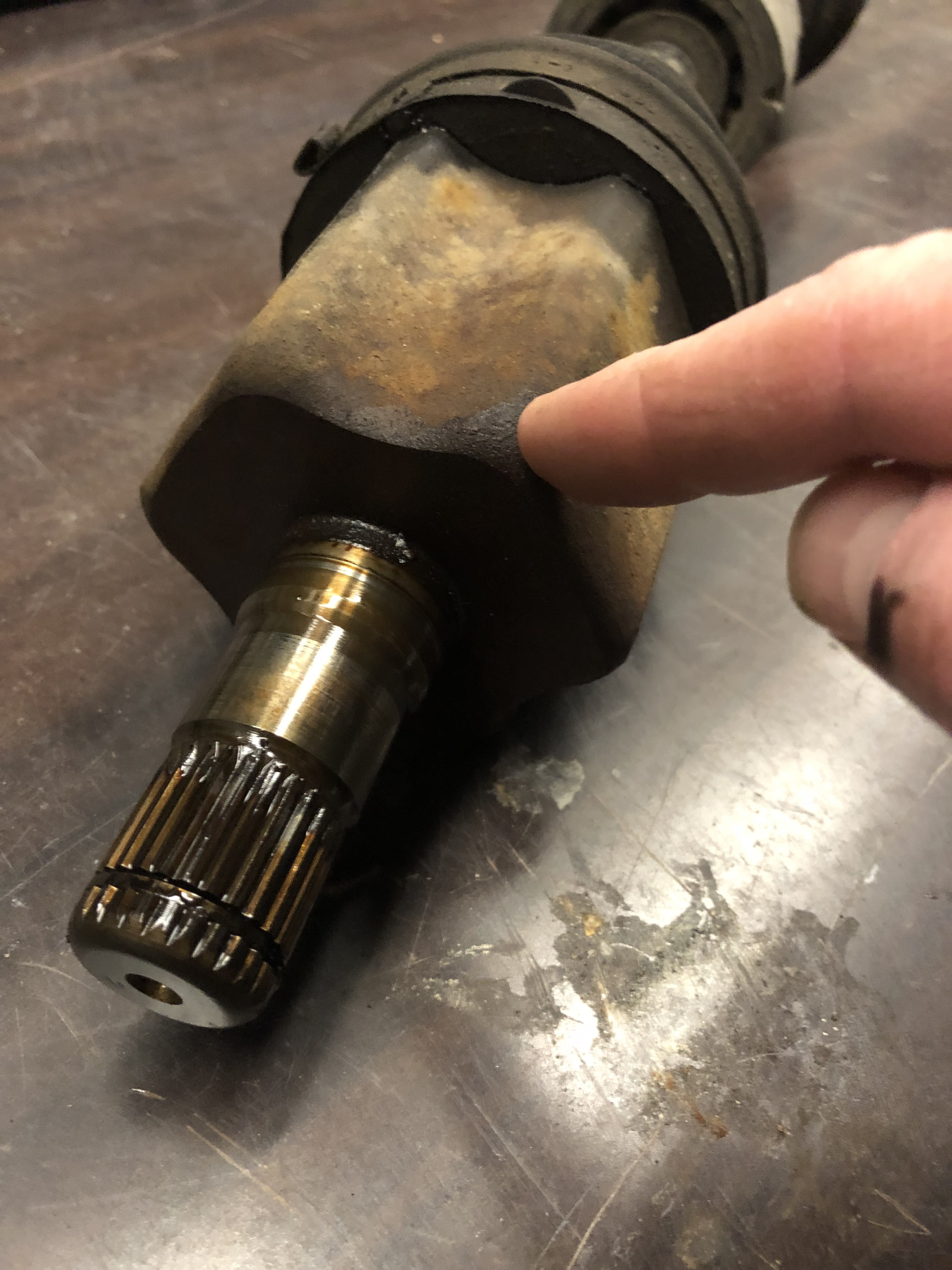

- Use a combination of two pry bars 60 degrees apart between the transmission housing and the axle housing, there's only 3 or 4 mm to get the prying devices between as shown below.
- Alternate pressure on the two prybars several times being careful to not damage the transmission case. If it doesn't pop out, rotate the axle and pry in two places and try again. You should be prying on two of the six "knobs" of the axle housing as shown in the picture below:
Keep doing this until the axle pops out, use your discretion on how hard to pry without damaging the aluminum case, in my experience its more about technique rather than force, use 2 prybars and continue to pry and rotate until you find the magic spot and it pops out.
Install the new shaft in the transmission, this will require a good push to get the new circlip to seat. Grasp the CV housing with both hands as close to the transmission as you can and give it a good slam until you can feel it seat, you'll want to make sure it is straight in the bore before you slam it in. It should look like this:

Spend good money and get good axles! This job took me 1 hour and 35 minutes with hand tools taking pictures along the way. Why so fast?.............because this is the fourth time I've done it due to poor quality parts, this time I went with genuine GKN axles. Good luck!

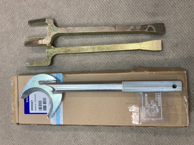

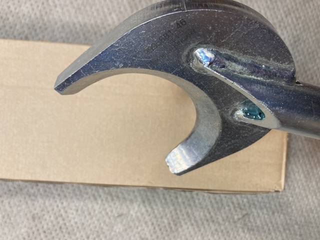

I have a couple new tools that have been nice to use. If anyone is apprehensive, fearful or struggling with the drivers side (or rear CV axles), you can borrow my tools. I also have the special ball joint installer/tool, free to borrow as well. Just pay shipping both ways & return undamaged.
Steck Manufacturing axle popper 71410 (Amazon is about $50-55): https://steckmfg.com/product/71410_axle ... -shim-kit/
Volvo tool is part number 9995681. I did not purchase from the following link.
https://www.freedomracing.com/9995681-d ... -tool.html
