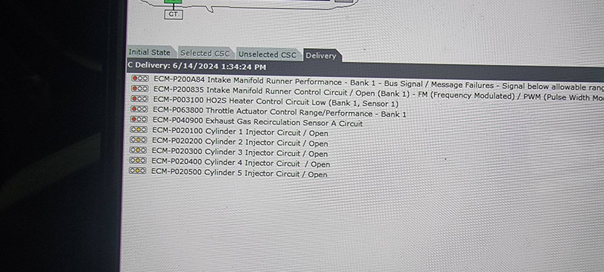

ECM-P003100 HO2S Heater Control Circuit Low comes up immediately (don't think this would prevent starting?)
After cranking I get additional codes:-
ECM-P200A84 Intake Manifold Runner Performance...
ECM-P200835 Intake Manifold Runner Control Circuit / Open..
ECM-P063800 Trottle Actuator Control Range/Performance
ECM-P040900 EGR Sensor
and further cranking
ECM-P020100/200/300/400/500 (all injectors open circuit faults)

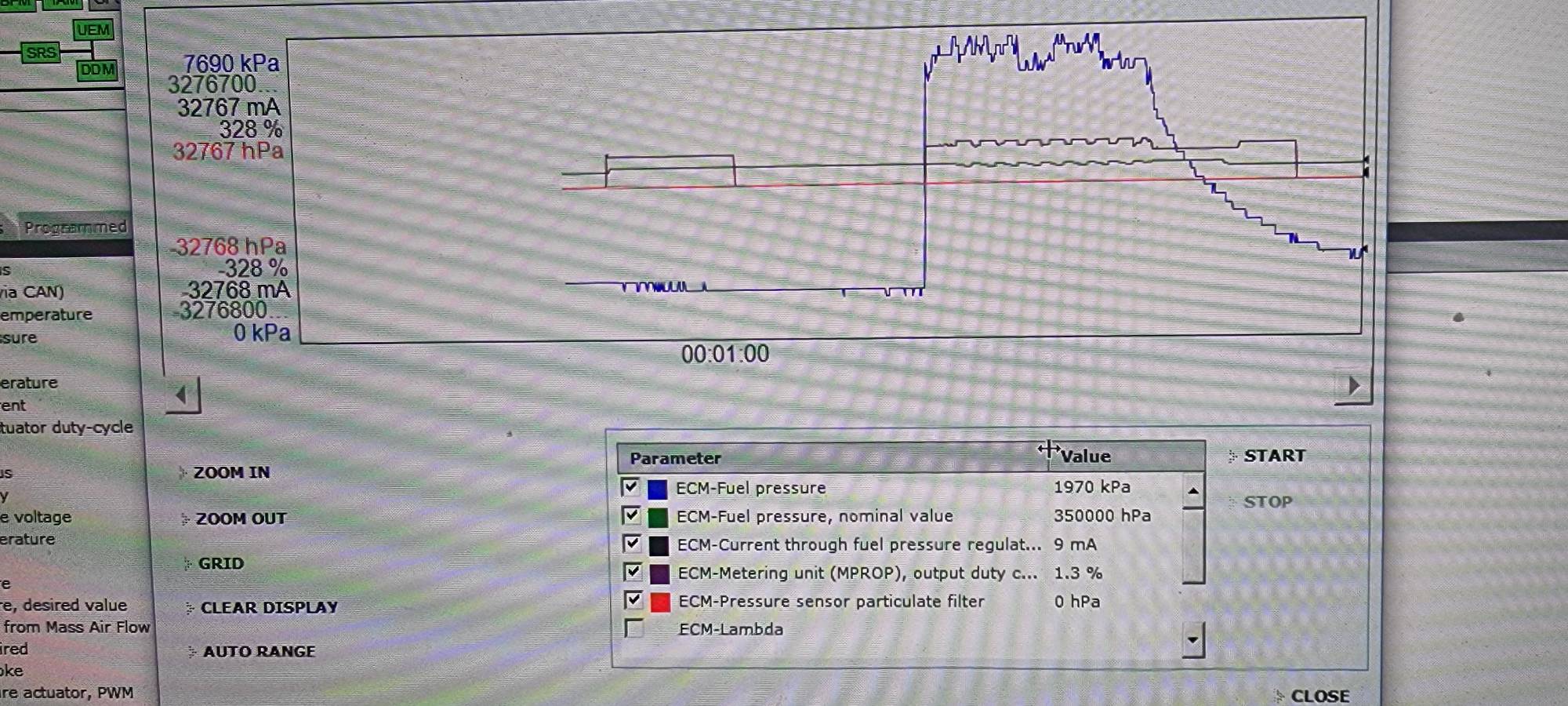

Vida shows following readings when cranking
ECM Fuel Pressure : 7690 kPa
ECM Fuel Pressure, nom value : 357670 hPa
ECM current through fuel pressure reg : 9ma - This is very low
ECM Metering unit MPROP output duty cycle : 95%
I bought a S/H rail to try plug in a reg valve to see if I can get more than 9mA - but not change
It looks like I am getting the correct high pressure to the rail but seems the injectors are not firing........
Why are all these other sensors throwing faults??
I am suspecting my ECM is at fault - any thoughts?
