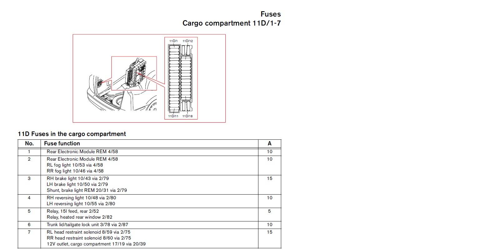

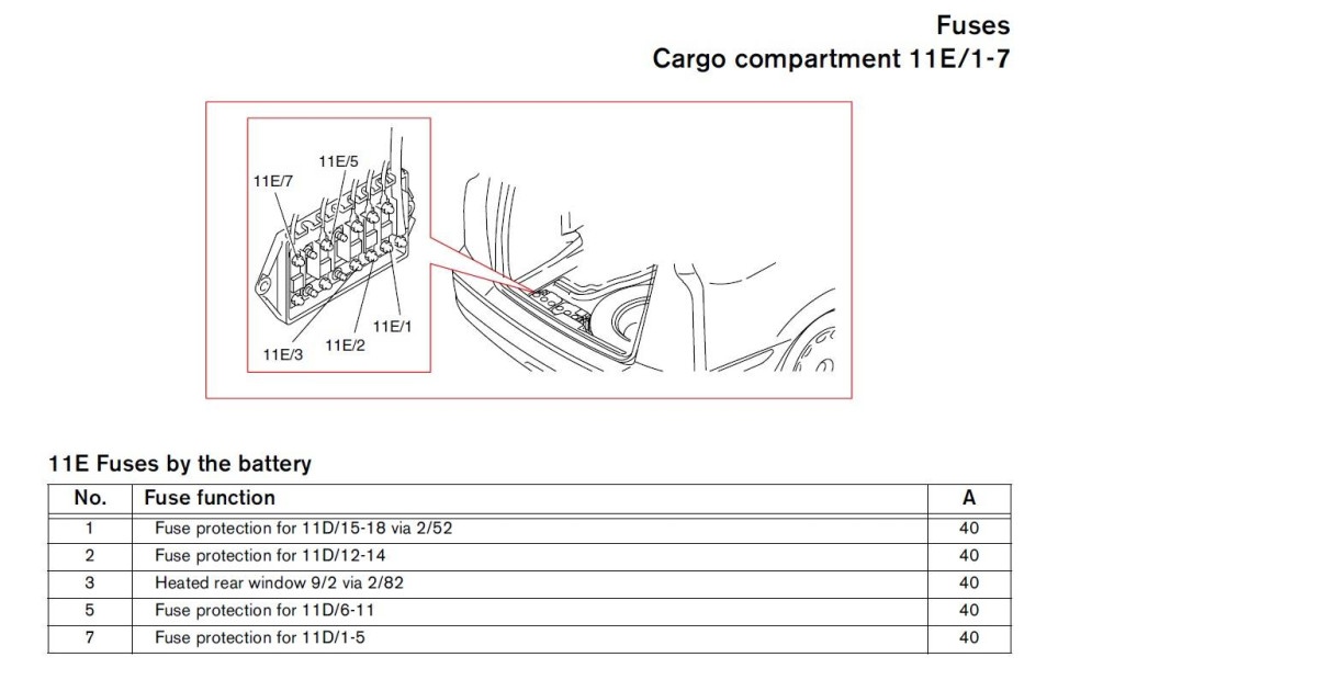

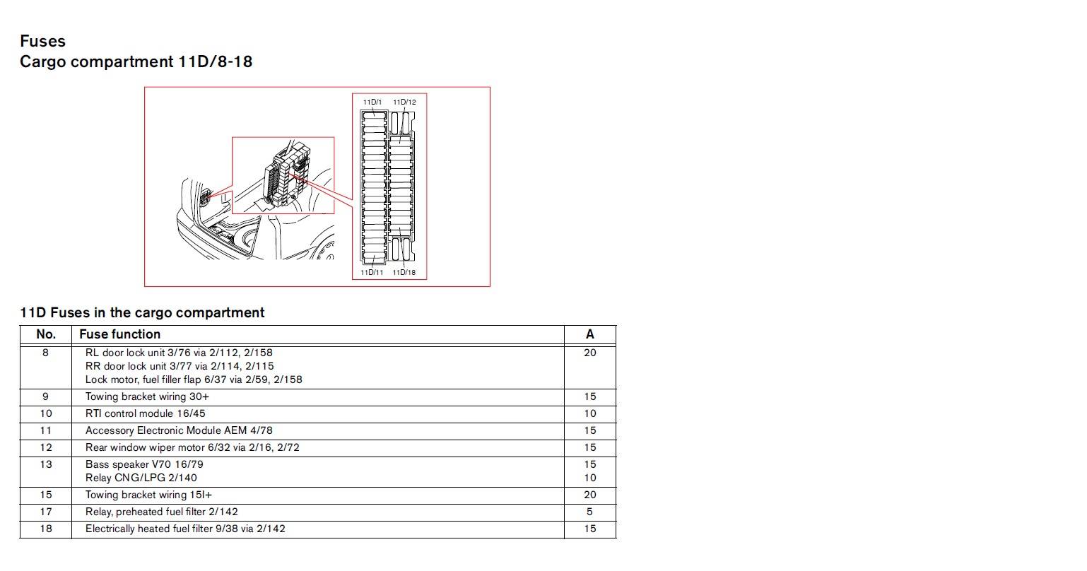

I think you're describing a fuse block containing 40 amp fuses that protect groups of lower amp fuses in the REM and the rear window defogger. If you lose power to the REM fuses you could see your brake lights go out, your rear locks may stop working including your gas filler door, your fuel gauge, rear wiper/washer/, window defogger could stop working. I don't think your engine will stop because the fuel pump gets power from the CEM but I would definitely get this fixed before driving anymore.DeezlWeezl wrote: 12 Jul 2024, 17:36 This is probably a stupid easy question, but I just can't seem to phrase the question properly to get any result in Google and I don't have access to VIDA. I was replacing the battery in the back of my 2003 XC70 and one of the smaller secondary terminal clamps snapped off from the positive battery terminal. I have it wedged back into place for now, so it seems to run fine at the moment.

Yep! That's it! Thank you so much for answering! I'll get this fixed right away!
