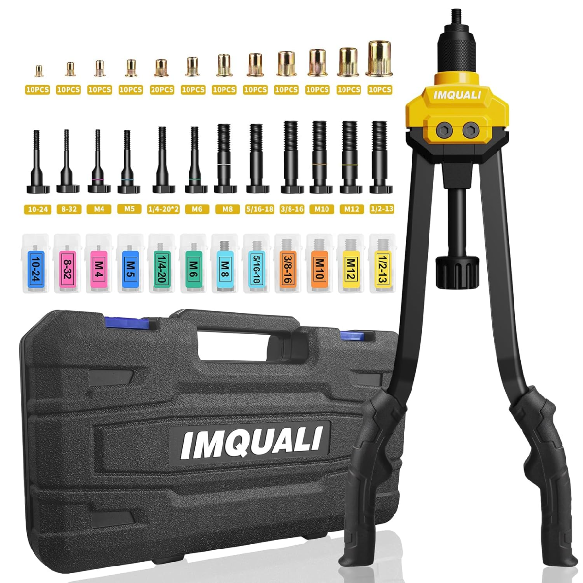

This is a really multipurpose use tool. I think Volvo rivets are terrible, wasteful, costly and overall poor design. You have the flexibility of removal with this besides potentially using it other areas of the car as in splash shield. Watch the videos.
Rivet Nut Tool Rivet Nut Kit
https://www.amazon.com/IMQUALI-Metric-M ... idGY&psc=1

nice idea! In my area I can order by 10p tonight nd have by 8a tomorrow. I've wanted one for a while since I;'ve been using the manual wrench method to install rivnuts.MoVolvos wrote: ↑23 Jul 2024, 13:04.Andrew Vanis wrote: ↑23 Jul 2024, 12:28 What's the current thinking on reattaching the fender liner and mud flaps?
I'm considering 3d printing some smaller diameter xmas trees since the 1/4 inch ones are too wide and I don't have time to order (and I don't want to spend $) on the proper rivets.
Thanks
....waiting to order until later incase better solutions come up
thanks for the post!

Read my post above as to why this is a really bad idea!!
If you have to get going, use regular rivets maybe with a #8 washer under the head. Then order the correct ones and replace at the first opportunity.

I did see that and when I ripped a mud flap going I've a root the Volvo rubbers stayed in the fender and ripped through the mud flap so I'm figuring a screw of a similar head diameter will act the same. If the 8-32 ribbit fits the existing holes the head will be small.
