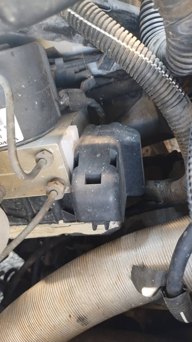

Andrew Vanis
- Posts: 77
- Joined: 05 Aug 2013, 19:01
- Year and Model: 1999
- Location: Albuquerque, NM
- Been thanked: 11 times
- foggydogg
- Posts: 2948
- Joined: 17 Oct 2009, 00:28
- Has thanked: 83 times
- Been thanked: 405 times

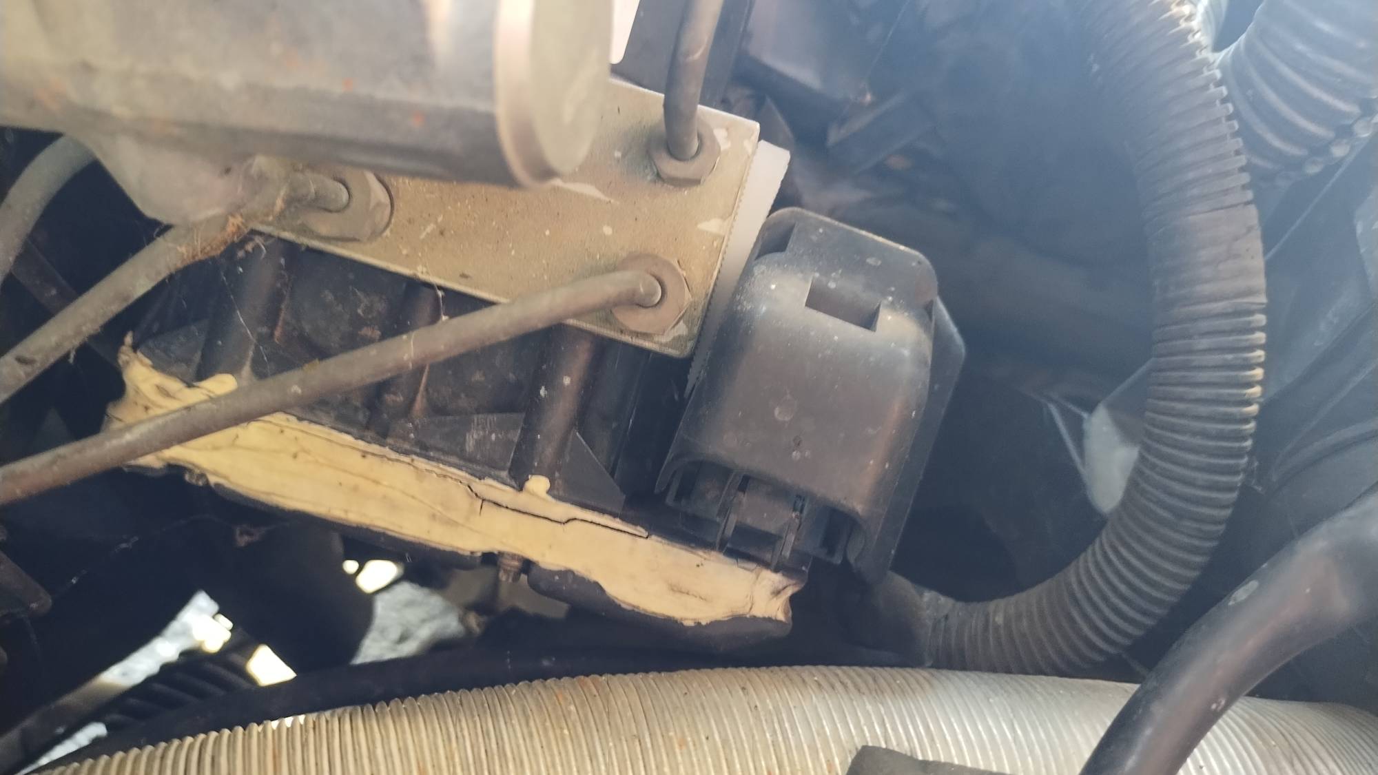

That wedge idea is diagnostic, not really a "fix".Andrew Vanis wrote: 24 Jul 2024, 09:15 This is how I did the test and I will have ABS light.
What's the next step?
Notice the white silicone which I may it may not have done the resolder fix a decade ago... memory fades.
Thanks
Several vendors can do the repair, Matty is the best known and a friend here. Alex at Swedish Car Parts in Chicago is another.
I agree with Clemens, too much pressure on the connector itself can make things way worse. If the car is a daily driver, the suggestion would be to do a permanent repair.

Looking at the photo it is clear thst someone had the module open and tried to fix it. There is no need to diagnose, from my point of view, if the module is seales with white who-knows-what. It's not one of Mattys repairs, so I'd sebd it in for diagnostics.
If you really think it could be something else, there is a slight chance of a broken ABS ring or a faulty wire. You can cgeck for a cracked ABS ring visually and check the wiring loom for resistance with an ohm-meter. the "is good" values for each circuit are out there.
