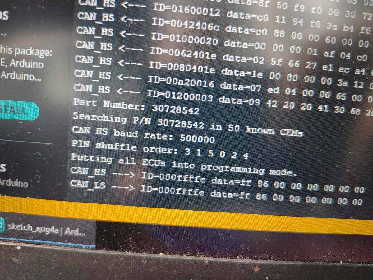

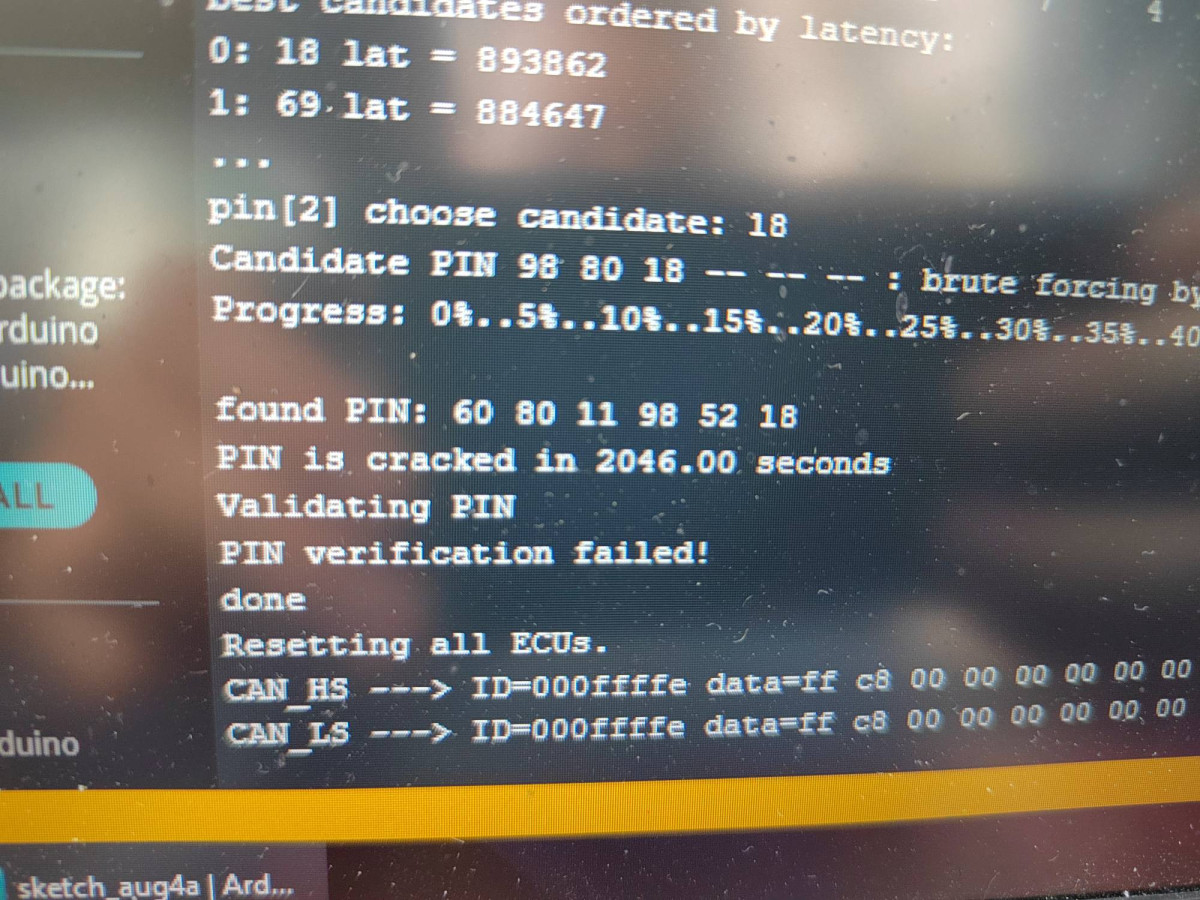

Trying to crack CEM L (31314468) on bench, can't seem to get it started. I am getting the following
Build Date: Jul 26 2024 02:15:05
CPU Maximum Frequency: 600000000
CPU Frequency: 180000000
Execution Rate: 180 cycles/us
PIN bytes to measure: 3
CAN low-speed init done.
CAN high-speed init done.
Putting all ECUs into programming mode.
CAN_HS ---> ID=000ffffe data=ff 86 00 00 00 00 00 00
CAN_LS ---> ID=000ffffe data=ff 86 00 00 00 00 00 00
Reading part number from ECU 0x50 on CAN_HS
CAN_HS ---> ID=000ffffe data=50 88 00 00 00 00 00 00
Part Number: 0
Unknown CEM part number 0. Don't know what to do.
Resetting all ECUs.
CAN_HS ---> ID=000ffffe data=ff c8 00 00 00 00 00 00
CAN_LS ---> ID=000ffffe data=ff c8 00 00 00 00 00 00
My setup
+12V on D:8 and D:15
GND: D6
CAN HS from Teensy: D:33 and D:48
CAN LS from Teensy: D40 and D:55
120 ohm between D:31 and D:46
120 ohm between D:34 and D:49
Running latest code with CEM_PN_AUTODETECT commented out
Double, triple checked all connections, nothing changed.
I notice this when running the code without CEM_PN_AUTODETECT Commented Out
CAN_LS <--- ID=00e01008 data=03 60 10 00 00 00 4c 00
CAN_LS <--- ID=0381526c data=00 01 05 00 07 ff 00 00
CAN_LS <--- ID=03a04004 data=00 20 ff ff ff ff ff ff
CAN_LS <--- ID=03c01428 data=80 80 00 00 02 00 00 00
CAN_LS <--- ID=00217ffc data=03 4b 00 10 e8 00 00 00
CAN_LS <--- ID=0131726c data=00 00 00 76 00 00 00 3f
CAN_LS <--- ID=00800003 data=09 68 20 20 41 31 37 64
Part Number: 31314468
Searching P/N 31314468 in 50 known CEMs
CAN HS baud rate: 500000
PIN shuffle order: 3 1 5 0 2 4
Part Number: 0
Initialization done.
Profiling CEM
At which point it stops. So it can get PN from CAN_LS, but not CAN_HS
What am I missing?
