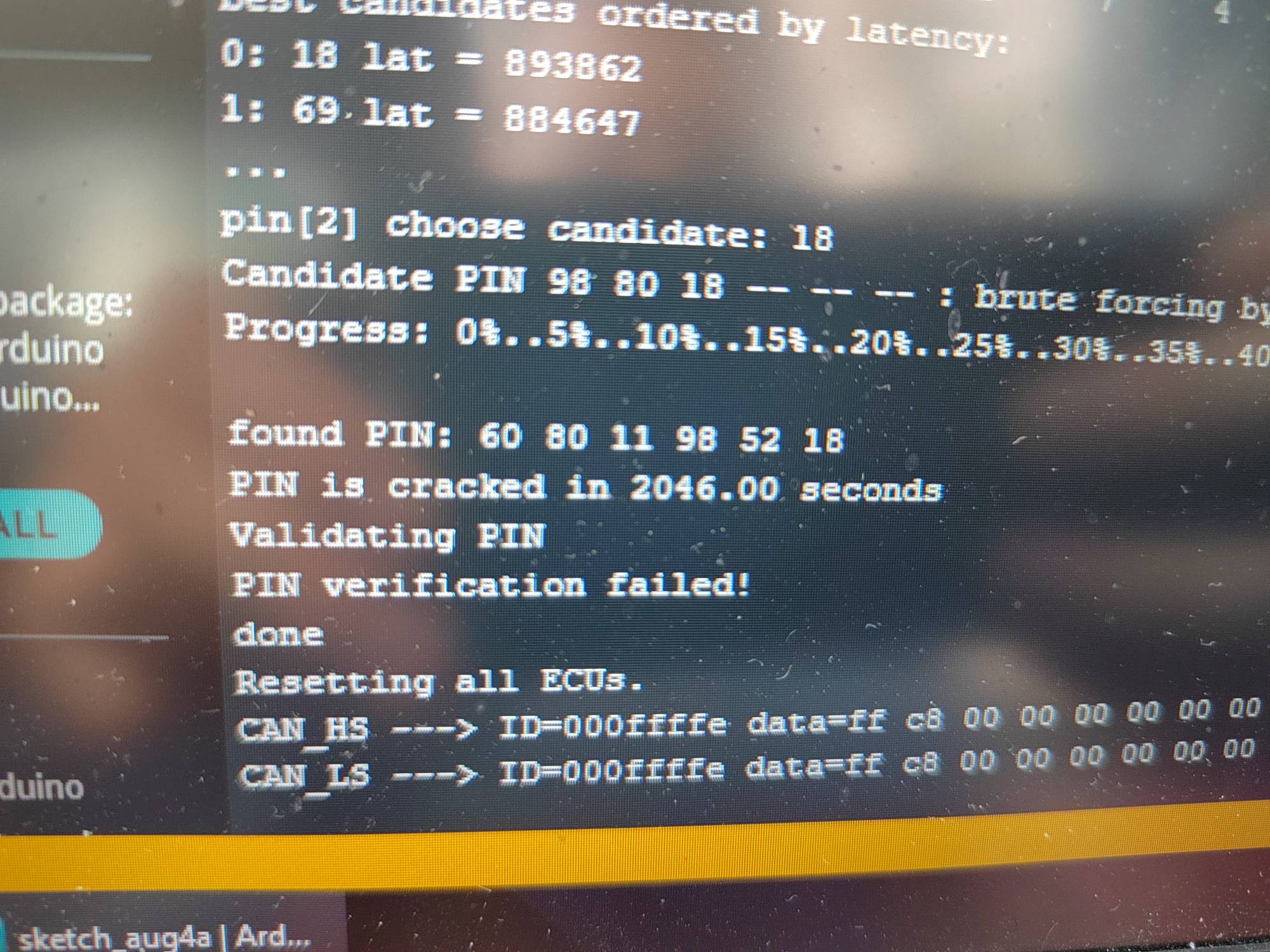

Trying to crack CEM L (31314468) on bench, can't seem to get it started. I am getting the following
Build Date: Jul 26 2024 02:15:05
CPU Maximum Frequency: 600000000
CPU Frequency: 180000000
Execution Rate: 180 cycles/us
PIN bytes to measure: 3
CAN low-speed init done.
CAN high-speed init done.
Putting all ECUs into programming mode.
CAN_HS ---> ID=000ffffe data=ff 86 00 00 00 00 00 00
CAN_LS ---> ID=000ffffe data=ff 86 00 00 00 00 00 00
Reading part number from ECU 0x50 on CAN_HS
CAN_HS ---> ID=000ffffe data=50 88 00 00 00 00 00 00
Part Number: 0
Unknown CEM part number 0. Don't know what to do.
Resetting all ECUs.
CAN_HS ---> ID=000ffffe data=ff c8 00 00 00 00 00 00
CAN_LS ---> ID=000ffffe data=ff c8 00 00 00 00 00 00
My setup
+12V on D:8 and D:15
GND: D6
CAN HS from Teensy: D:33 and D:48
CAN LS from Teensy: D40 and D:55
120 ohm between D:31 and D:46
120 ohm between D:34 and D:49
Running latest code with CEM_PN_AUTODETECT commented out
Double, triple checked all connections, nothing changed.
I notice this when running the code without CEM_PN_AUTODETECT Commented Out
CAN_LS <--- ID=00e01008 data=03 60 10 00 00 00 4c 00
CAN_LS <--- ID=0381526c data=00 01 05 00 07 ff 00 00
CAN_LS <--- ID=03a04004 data=00 20 ff ff ff ff ff ff
CAN_LS <--- ID=03c01428 data=80 80 00 00 02 00 00 00
CAN_LS <--- ID=00217ffc data=03 4b 00 10 e8 00 00 00
CAN_LS <--- ID=0131726c data=00 00 00 76 00 00 00 3f
CAN_LS <--- ID=00800003 data=09 68 20 20 41 31 37 64
Part Number: 31314468
Searching P/N 31314468 in 50 known CEMs
CAN HS baud rate: 500000
PIN shuffle order: 3 1 5 0 2 4
Part Number: 0
Initialization done.
Profiling CEM
At which point it stops. So it can get PN from CAN_LS, but not CAN_HS
What am I missing?

Does the cem audibly 'click' while the program is running ?
I have had It quite afew times where the cem simply hasn't even responded too the request. I have had to reset the cem and the Teensy simultaneously for it too go into be seen.

Yes, the CEM doea click audibly. When powered on and when the message "sending into programming mode"

You need to terminate HS and LS, too

Remove autodetect, start the cracker, within 5 seconds apply power to CEM.
