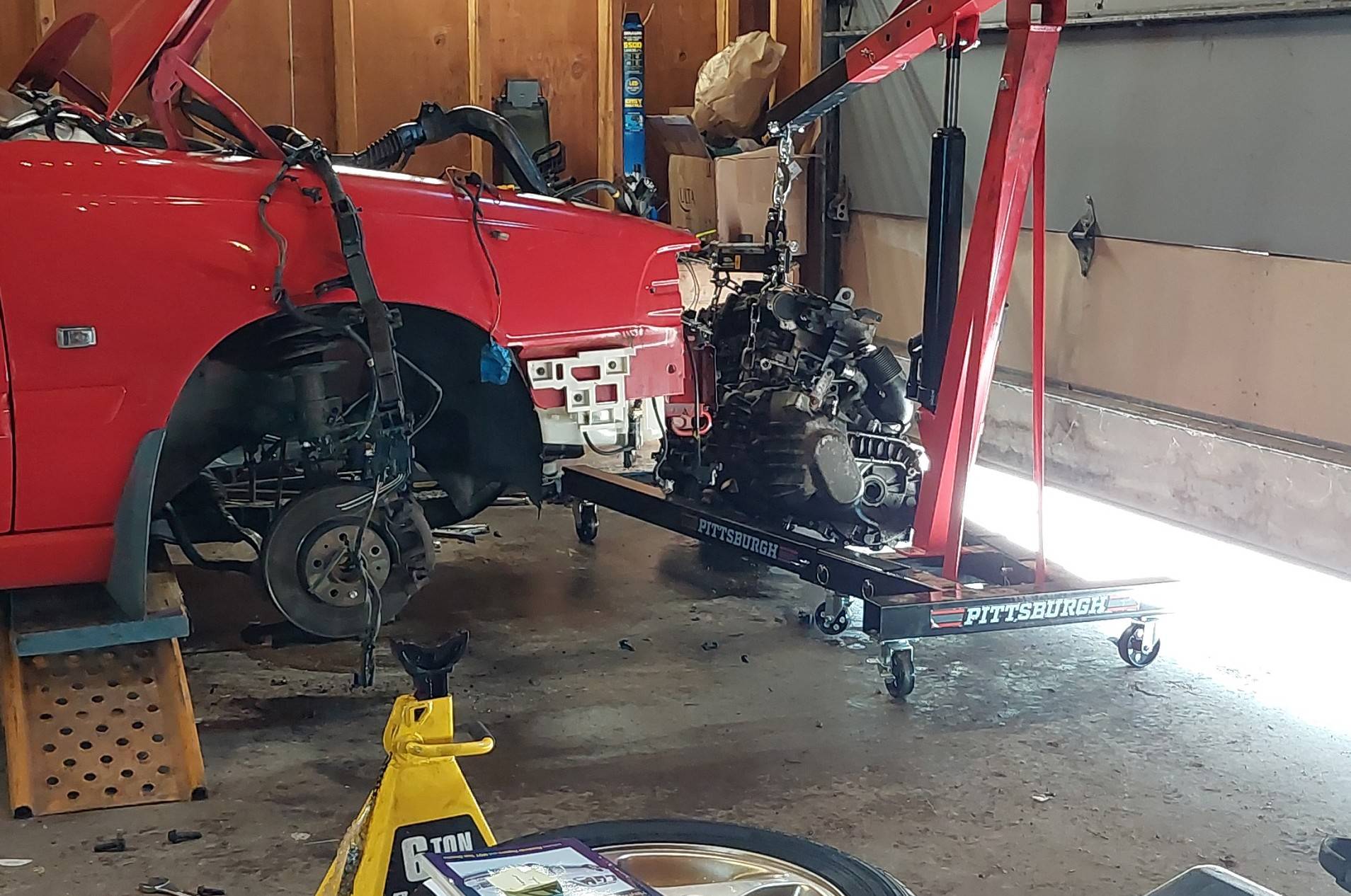

The engine is out. I had to remove the axles. There was no way it was going to come otherwise.
90 degrees and humid here in Minnesota. It took me about 4 hours.
I lost 3.6 lbs. in that time.
I think I need to hydrate.

One of the CV axles literally fell apart once it was tapped out of the hub, so I don't feel too bad about having to remove them. They were due for replacement I guess..
This morning I am going to clean up the shop and the engine bay, and put the transaxle back in the bay (which wiill be a MOTOR bay henceforth).
Things should start moving fast, as far as making this thing be an electric car. Hallelujah!
