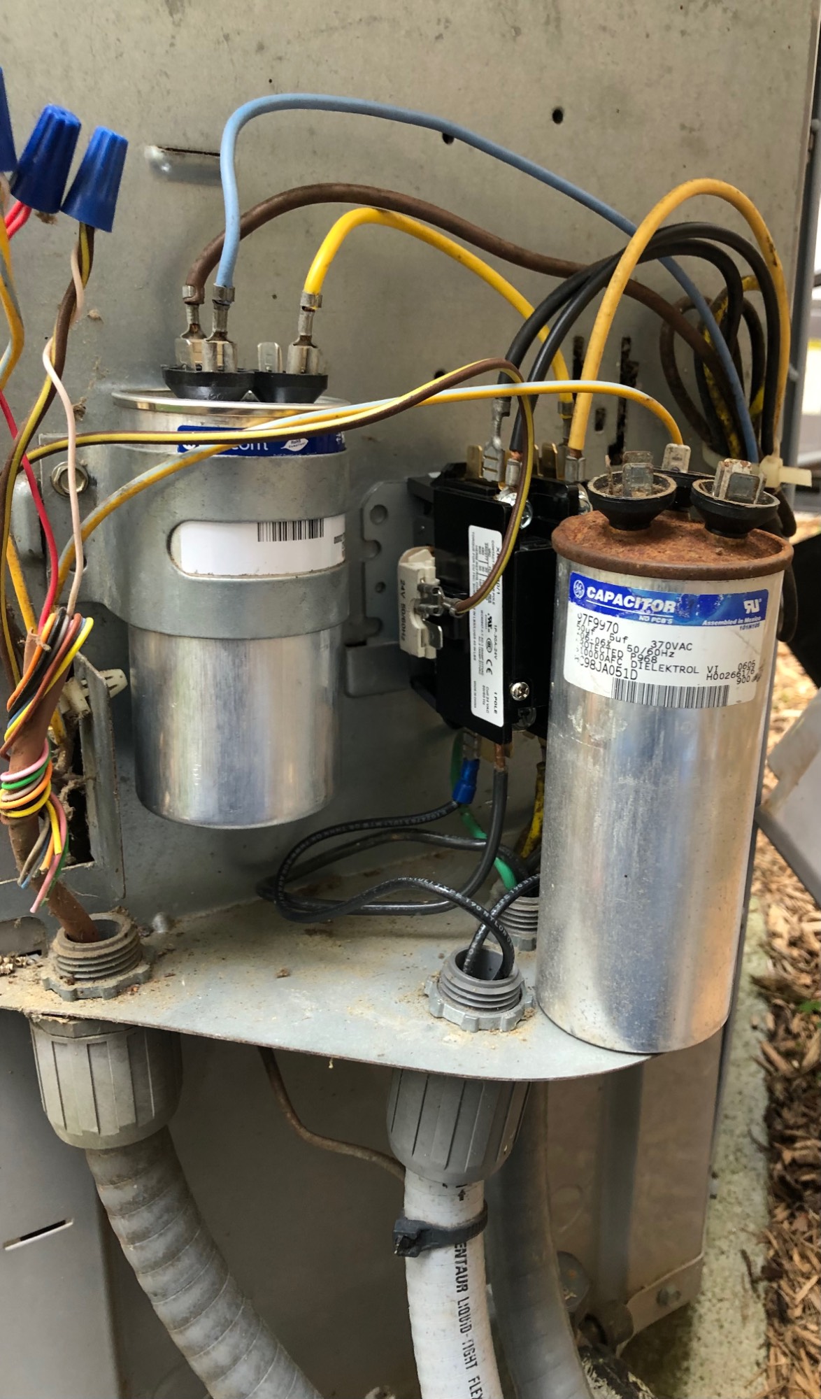

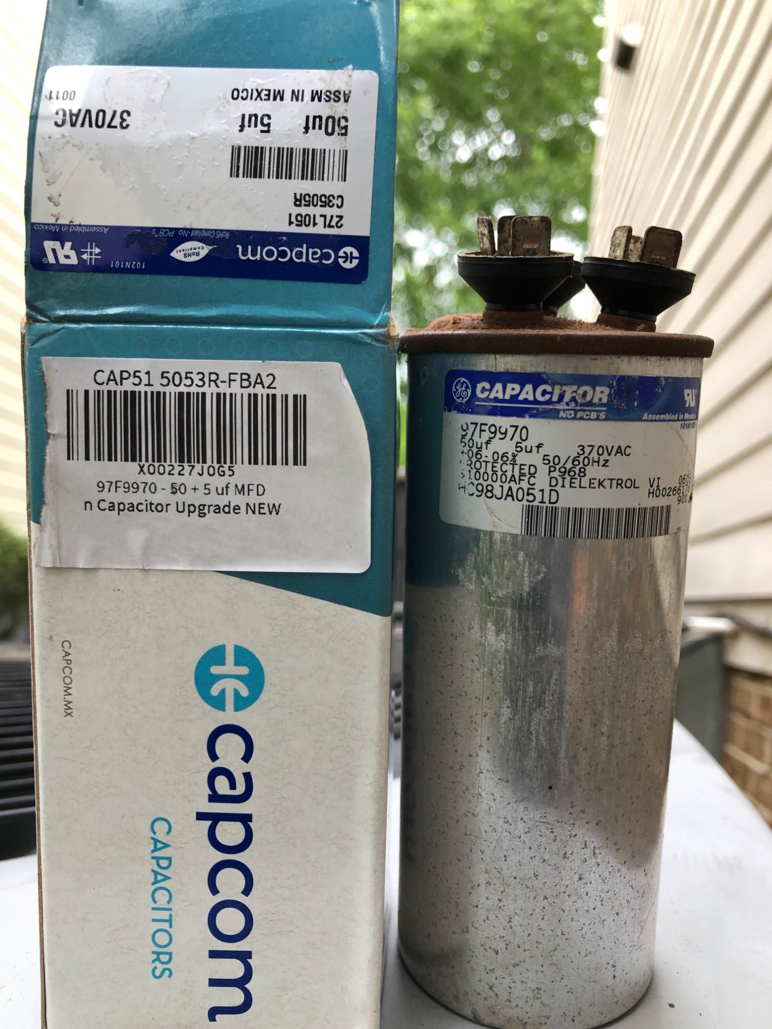

The AC unit is 2006. Had to replaced the furnace / evaporator fan capacitor twice the last two years. Both times the fan speed was low and the evaporator coil iced up so almost no air flow from the ducts. Initially thought it was low refrigerant causing the coil icing. This year the unit is not running again but the furnace fan speed was blowing normally. Checked the condensing unit outside and the fan would hum while the compressor would click and tried to start.
1) Had good voltage at contactor and was working properly. Removed and sanded contacts with 600 grit to be sure.
2) Fan would spin if you helped it along with a stick or screw driver :lol:.
3) Capacitor was bulging but didn't know if was a dual run unit so thought the compressor was bad.
4) The scroll compressor didn't looked like it had a capacitor built in. After watching a Youtube video realized it could be a dual run so it should be for both the compressor and condensing fan.
For good measure ordered a new contactor, new capacitor and a new to me hard start capacitor. To think I used to do load calcs, design walk ins, blast freezers including sourcing and putting it all together, Oxy Acetylene welding with nitrogen and all. Have a Universal CFC so turn key except for the electrical :oops: :? .
Parts will arrive tomorrow so hopefully that it?

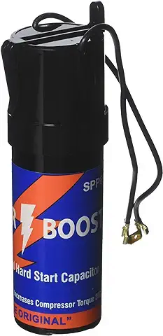

One reviewer indicated a company wanted $900 to install two Hard Start Capacitors, one for each unit, to assist the new capacitor due to the age of the older compressor (see video). $15 to $50 dollar part depending on the type. 10 minute job max from beginning to end. The panel is already off so just a few minutes to install. Worst than a Stealership!

Installed Capacitor & Contactor last weekend, Not much room so decided against the Hard Start Capacitor. Unit is smaller but is has the same ratings.

I Can’t remember if this type of cap has polarity but in any event it’s good practice to photo and replace wires in the same place if the geometry is the same. I don’t believe they do have polarity
You do have to match the right cap to the load, 5uF is typically blower. 50uF for compressor

abscate wrote: 01 May 2024, 06:29 I Can’t remember if this type of cap has polarity but in any event it’s good practice to photo and replace wires in the same place if the geometry is the same. I don’t believe they do have polarity
Fan, Herm & Ground I believe were on the cap for the 3 connectors. Herm for Hermetic Sealed Compressor.
