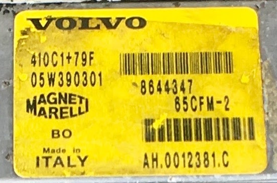

My '01 V70 2.4T has an ETM with the following label:
Magneti Marelli ETM with Yellow Label
