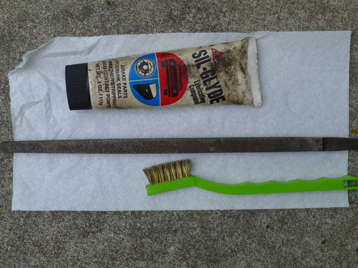

I've been using this file for 50 years (sad but true). A wire brush with steel bristles and this Sil Glide stuff has been in my toolbox for years.
