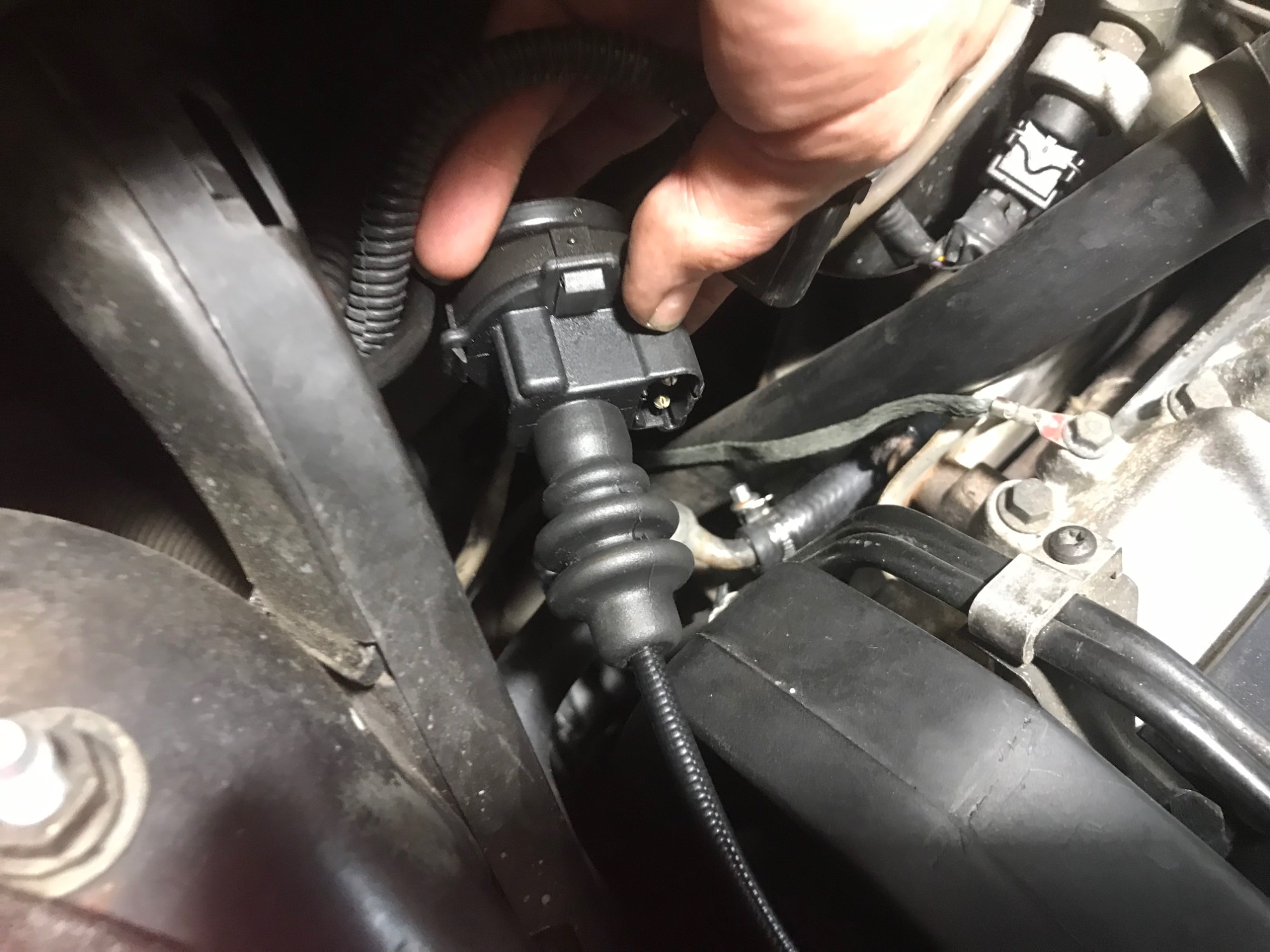

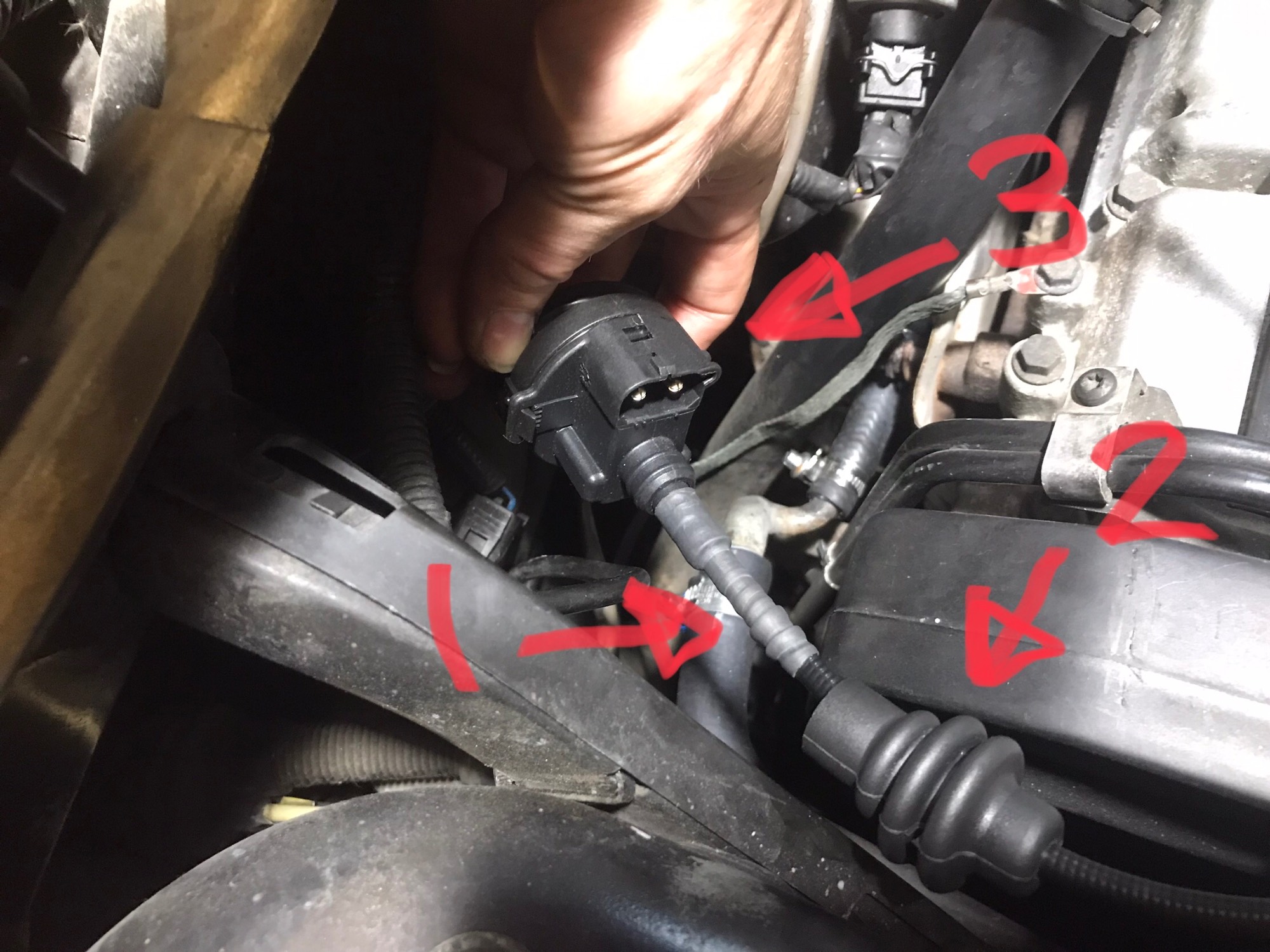

In the images below, (#1) is the heat shrink, (#2) is the rubber boot that I assumed to be a dust boot for the firewall housing and (#3) is the firewall housing. The heat shrink is crinkle up from pushing the cable housing back into the heat shrink several time while installing it. I will likely remove the heat shrink and put a touch of glue between the cable housing and firewall housing, should it become problematic. The throttle cable mount side seems to stay put.

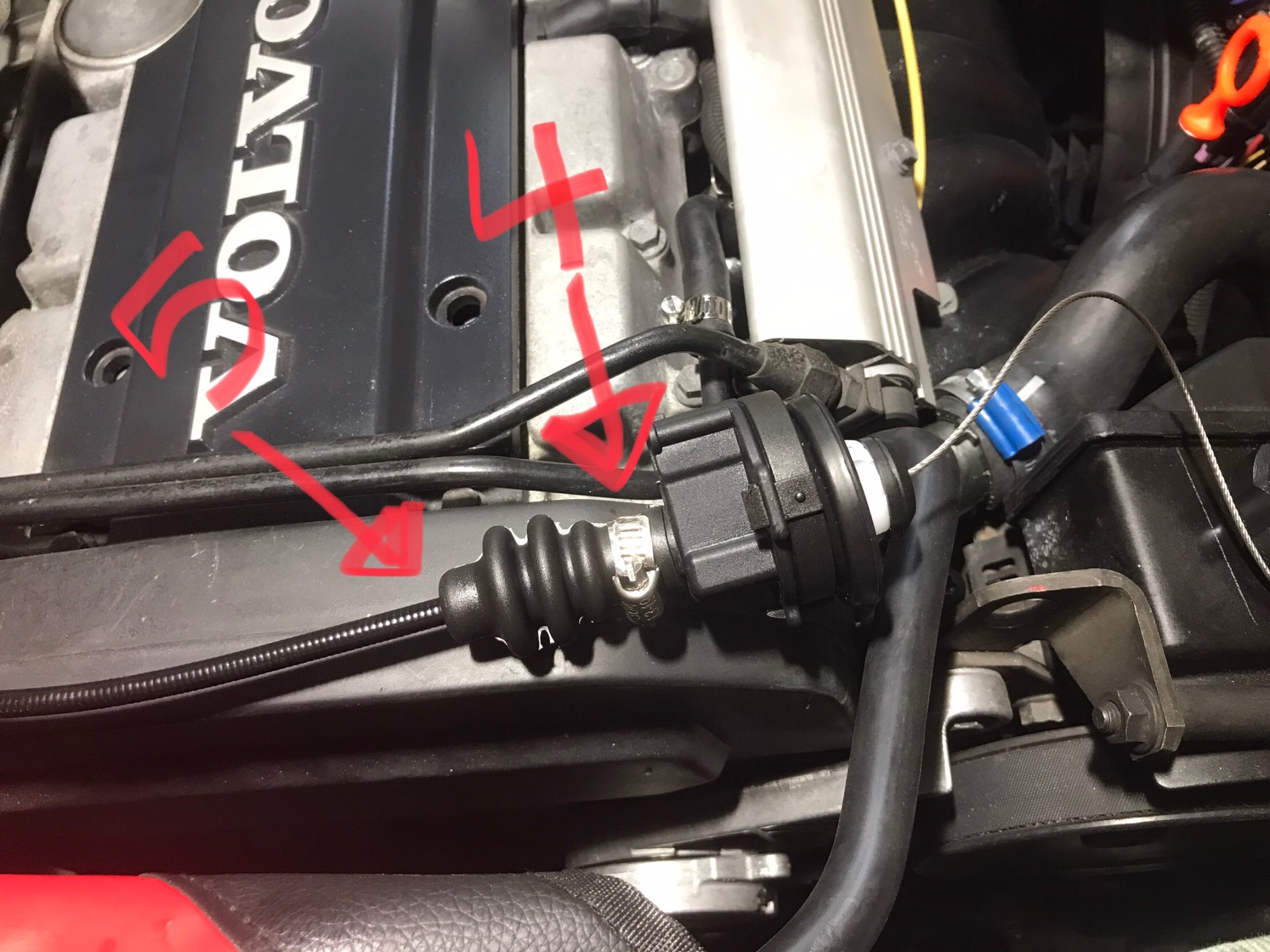

The next image shows the dust boot pushed onto the firewall housing. (#4) I decided to install hose clamp on the dust boot. (#5) where I put rubber cement on the boot and cable housing. I am supplying a photo of the glue I like for the car.

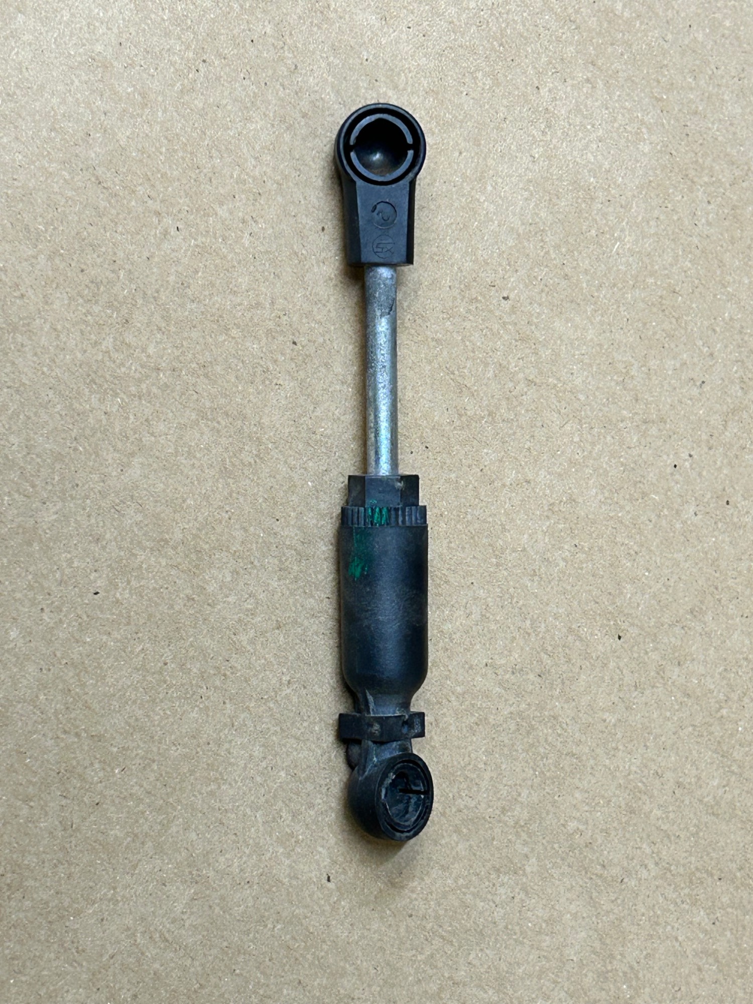

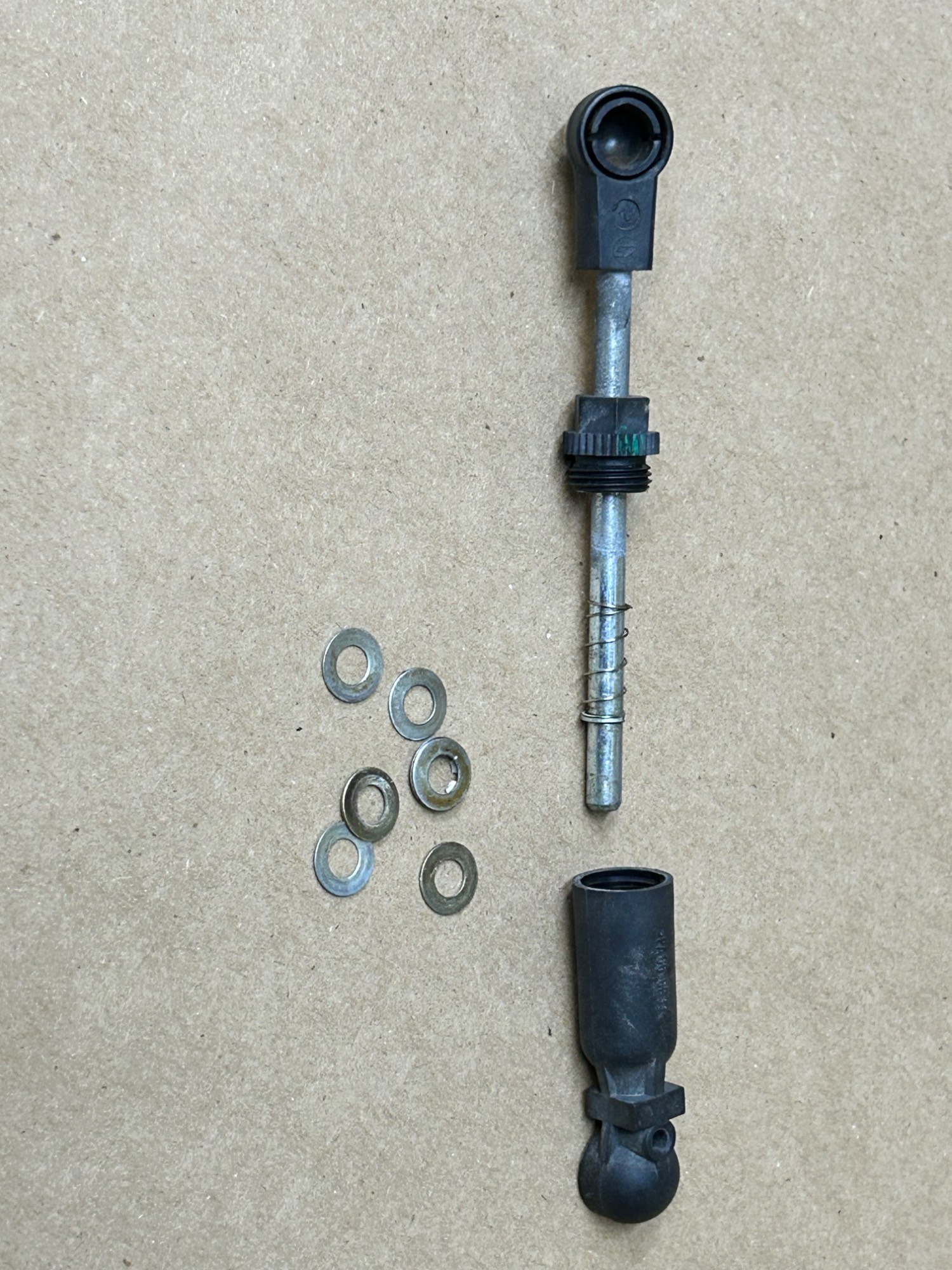

When I the installed the cable to the throttle body, I found the cable to be a little short, maybe 1/2 an inch. With the cable being short, the throttle was open a bit when hookup to the throttle body, which made the engine rev upon starting. I removed the link rod from the throttle body. I unscrewed the link rod body and found a spring and several washers. I removed the e-clip holding it all together and removed all the washers. This lengthened the link rod and closed the open throttle.
I have read the threaded link rod body is a length adjustment point in itself. I decided to remove the washers, rather than unscrewing the body, because of the lack of threads on the link rod body.
