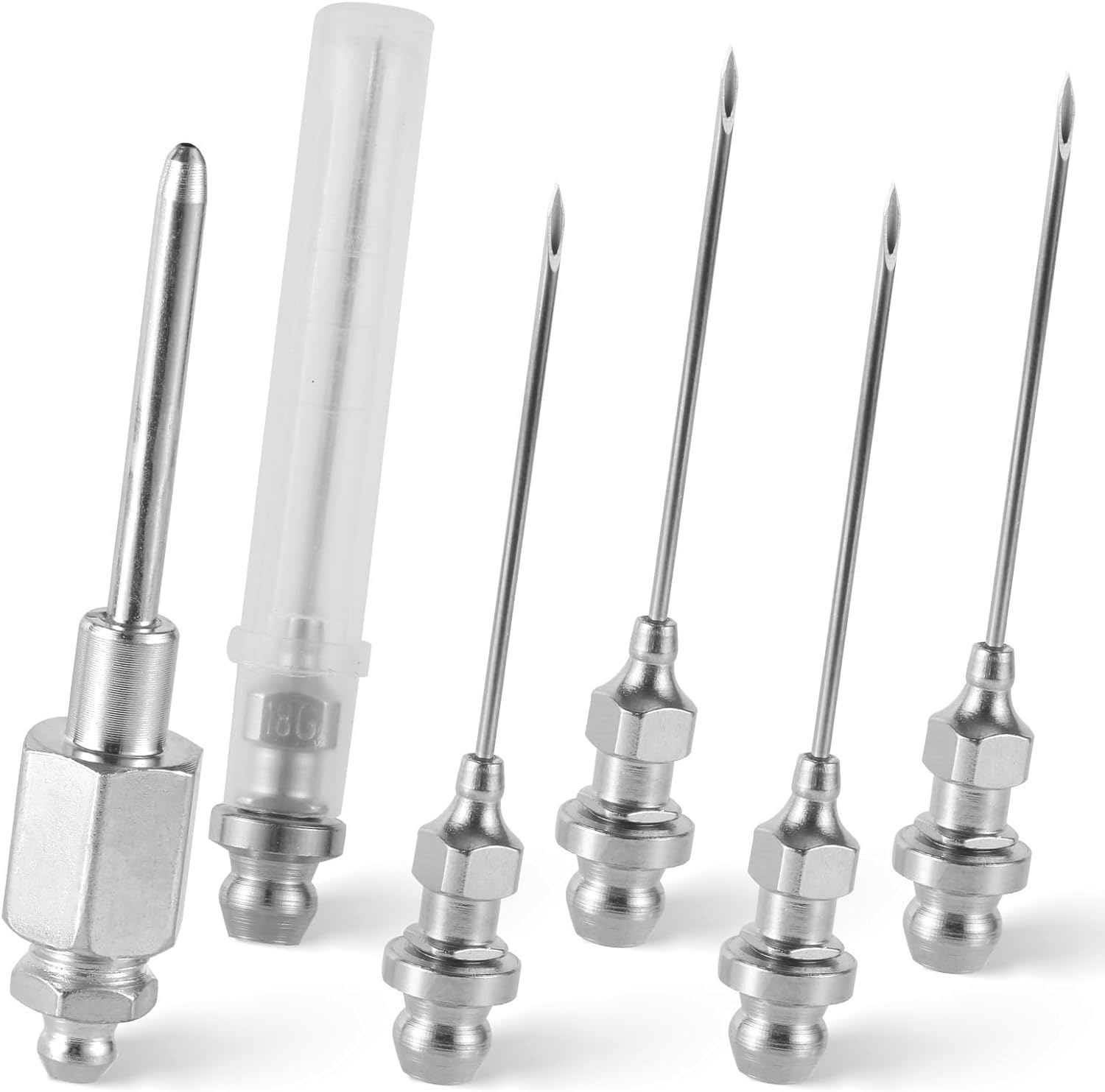

You might want to consider using a grease gun with a needle and injecting some grease directly into the bearing to see if the symptoms lessen? I used the needle to rejuvenate unbroken but old tie rod ends, sway bar links and ball joints. The suspension feels very quick and smooth afterward. Inject the CV boot at 12, 3, 6 and 9 o'clock and massage outside of boot to push in grease. Some will leak out with use but just wrap the hole with the wire loom double sided self sticking tape per Temp Mending link.
5pcs Grease Needle Nozzle, Bearing Grease Injector Needle with NPT Threaded Narrow Needle Adapter Grease Gun Tip Dispenser Fitting Tool for Injecting Grease into Small and Confined Spaces
https://www.amazon.com/XIHIRCD-Injector ... ive&sr=1-8
