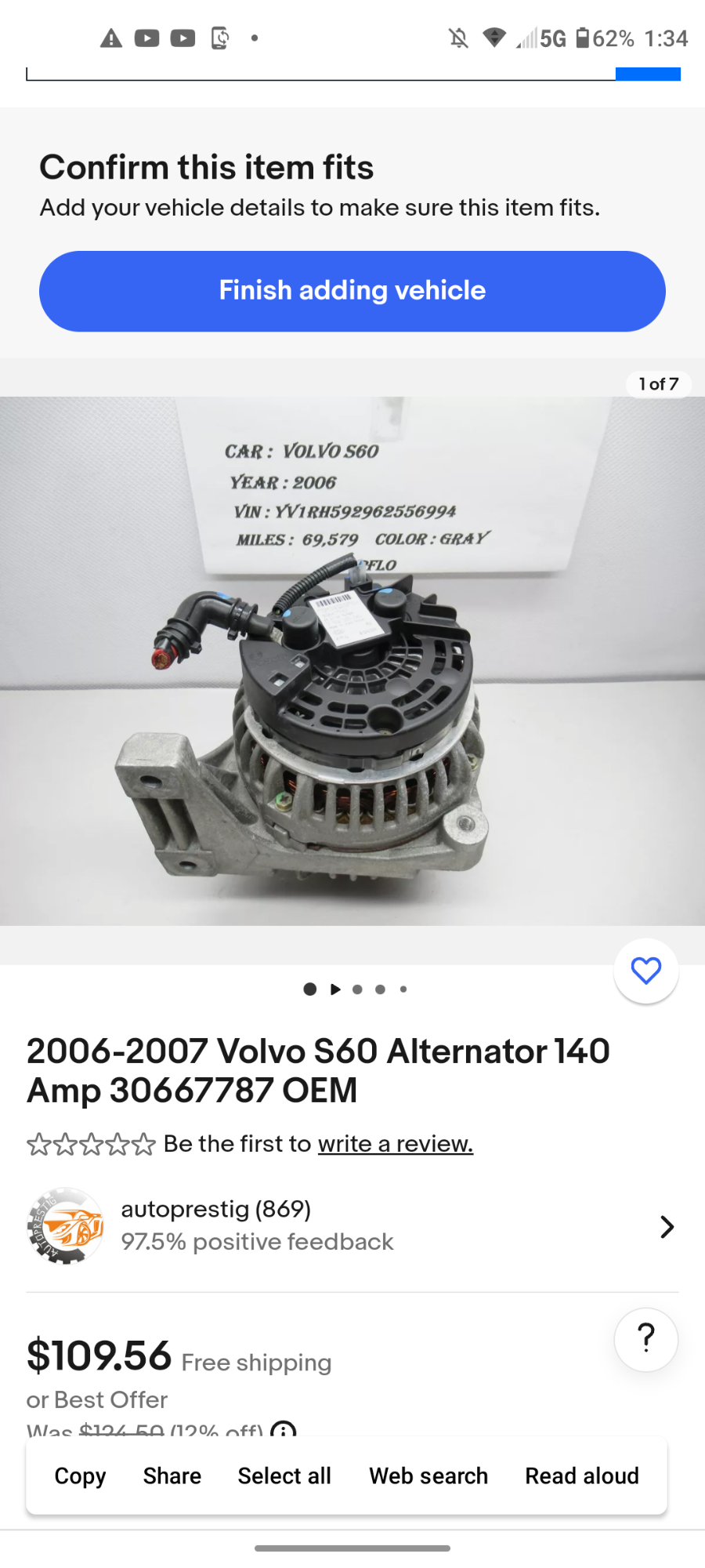

Most Bosch alternators are rebuilt (X), a few are new (N).
The rebuilt quality is inconsistent.
If you can find a Bosch AL0854N, then go for it.
Otherwise search eBay for Genuine Volvo alternator with low mileage (< 100K miles).
I only buy from eBay seller with proper VIN tag and clearly states the mileage.
This is a good example of alternator with only 70K miles.
