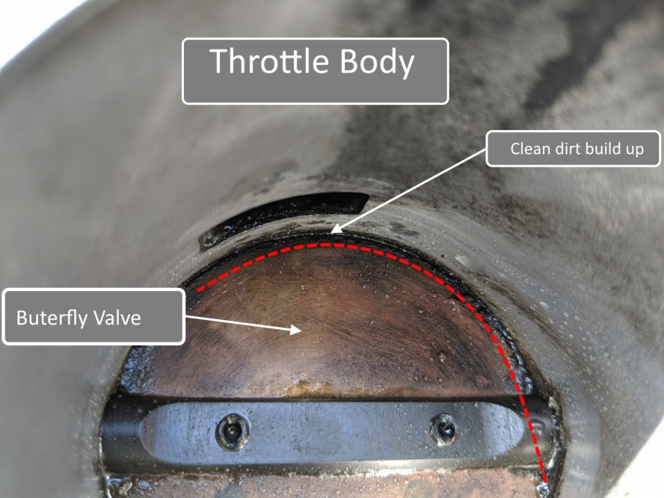

Have you consider perhaps a worn or dirty ETM. Generic photos found online, clean vs dirty and sticky butterfly. Don't over spray or saturate the inside. Spray on a lint free clothe and rub without bending the butterfly pivot, shaft and plate. Clean behind everything as much as possible.

Thats on my mind too because i used to play alot with those on older volvos with magneti marelli flaps but as i remember when i changed engine etm looked fine to my eyes, no dirt etc. Peehaps i have to look it
