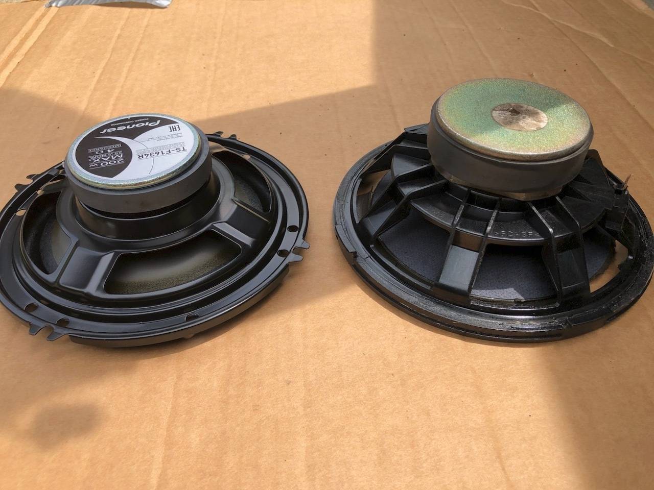

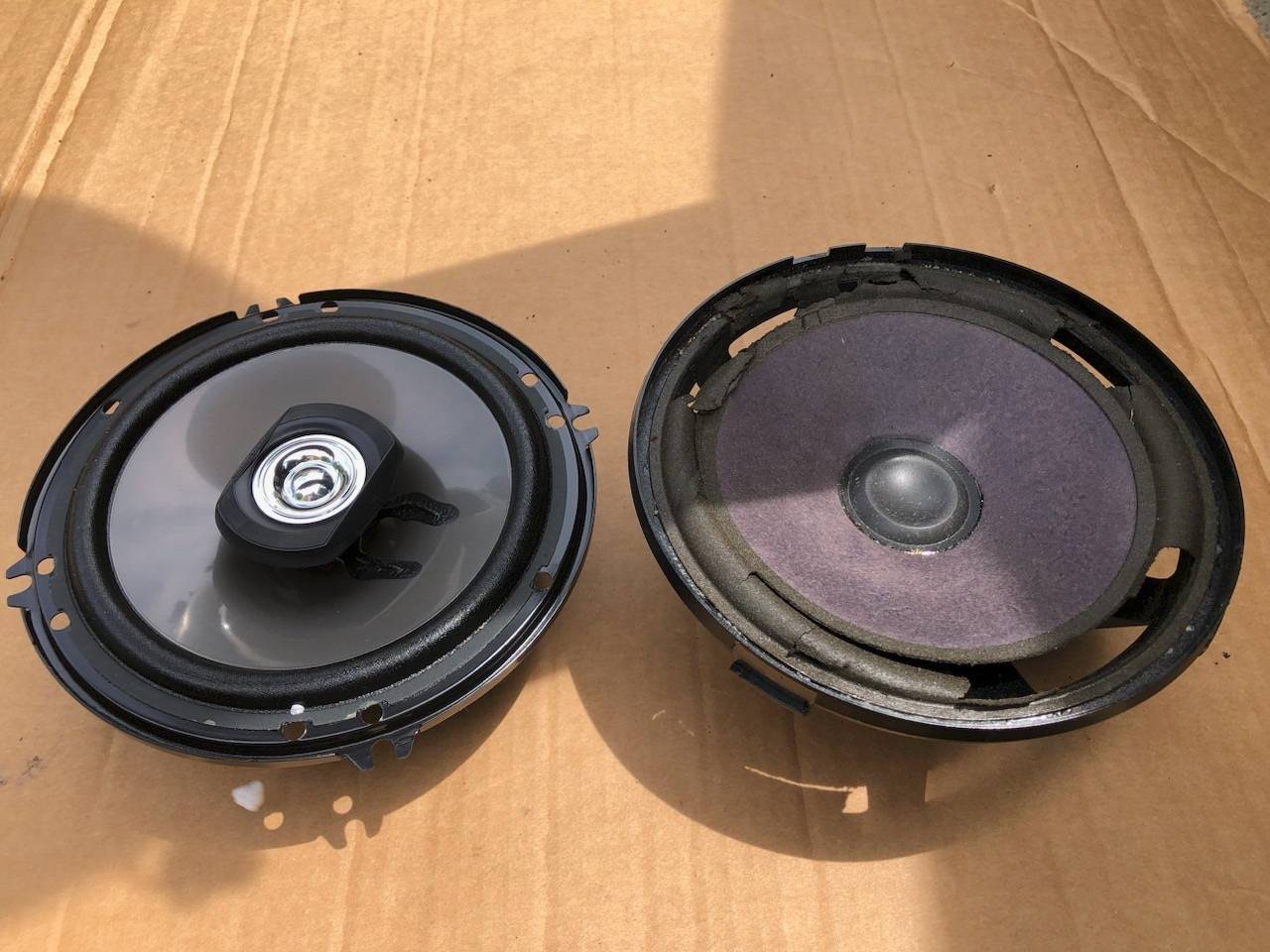

Stay with the stock speakers if you can. I should have re-foamed my 02 V70XC door speakers. Compare the size of the magnet of the Volvo full range bass speaker vs replacement. The 2 Way / Coaxial crossover does not match Volvo's tweeter making the system too mid-range in sound. Not great for music but okay for talk radio.
