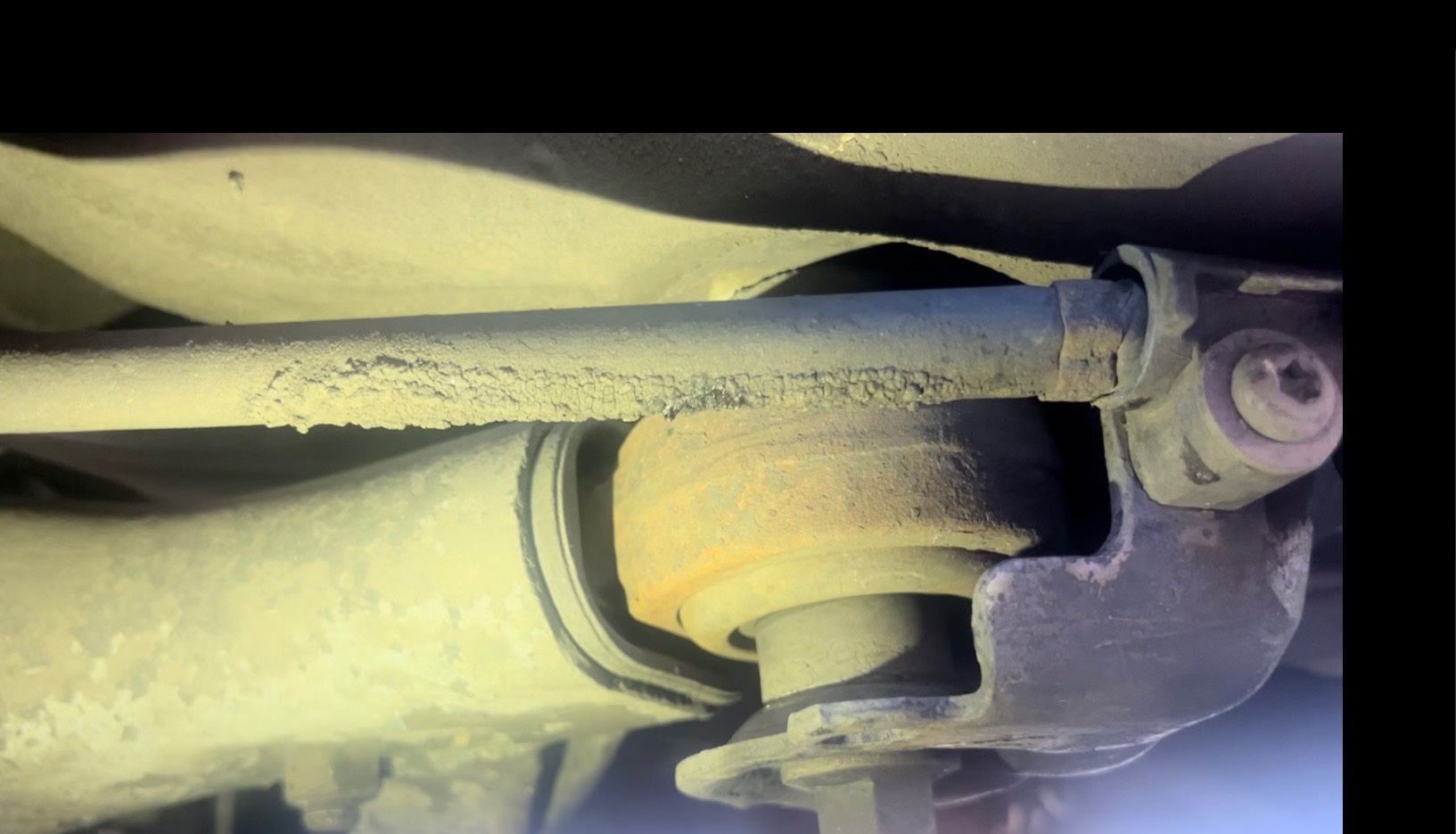

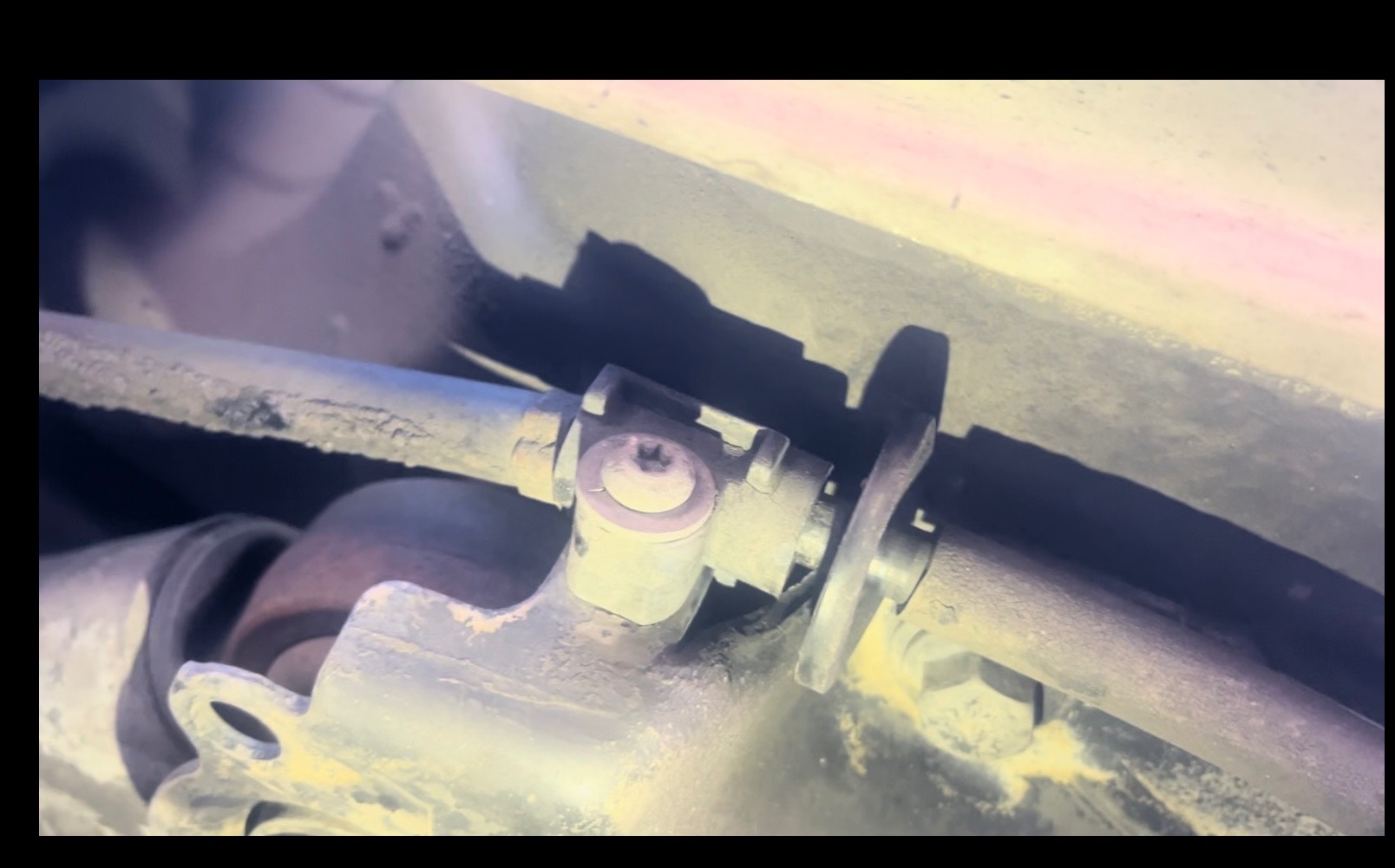

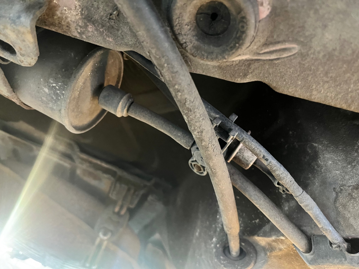

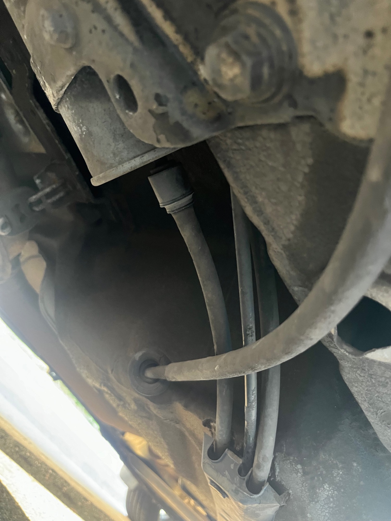

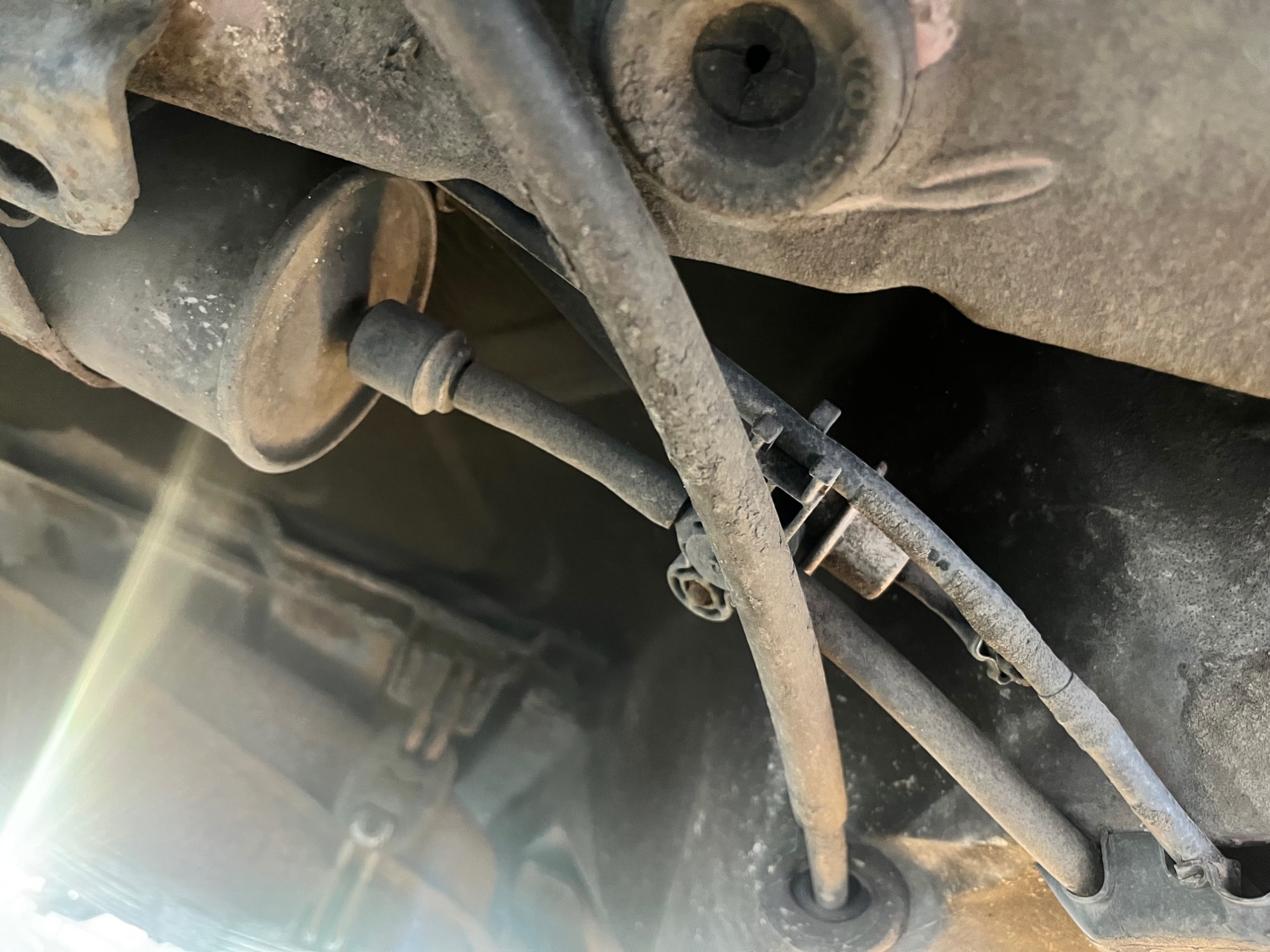

So been smelling gas when near the real wheel on my t5 s70. Looking at the lines near the wheel it looks like the line between the tank? And the filter needs replaced.
When looking up diagrams etc online most show the fpr sort of at this location. So I’m little confused at what I’m looking at here or what I need to fix this part of the problem
Anyone got the parts diagrams for this odd model?
98 s70 t5 fuel line/rail part #?s no fpr inline pass wheel

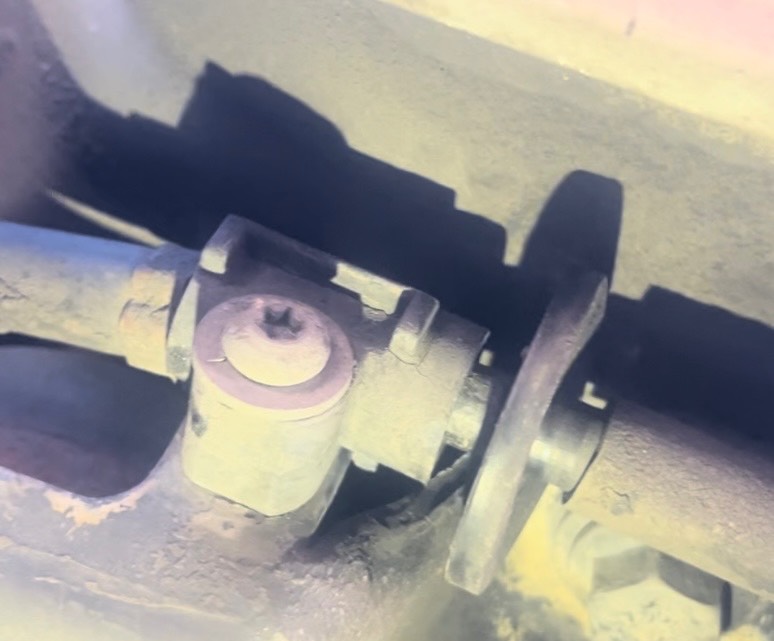

Just looks like the fuel filter is in that area.
I had some left over parts from my 97 so when I quickly glanced at it at first I figured the torx screw I saw was the fpr but it’s not when I looked at it better
But what I’m trying to figure out at the moment is replacing the fuel line in question that runs behind the passenger wheel to the bushing with the torx screw. I’m assuming there’s some sort of check valve or something here but can’t really find any info.
As well on the diagrams for the earlier models it looks like almost an elbow that goes from the main fuel line into the fpr. I’m looking at a hose that connects right in front of the passenger side rear wheel that runs then behind the brakes and I’m assuming up into the tank or there’s another connection somewhere back there.
Figured some diagrams etc might be more helpful before I start taking things apart and trying to put it back together

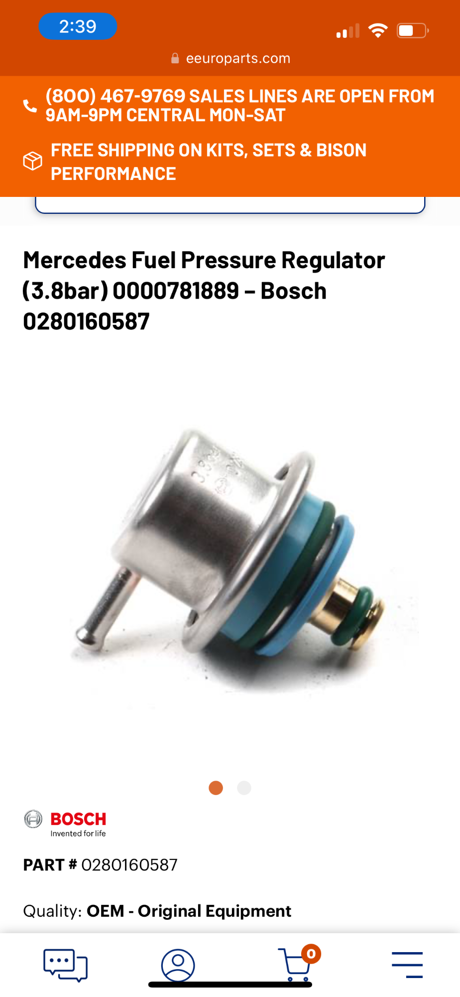

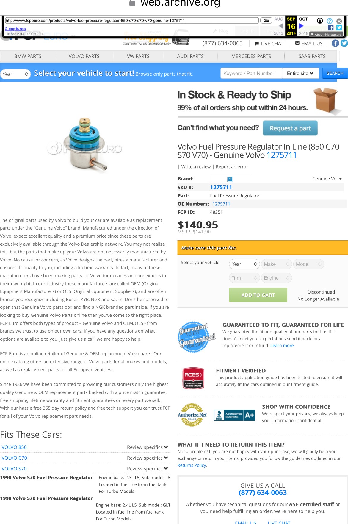

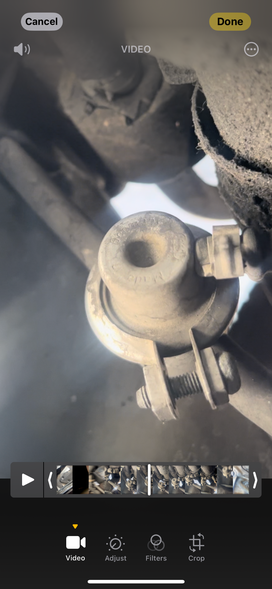

So found the fpr in the engine compartment basically.

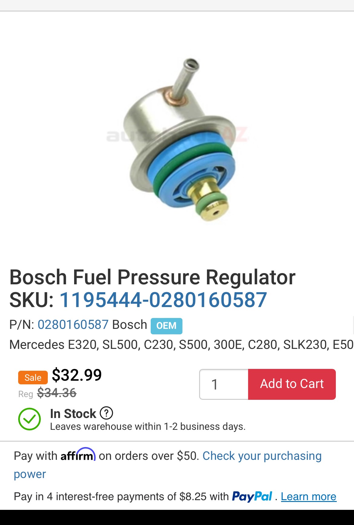

The Volvo part is no longer available. I’ve searched and I’ve seen people ask about other Bosch units that may work.
From what I’ve found there’s two different units that run at 3.8 bar. One of some mid90s Benz and another off mid2000 911s. The 911 part is priced accordingly at 3-5x the amount as the mb part.
But can I use said Benz part. It looks like an exact match from what I can gather and issue all Bosch regulators of this type are the same dimensions the different colors just relating to flow rate
Anyone ever done anything like this?

Correct that’s off a 97. Which I had parts for. Without looking I just assumed it was the same which on this model it’s not.
The other Bosch part #’s are readily available from multiple suppliers.

On the ‘98 the fpr is near the steering rack. It’s visible under the hood but I’d think it’s easier to access from under the car to replace.
