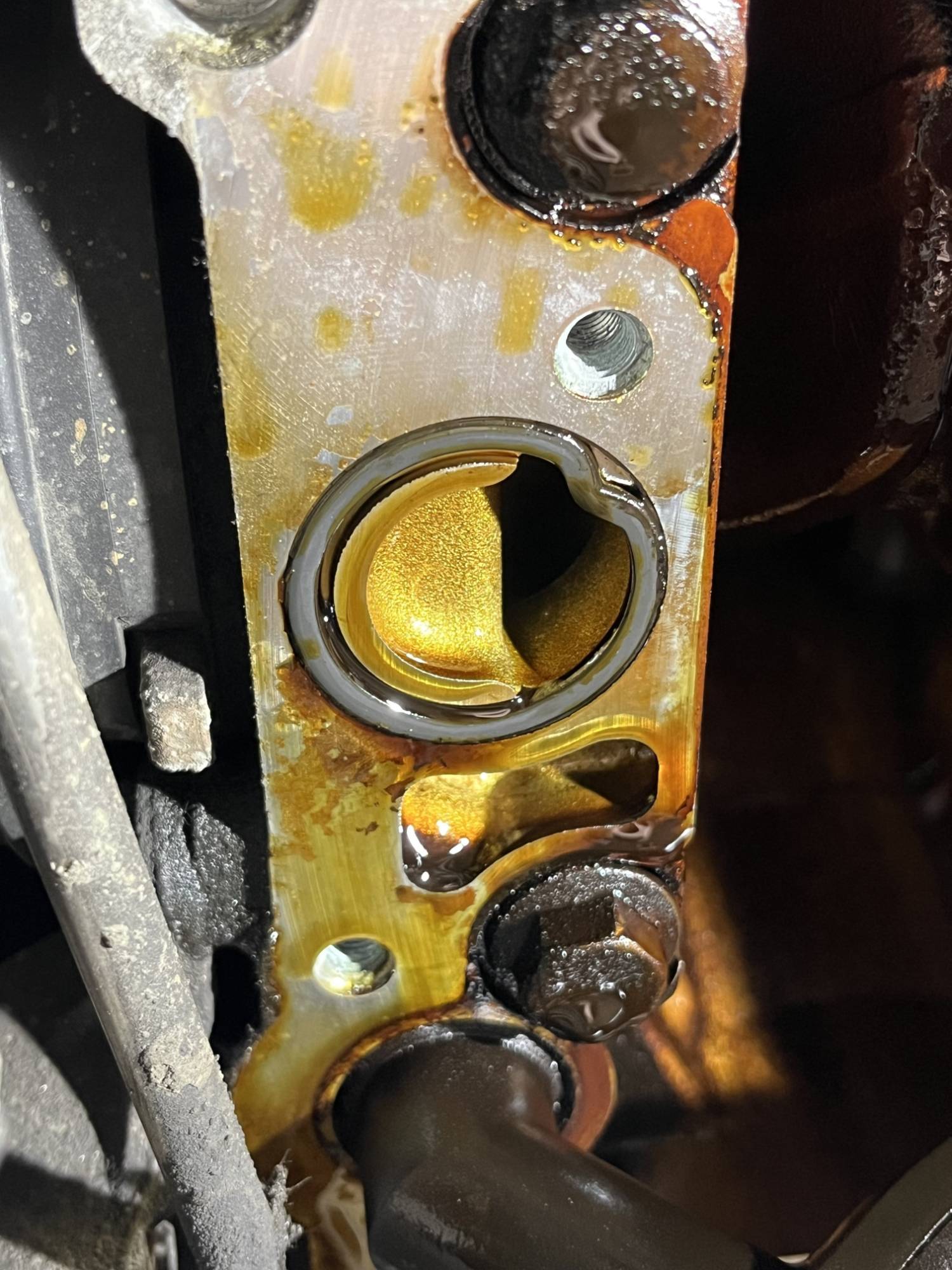

ecm-643A is a timing code, not a timing sensor code.
vida says,
ecm-643a
Possible source
Signal too high
- Poor oil quality
- Incorrectly adjusted camshafts
- The timing gear belt has jumped off the cogs
- Defective reset valve
- Mechanical fault in the variable valve timing (VVT) unit.
Signal too low
- Poor oil quality
- The timing gear belt has jumped off the cogs.
if the cams are in time it is usually poor oil quality .
thats why i asked about the oil change, mine disappeared with just an oil change.
if oil/filter change doesn't fix it then its usually the oil pan Orings , they distort and block oil pressure to the vvt solenoid, if the solenoid is lagging it sets the code 643a.
heres what an old oring does, swells up and distorts the oil passage on the oil pan lip.
