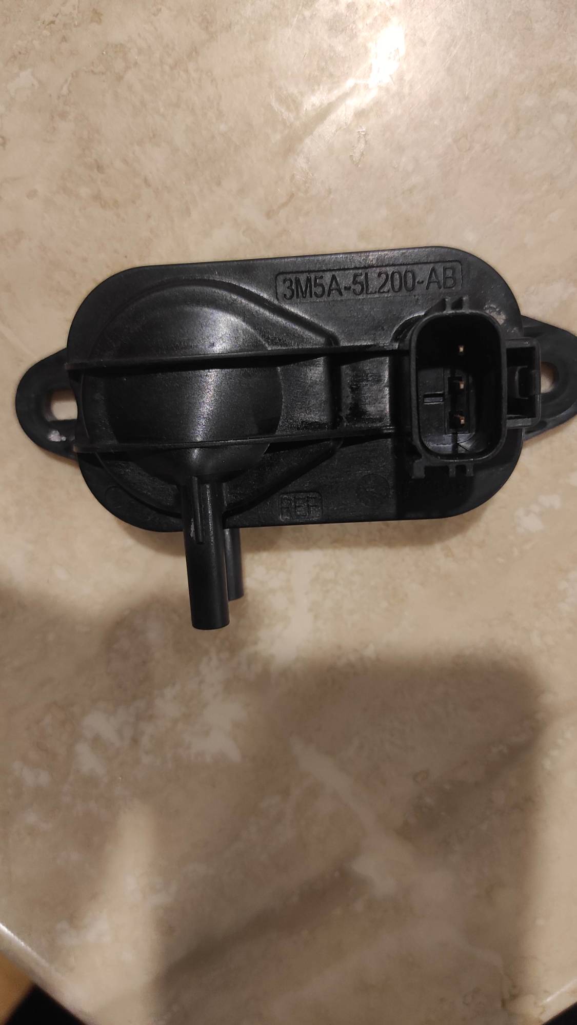

The DPF sensor reading quickly shot back up to over 65000 which suggests to me it's time for a new sensor. Car has remained in limp mode. Even after a code reset it still believes the DPF is full of soot and blocked which I doubt because after the burn-off it obtained some of the best fuel consumption figures I'd ever seen from the car; as low as 6.5l/100kms or about 36mpg.
The Ford DPF sensor can be found as a non-genuine part so ordered one; hopefully arriving Monday and will update this thread.
