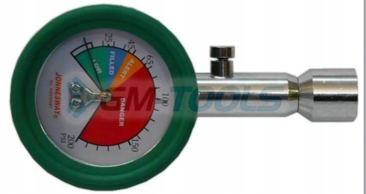

I checked one more thing yesterday. I connected a gauge to the air conditioning service port, but the compressor was off, and the reading was at 120 PSI.

For ac pressure check you will need ac professional gauges...regular gauge will not work for this.
And...pressure is always checked when compressor is running.

I actually have a Jonnesway gauge set. But you're absolutely right—the result here can be misleading.misha wrote: 09 Sep 2024, 14:20 For ac pressure check you will need ac professional gauges...regular gauge will not work for this.

Is there still 120 psi pressure in the system?
