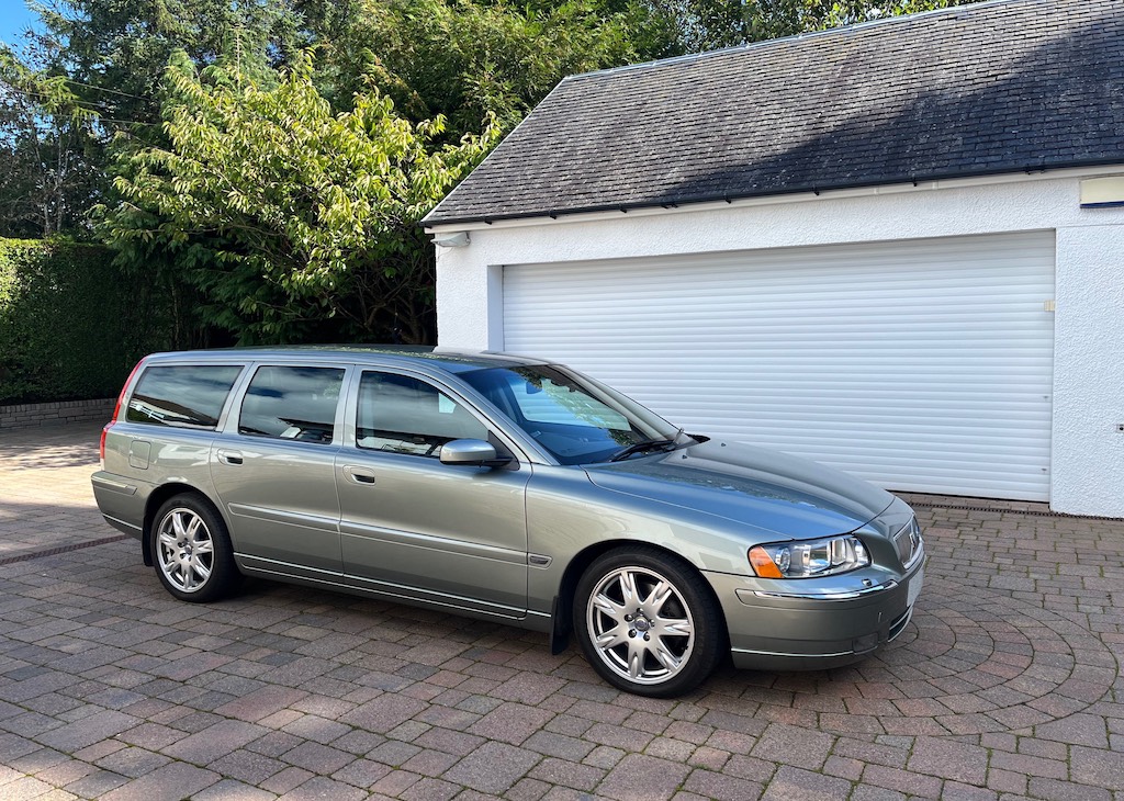

It's been 5+ weeks since I was last out in Kära so today I visited a mate and then went for a drive to blow away the cobwebs. In a couple of weeks time she will be 19 years old and I have to say for an 'old burd' she can still put a smile on my face when the loud pedal is pressed, that 5 cylinder turbo engine is addictive.
I downloaded a GPS speedometer app to my phone to see how accurate the speedometer was and it seems to be 2mph slow at 50mph and around 3mph slow at 70mph and 'presumably' a little more inaccurate when 3 figures are achieved ;) which is all good to know with all the cameras that are watching our every move nowadays...
Once home I vacuumed the interior and she was put back into her bed
