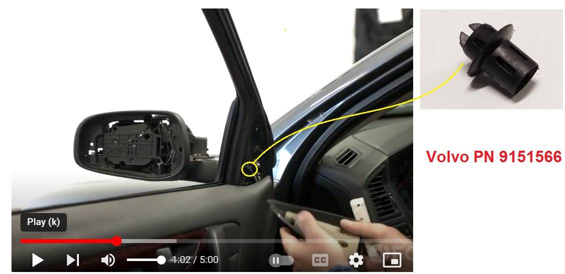

Iirc, the tiny metal tubes have prongs on the other side.
It is a press-fit kind of thing.
Just get a pair of pliers and pull it out.
Once you go to junk yard, then it will be obvious.

PN is included: 9151566, about $4-$5 at dealer.

Thank you! This is just what I needed!
