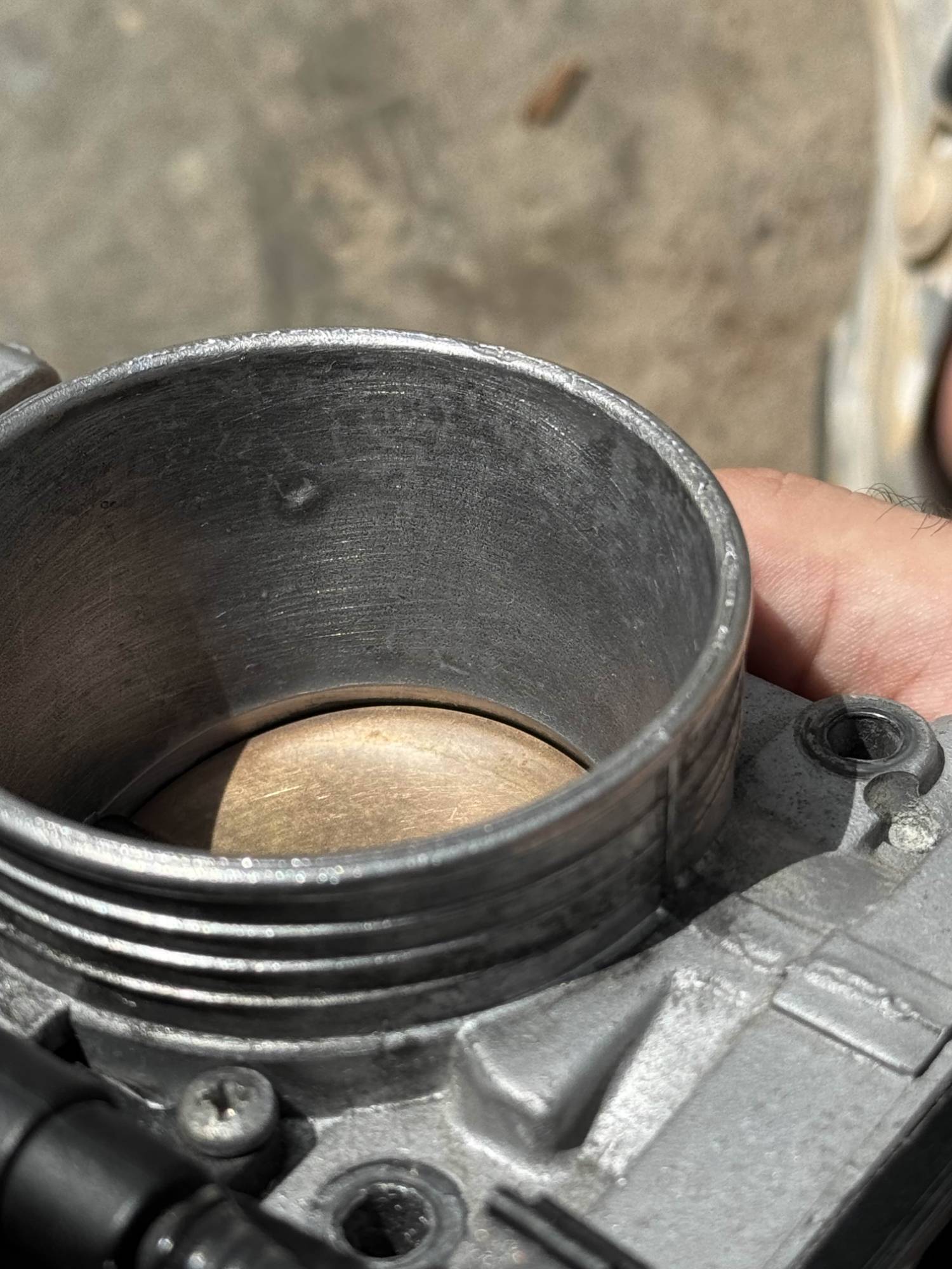

ETM cleaning will begin today with the one currently uninstalled (one that was removed before I tried my alternate)

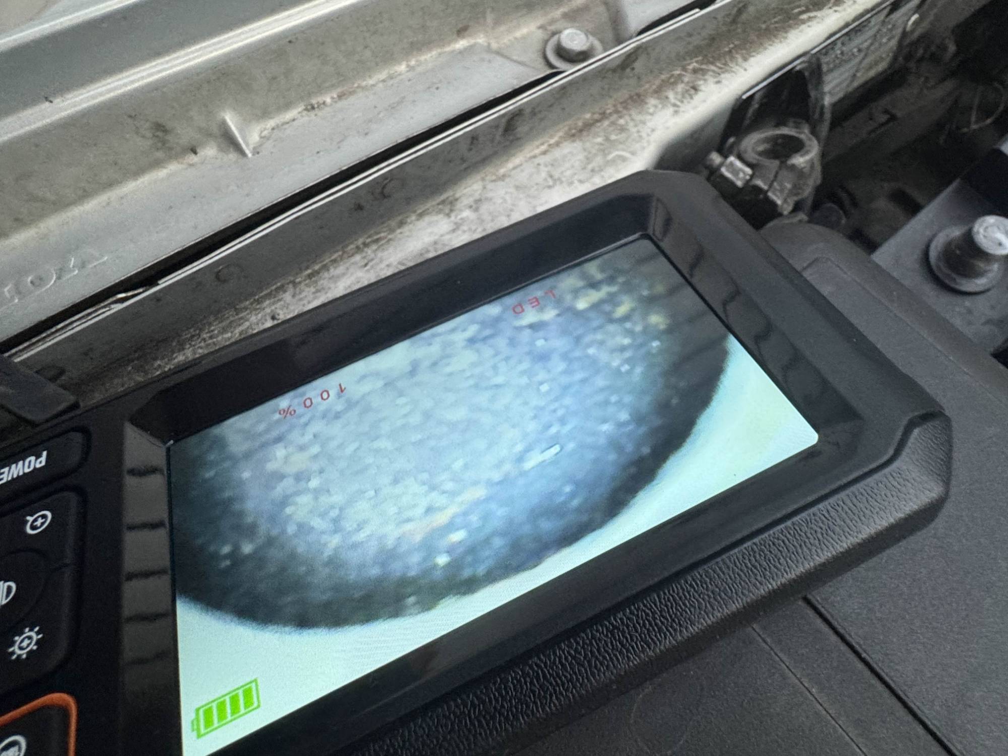

-The error codes are current, but It also additional ones before i did a full reset and reading. They no longer show. Supporting photo was taken when the car was not connected to the laptop.
-Perhaps the car needs to run for longer for them to be triggered. (image below)

I am not 100% sure if i have a cable or electronic operated throttle body. I believe it is electronic, but I cannot confirm yet.
I have attached a few images.

You have an electronic throttle module (ETM). Volvo started fitting there in 1999 Model year.

Spare throttle body:
I tried my best, but I cant help but OCD over how poor the result looks. I understand its likely normal for an old used part, but I'm really not satisfied with how the result looks. I probably spent a good 5-6 hours cleaning this over and over with a flathead surrounded by Q-Tips and a multi layered cloth soaked in Throttle Kleen, followed by another round with just Q-Tips and the rag, just a rag, a tooth brush, and a slightly harder plastic brush. By the end I could not handle the fumes and threw in the towel.

Throttle body looks nice and clean
Its also a Xmodex rebuilt version, which Is good news

Another (good) surprise.
Following are photos of spark plugs and some endoscope photos of the cylinder area.
ELECTRONIC COMPRESSION RESULTS:
Cylinder 1: 160 (8 revs)
Cylinder 2: 171.4 (9 revs)
Cylinder 3: 176.2 (8 revs)
Cylinder 4: 181 (8 revs)
Cylinder 5: 179.9 (8 revs)
It would appear we have pressure. High, but existant. I have no idea what the previous mechanics (mechanic 2) did. I will follow this post up with a screenshot of a text that mechanic 1 claimed he did as part of his diagnostics (as mechanic 2 only checked pressure, and did so incorrectly, so I don't trust him as much anymore)
All spark plugs have massive carbon buildup.
some seats of some of the spark plugs are dirtier than others.
One of the cylinder area seems suspiciously clean ( I believe cylinder 3), 5th cylinder looks it has a very dark buildup above the valve, and the 4th appears to have pitting occuring. (labeled as endo cyl 3e, but is actually 4th cylinder photo)
A friend has suggested that I take better photos of the walls and base again in the morning as it was getting dark. I will do that in a few hours when there is light.
