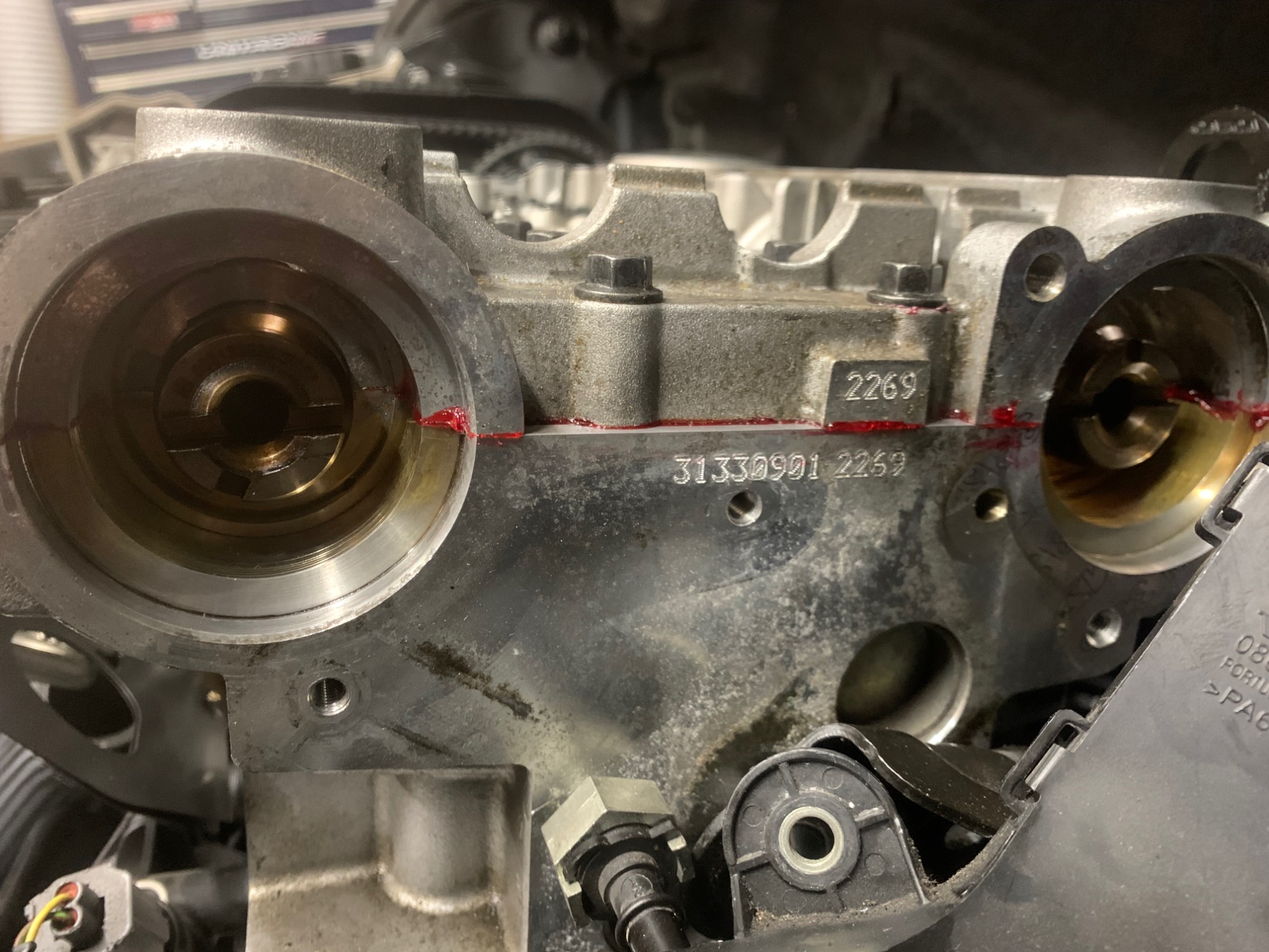

Post by Jraptor2000 »
This is current with crank at lock. Is this the correct orientation? I do have the locking tools but they aren’t of highest quality and seems they fit either way.
Engine is B5254T12 from 2016 Xc60.
