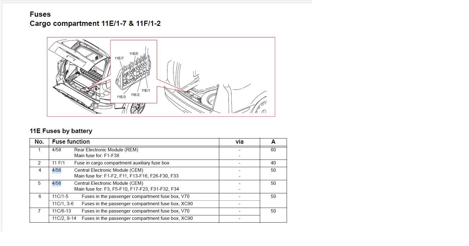

firstv70volvo
Posts: 575
Joined: 06 Mar 2010, 08:37
Year and Model: V70 T5 2001
Location: Sacramento, CA
Has thanked: 52 times
Been thanked: 123 times
Post by firstv70volvo »
Faust wrote: 04 Oct 2024, 09:10 I have checked all of the connections I have found, no looseness or corrosion. I think it is important that the electricity did not reduce, it shut of like a light responding to a wall switch.
There are some heavy-duty fuses near the battery, 40-50 amp fuses, 11E/4 and 11E/5 supply the CEM, I'd check these fuses.
