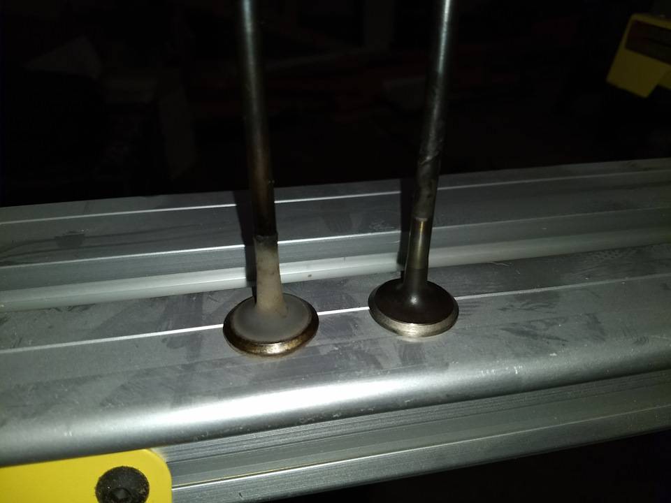

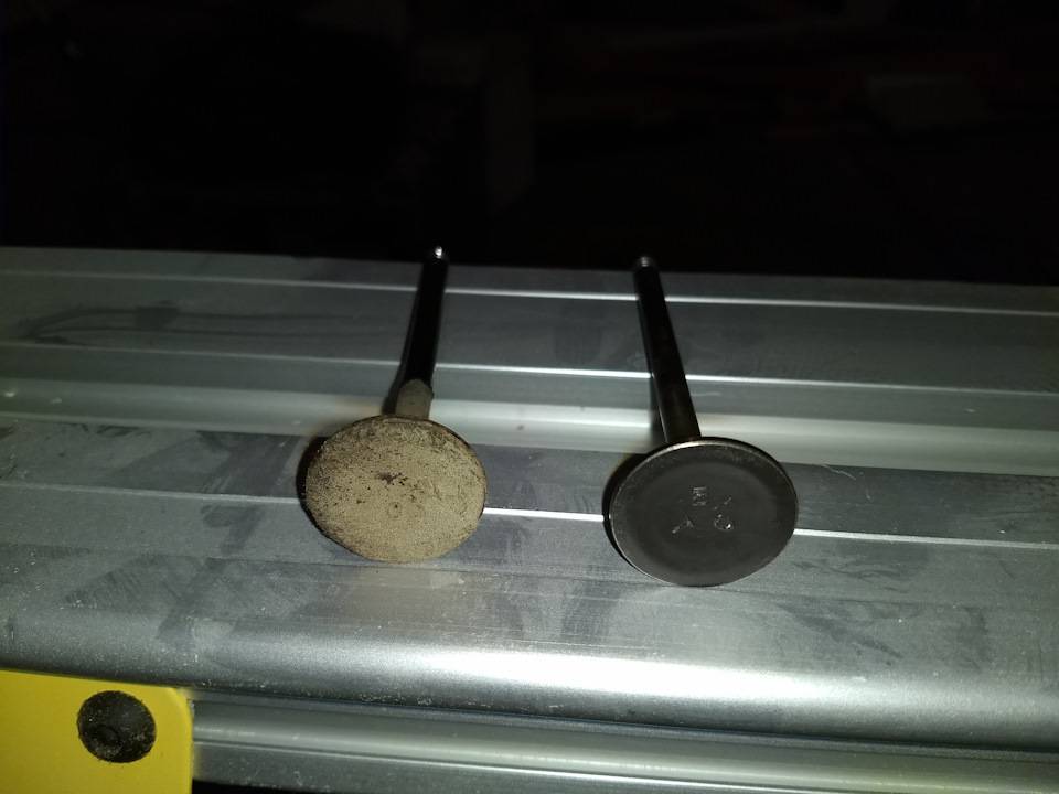

Took the valves out of the head of a 2004 xc70 2.5t this afternoon so I could install new valve stem seals. Lapping the valves seems easy enough - I tried with one, but I didn't keep track of them when removed so there's a 1/10 chance that each valve goes back into it's original spot. Bad idea to lap them randomly?
Should I bother cleaning the valves? Intake side seems mostly covered with a light varnish. Exhaust side has more of a carbon fur. Pictures below.

A combination of boiling Simple Green and Muriatic acid (can of Simple Green, can of acid) did a trick for me to get rid of heavy limestone deposits. Don't soak the valve deeper then needed. You'll see a clean separation on the valve. It is made of two metal alloys in fact. The one that slides in valve guides should not be scraped, dinged or submerged in acid.
Use Permatex 81950 Ultra Slick Engine Assembly Lube to keep the keepers in place.
Make sure valve guides are absolutely, bone dry before installing new seals. Clean with acetone them good. Don't use any kind of glue. Otherwise the new seals will pop off in no matter of time. Exhaust side is Volvo original seals only. Intake you may have luck with Elring.

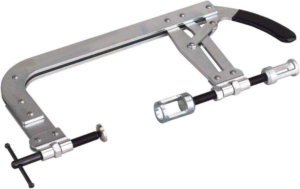

Also OTC 4572 Large Valve Spring Compressor was priceless for me.

The combination of basic products seems to clean the valves really well. I would focus on the valve seat as those valves aren't extremely dirty. Proper seating of the valves is needed for compression.

@vtl I agree with you about the valve spring compressor. I bought a similar tool on amazon - indispensable!
